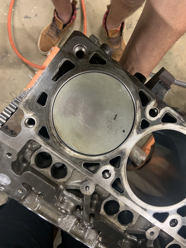

Here is a question going through my head, has anyone looked at works best on this engine to increase compression ratio? By modern standards 9.8:1 that is stock on this engine is pretty low.
Can you deck the heads? if so how much before you need new pistons with reliefs?
Is there a domed piston that would work on this engine?
are there thinner gaskets?
This engine is designed for 87 octane, but running premium 93 pump gas in my area, 91 for some or E85 gives a lot of room for a high CR and avoiding det.
zkhennings
JUN 15, 10:28 AM
Aftermarket LS1 pistons can be found in varying compression heights, and with various dishes and domes, they are the same OD as the stock pistons. An aftermarket LS1 rod or SBC rod can be found to work with this setup in varying lengths, but the crank will need to have the rod journals resized as they are slightly smaller in the LS and slightly smaller than that in the SBC. This does give you the opportunity to slightly stroke or destroke the motor if you offset how the journal is resized. It will take some research to find the correct combination that you are looking for. Seems as though the aftermarket rods and pistons will use a 0.927" floating wrist pin setup which is slightly smaller than stock. You would most likely need to cut valve reliefs in the pistons, take that into account when calculating dish/dome. I have an SBC rod and LS1 rod I bought for checking this all out, I will measure the width of the big end of the rods when I get to the garage later to confirm that they need no modification in width to work with the LZ9 crank.
Here is a stock LS1 piston in the LZ9 for fitment, no dome nor dish.
