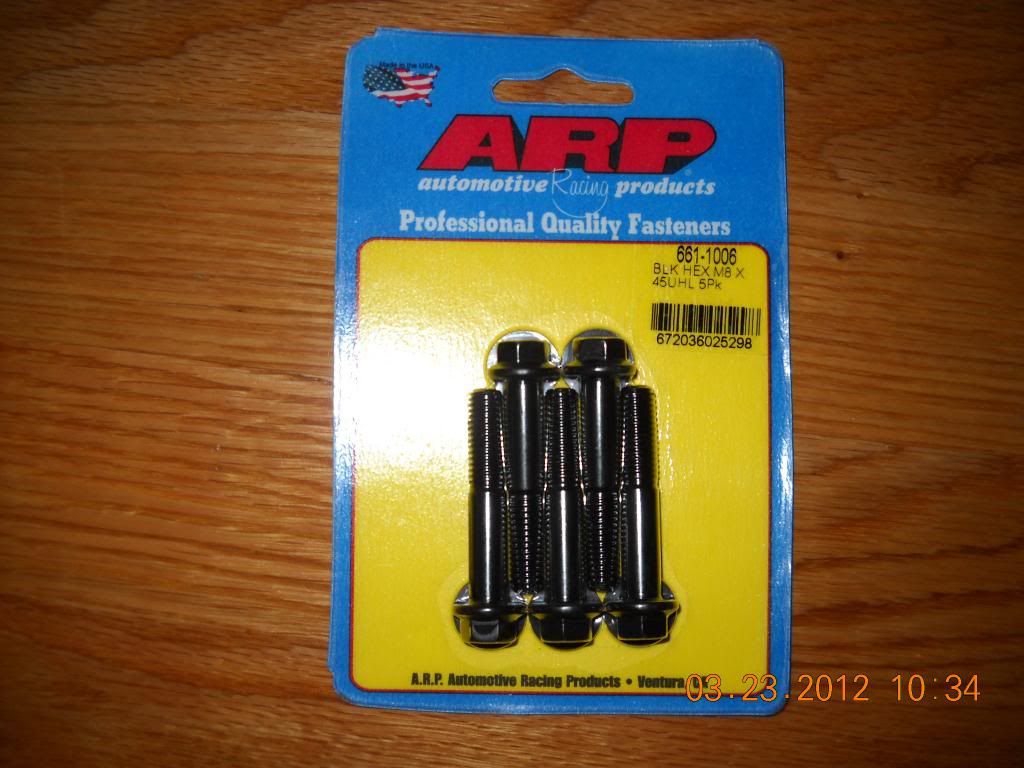

I did some searching on what type bolts other people used and how the torqued them. On bubbajoes build thread there was a interesting discussion on this subject. What was used there were 12.9 M8 Cap head bolt. I was looking for a hex head bolt because clearance is not a issue. The only place that I could find class 12.9 or greater bolts was Automotive Racing Products, ARP. They are chromoly and have a tinsile strength of 180,000 PSI. The size is M8 x 45mm 1.25 pitch. I'm going to torque them to the spec that are for the Northstar flexplate plus a little more. That spec is 11 lb-ft + 50 degrees. Here are the new bolts @ $3 each.

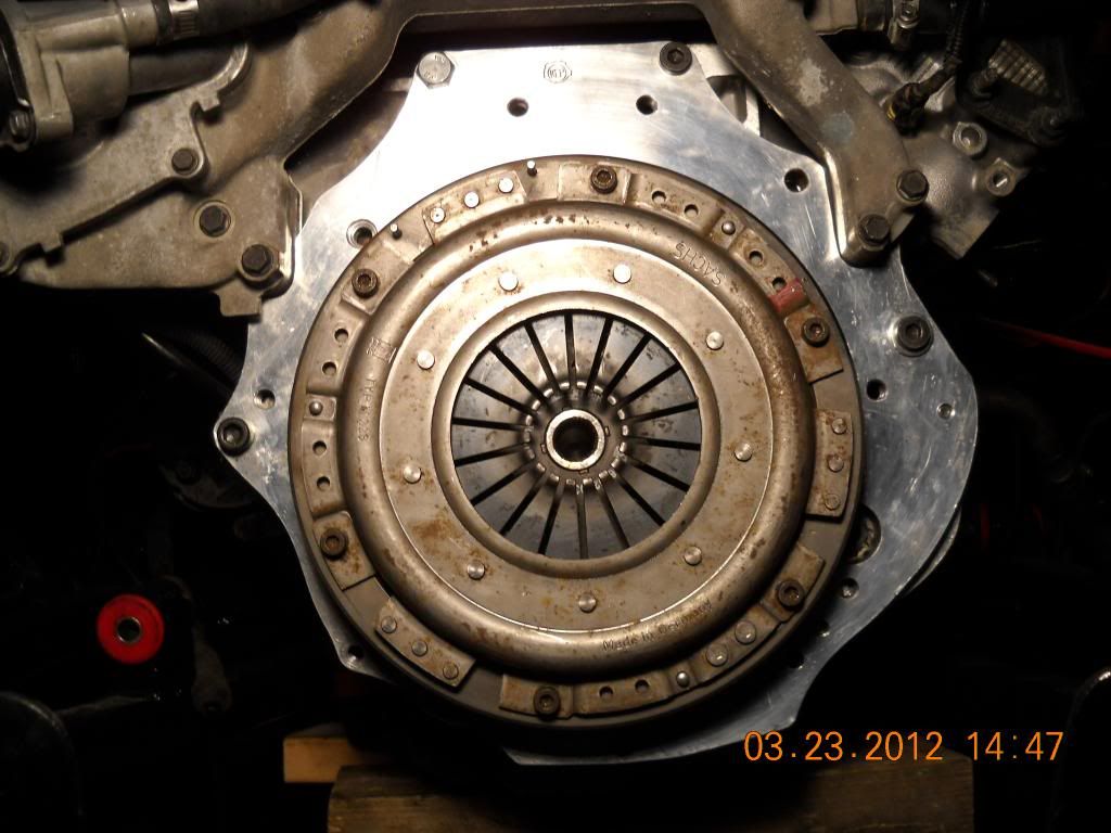

I got the flywheel, clutch, and pressure plate installed and torqued down. Next I will be wrestling the transmission back in. Next time if I have to take out the tranny I think I will make a bracket to hold the engine in the car and drop the cradle and the tranny at the same time. here's a pic of the clutch installed.

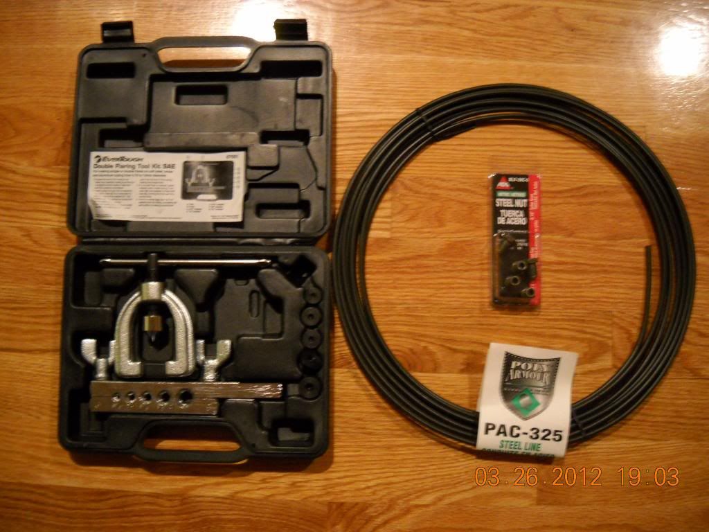

I got the parts to fixup the rear brakes. I leaving the rear distribution block in its stock location and making two new hard lines to each side. The rubber hoses will also be mounted in the stock location. Here are the goods.

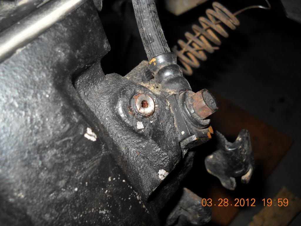

I hit another snag, I got the new brake lines partially installed and figured I would try to loosen the bleaders while I had the calipers off the car. I soaked them for 2 days with PB Blaster then used a 6 point socket and gave it a few taps with a hammer and this what happened !
Looks like I will be drilling it out and hopfully without screwing up the threads.

| quote | Originally posted by Nebraska:
Looks like I will be drilling it out and hopfully without screwing up the threads. |
Don't drill it if you have a welder. Turn the welder up and place a good weld bead on the top of the screw, then slide a 3/8" nut over it and fill it with weld. The welded nut gives you something to turn, plus all the heat from the welding process breaks loose the rusted bond.
