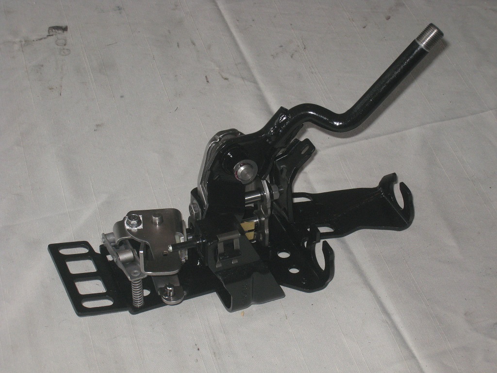

 And a shifter assembly. Before cleanup:
 After cleanup:
          |   | Spadesluck | JAN 03,  11:08 AM |  |
          | I did that very same thing to my shifter. It looked terrible before rebuilding and painting it. |  |
          |   | pmbrunelle | JAN 03,  11:16 AM |  |
          | The reverse interlock roller was actually seized. I worked it free, but I don't think it made a difference that could be felt by the driver.
 Having the shifter cleaned up, it's like driving a freshly washed car with shiny paint. Even though it makes no functional difference, it's still more fun to drive. It's psychological.

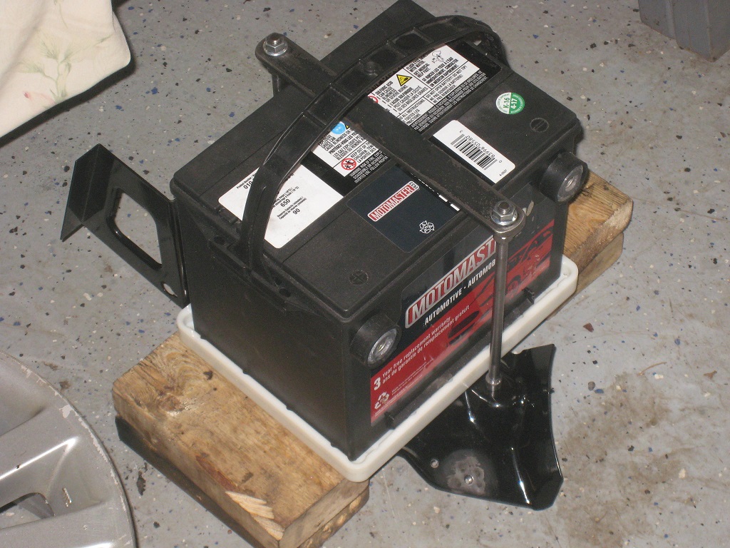

          | Since the battery tray was falling apart, I decided to replace it with a new Fiero Store unit.
 However, the root of (I think) the battery tray rust problem, common to many Fieros, is that the battery acid overflows and leaks onto the metal below.
 Therefore, I decided to make a polypropylene battery tray. It is designed to channel any liquids to a drain fitting, on which a drain line can be installed to direct any liquids to the ground.
 I also didn't like factory method of gripping the battery by the two lips at the bottom. I don't find the factory method secure enough, especially when the rust bug bites.
 So, I decided to hold down the battery more positively, with a flatbar over the top and rods keeping the flatbar in its place.
