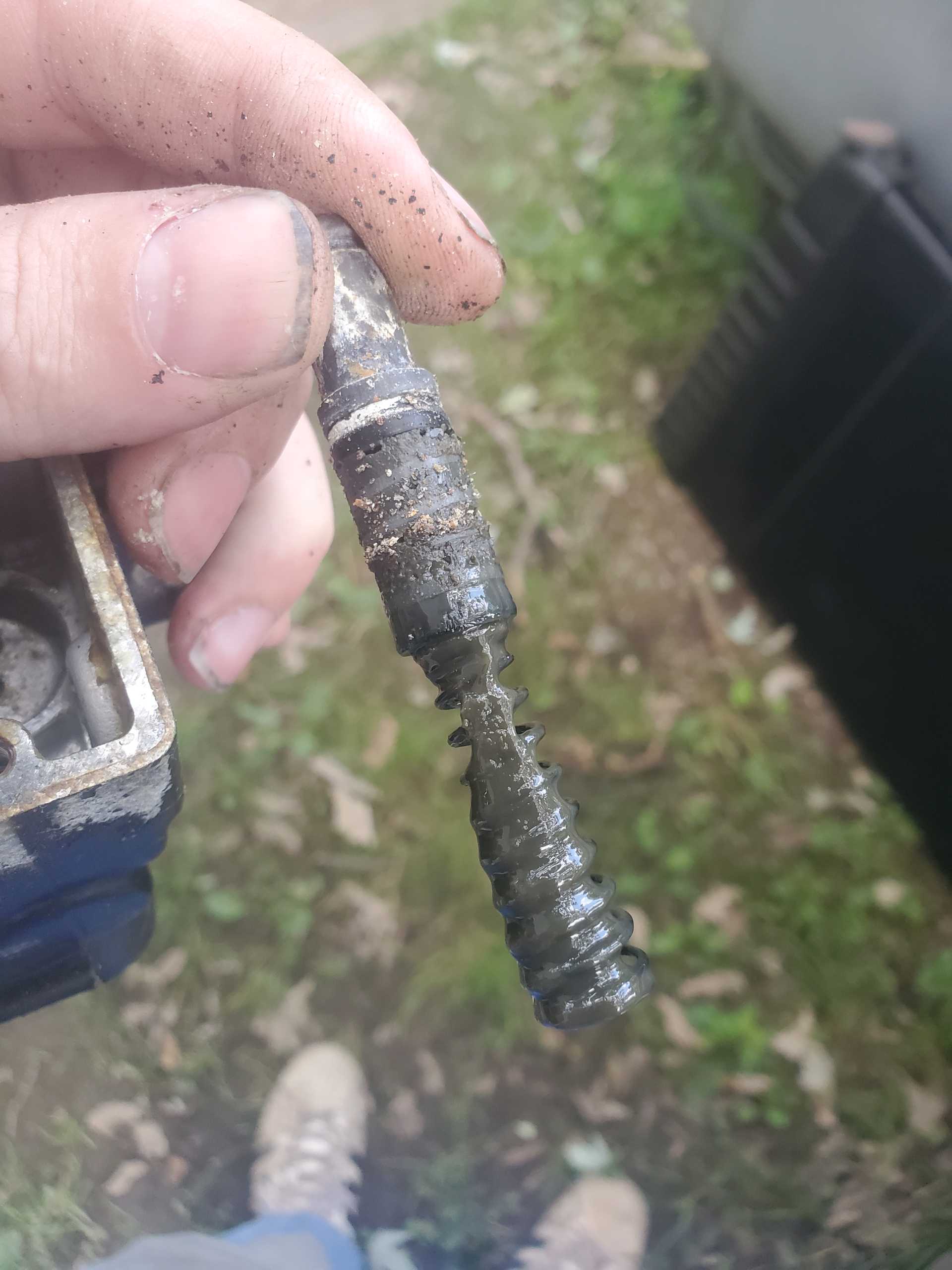

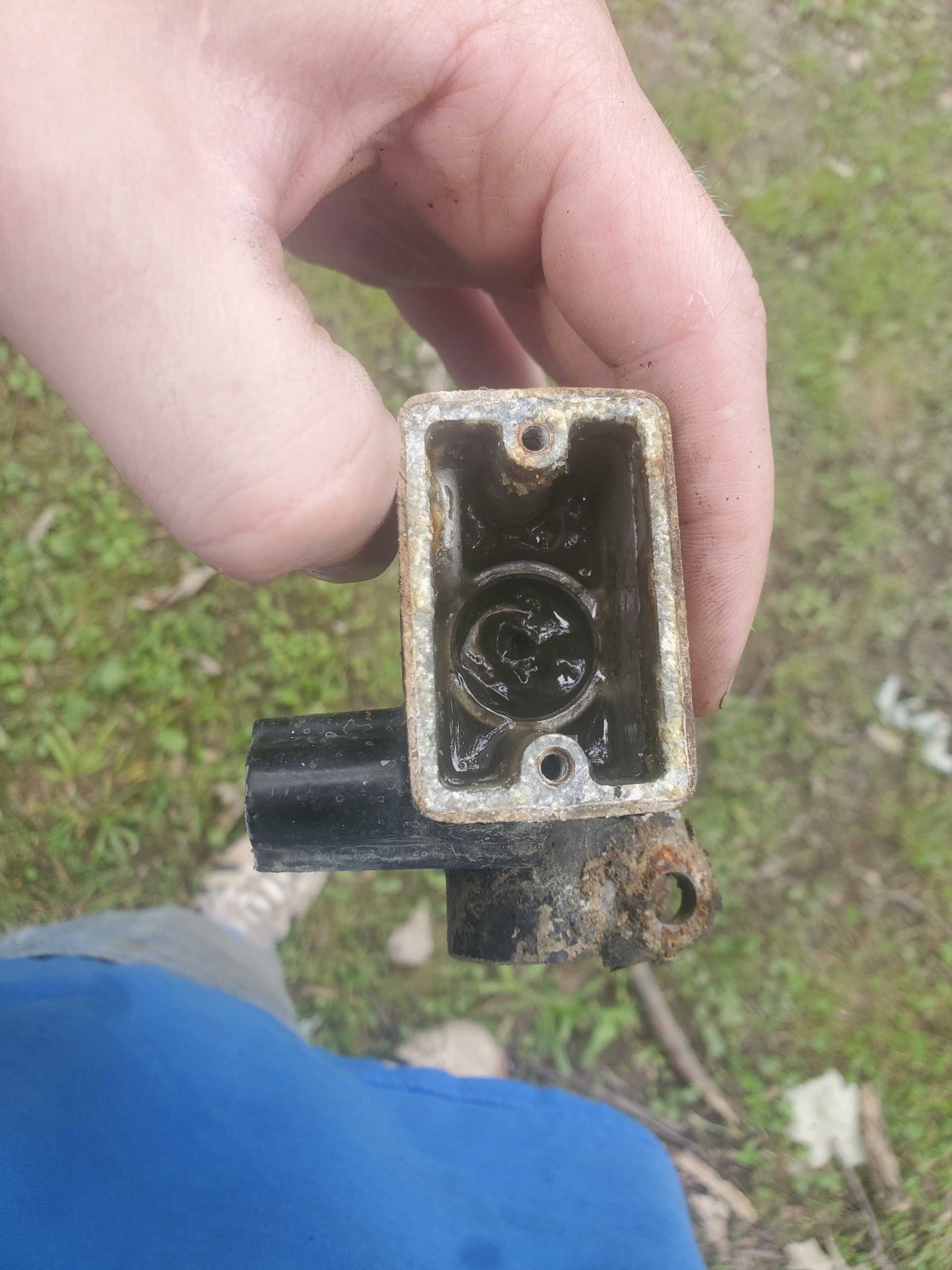

Everybody told me "they work, leave them alone." But that is the wrong attitude. Take care of stuff before it becomes a problem.
This is the front brake master cylinder on my 85 ATC350X. Rebuild kit was $15. Cleaned it up and put it back together with the new parts, should be good for another 30 years with occasional fluid changes.

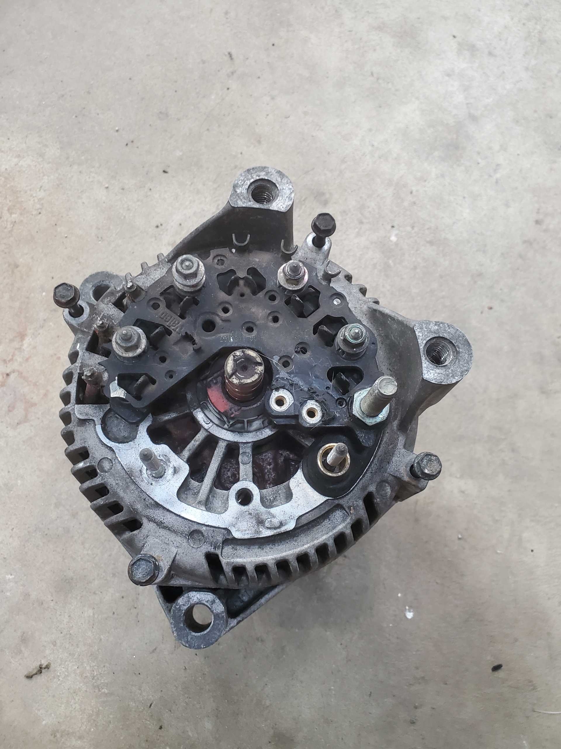

I get bad at taking pictures. The after picture of the piston would of shown how bad it was. Also did some work on the Corvette. Remeber just because the parts are new, does not mean they are good. When I got it running again spring of '20, the alternator was had a bad bearing making a bunch of noise. I bought a new AC Delco from Rockauto and quieted it down, but it would always give me a charging fault on the message center even though it was charging fine. I finally looked into it, and it is common issue on them with replacement alternators. Something different with the factory voltage regulators. Well I kept the original alternator, so I swapped the voltage regulator over. Sure enough, problem fixed.
 Only picture I took was the old alternator with the voltage regulator removed.

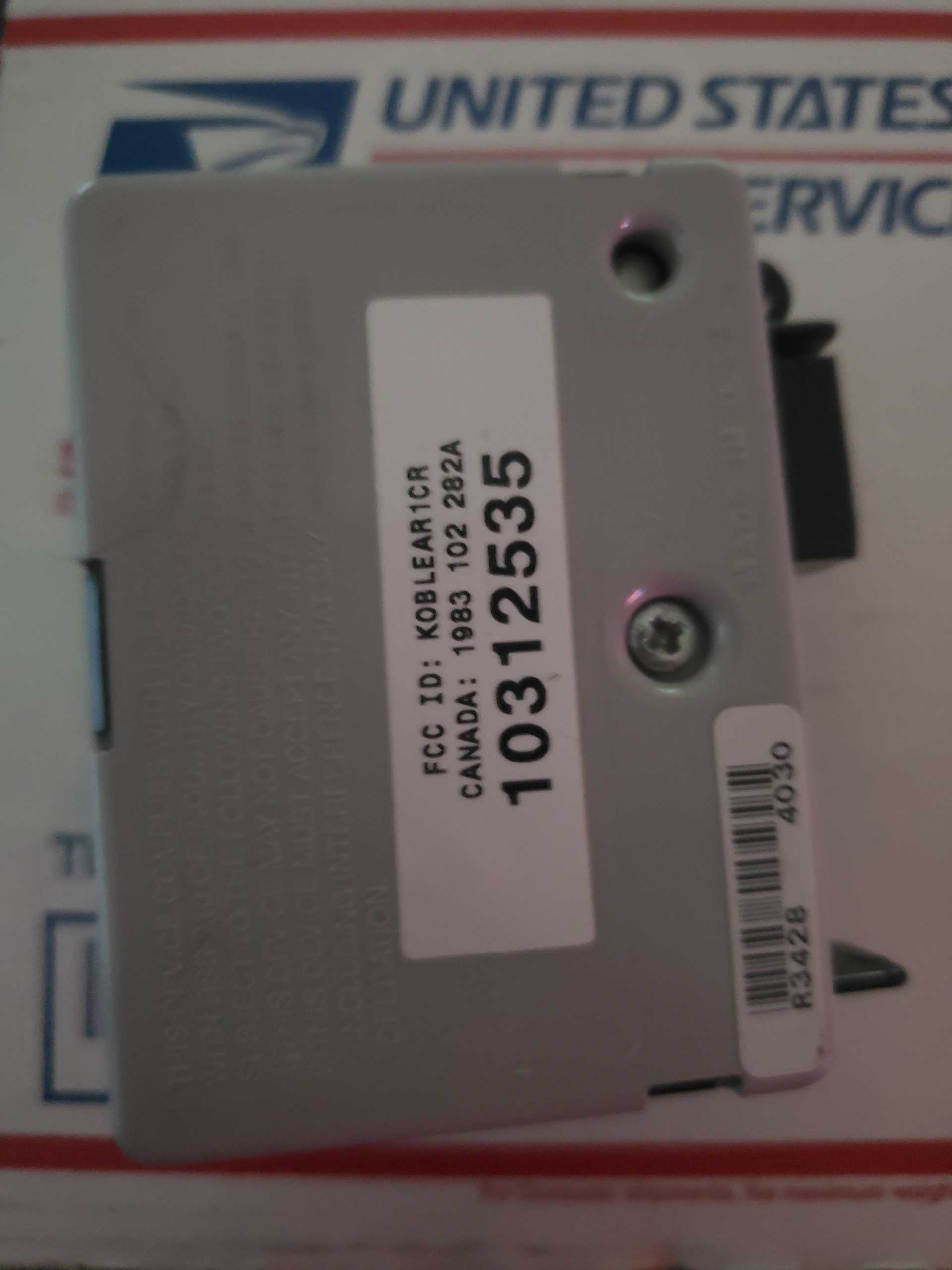

Another problem caused 3 warning messages to keep popping up on the message center of the Vette. The tire pressure monitoring sysyem receiver had stopped working. These cars came stock with run flats, so rhey put the tpms in them so you new when they were flat. I do not have run flats on it, but wanted the system fuctioning to get rid of the messages.
I "upgraded" to a newer system in 2016 with all new oem parts. I do not remember when it stopped working, but finally wanted to get it sorted. Too bad the reciever is now discontinued. I was able to get a used one from the Corvette forums. It was a OE from an 03. Got it installed and it works, we will see if it lasts.

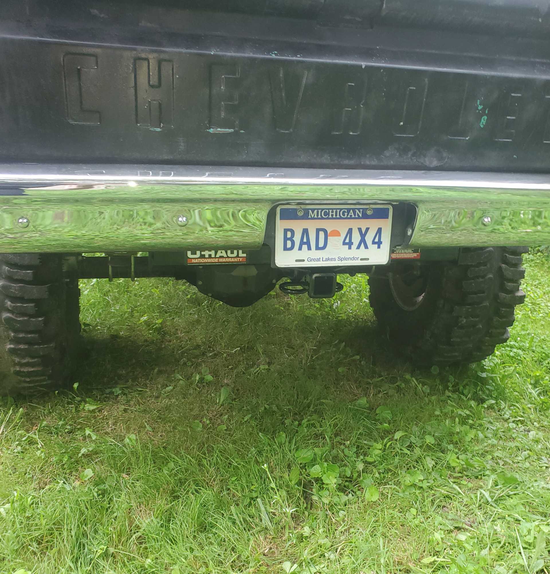

Also installed a tow hitch on the Blazer.

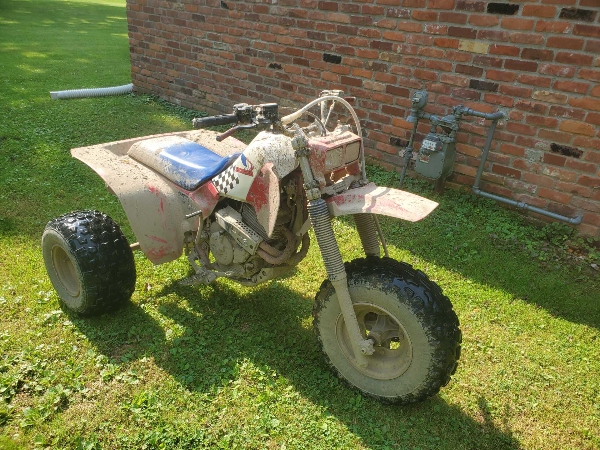

July 3rd I rook the 350x to an offroad park called Bundy Hill. Here is how the bike looked before its bath the next day
