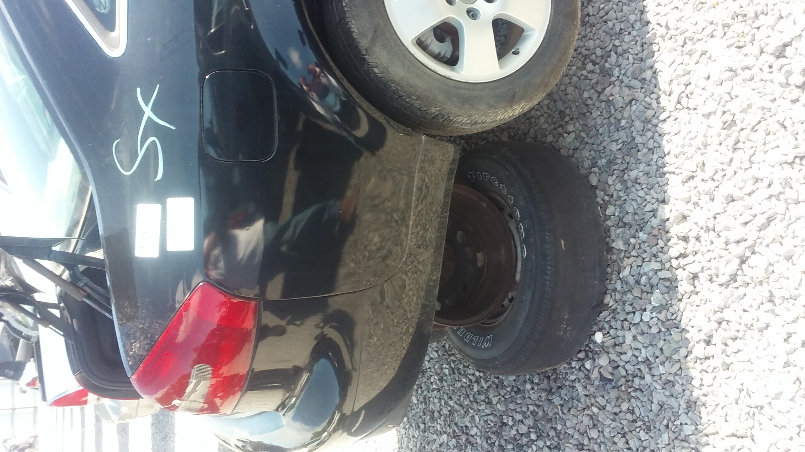

Forgot to post pics of the donor before cutting.
The trunk having that strong curve is going to leak profusely unless it's done right so that required a replacement panel. One tail light area was mangled badly too...more leaking. Thus the replacement panel. The other tail light panel isn't too bad so maybe it can be preserved. The donor provided a trunk kid and rear license panel too. Trunk lid was $40, rear license plate insert was similar in price. A used battery was $30. A replacement active rear view mirror was about $12.
