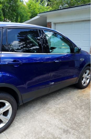

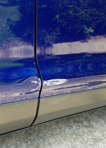

I got too close to a post under my carport, and scuffed the side of our blue Escape with white paint from the post. I tried to clean it up with rubbing compound, but that accomplished nothing. These pics are how it looks right now. The close-up reflection is of grass & shrubs next to the driveway. What else can I do that doesn't cost a ton of money? We intend to trade it in, because we found out it's full of rust underneath. Which must be why we got a good deal on it to begin with. I know, I should have checked it out, but we needed something in a hurry after someone ran a red light and totalled my wife's Civic.

Bug begone may loosen the paint and leave the paint on the car alone.

Thanks for the idea. I had some Gunk Bug & Tar Remover, so I tried that. But it didn't work.

Drop by a detailer or paint shop, they can use a power buffer with a slight abrasive, then wax the area to clean up.
Shouldn't take a lot of time / money. I've seen some use acetone to remove paint scuffs.

A cutting compound will do it in few mins don't use anything else don't scratch paint with paint plenty of videos how to do it.. [This message has been edited by Australian (edited 09-14-2020).]
