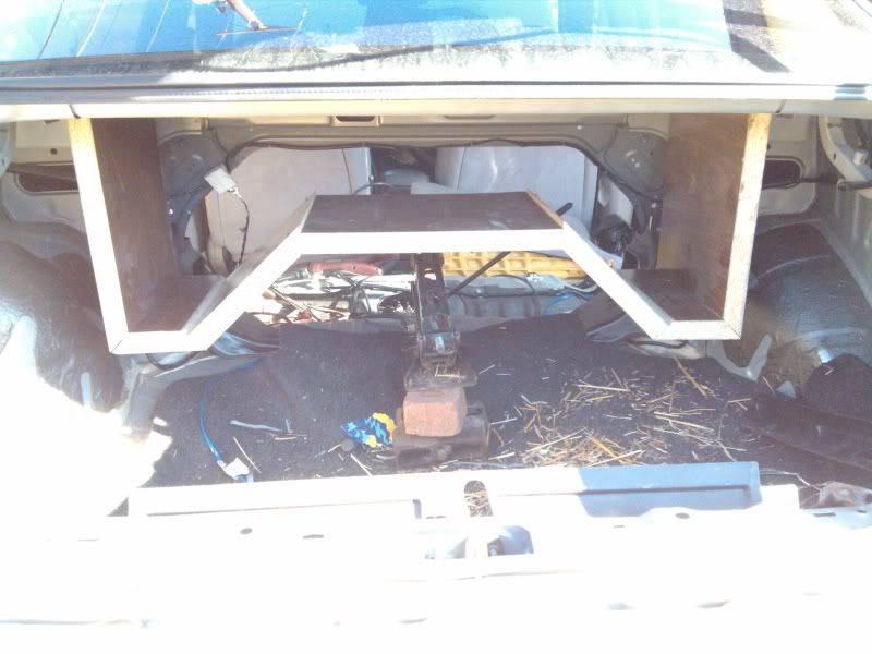

this is the mock up car, this is in no way the car im fixing, but its working out great for test fitting stuff.
thats the test fitting of the box, *IF* i change over to 3/4" MDF instead of this 1.25" particle board then ill gain some extra airspace inside the box, but im wondering if the particle board is stronger due to its thicker nature.
i had to remove the rear decklid hinges, im going to use some gas shocks i removed from another car to make gas struts for holding up the rear decklid.

3/4" MDF over 1 1/4" particle board every time. MDF is stronger. Look at any quality sub box and you'll see MDF, not particle board.

X2. We only carry Bassworks here at work. While we do make custom boxes on the side, its always 3/4in MDF. Better sound charactoristics and quality.

ok, new box is built using MDF, after accounting for .15 cubic foot for the size of the woofer, im at 1.28 cubic feet per subwoofer, thats after modifying the box.
heres the first test fit of the box into the "parts car"
as you can see i made the box too tall and couldnt get it to roll up into the decklid, needless to say i modified the bottom of the box, i cut 1.25" off one side of the side legs, and .50" off of the back side of it, i probably didnt need to, but i did anyway, the box isnt sealed up yet, its only screwed together.
here's the results of me modifying the box.
its not level, and its not complete yet, but it fits, i can already tell that im going to have to cut the final opening on the car to 38.5 inches wide, and 12.75" deep, the current opening is 38.125" wide and 12.50 inches deep and the box is super difficult to get into place.
