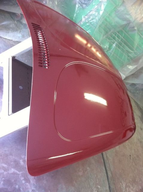

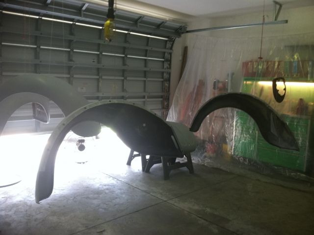

As promised I shot some paint today. I got three of the taillights, fenders and the hood done. I have a 2 car garage that I use as my paint booth. for the hood I had it sitting on some sawhorses and the fenders and taillights were hanging by some twine from the ceiling. As I was wiping them down with wax and grease remover, one of the fenders (not one I was wiping) fell because the twine broke. As it fell, the bottom of the fender bent and cracked the primer so I set that one aside and painted the other three.
I am off again thursday so I plan to fix that fender and finish sand the decklid so I can get those two pieces painted then Id like to finish sand the rest of the car. If I can get that all done next week I should be able to paint the rest of the car and be done painting.
Im really pleased with the way everything turned out. I didnt end up with any runs in the clear and everything sat pretty flat, it will get better when I wet sand the clear which should really make it shine. On to the pictures.
fenders prepped, hung and ready for paint

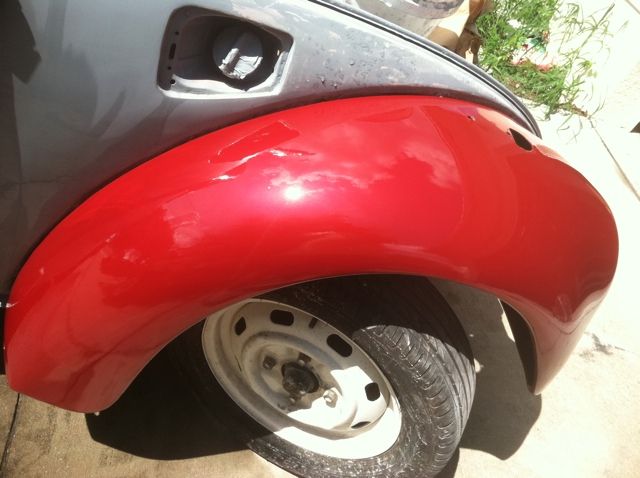

After dry, test fitted on the car and in the sun so I could see the metallic really shine.
The color is much nicer than I thought, it is darker in the shade but looks lighter with some light on it and it really sparkles in the sun. It has a bit of a pinkish tone to it but its not overpowering. Im really liking this color and it should look awesome when the whole car is done. Stay tuned for more
