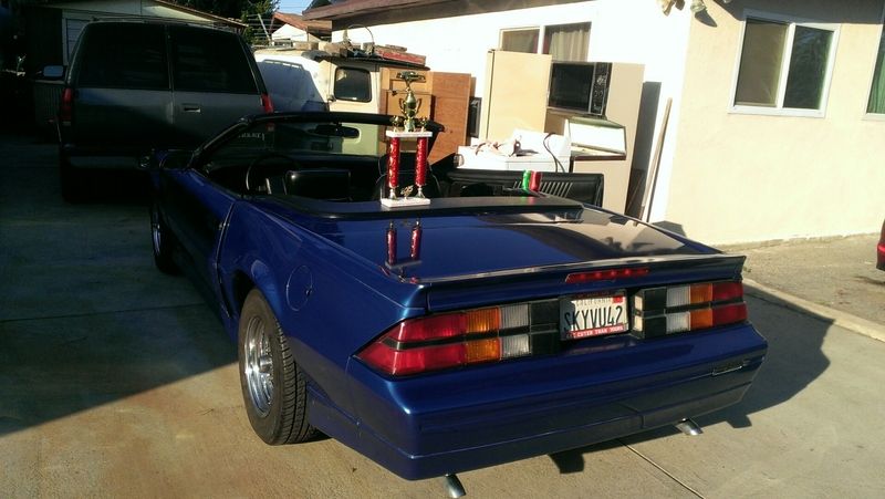

My Mom and Pop took her out to a show today and brought a trophy home with her .
With as much as they are doing with it right now and the number of pics they've been sending me about it, I'm pretty sure it's coming home with us in February. My Dads health has taken a turn for the worse and it looks like he'll be on a oxygen tank and getting chemo. His blood counts are down really low. Of course dialysis will be part of that regimen also. February can't get here fast enough for me. I really want to spend more time with my Dad.
