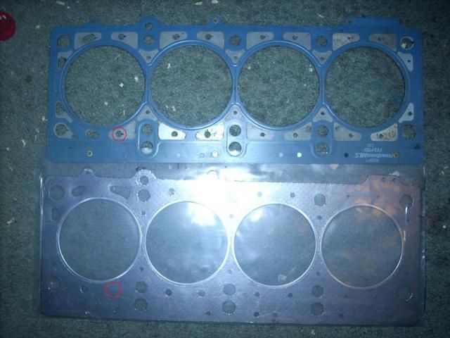

Comp headgasket arrived today. I have one question about it. I checked it next to the Felpro MLS gasket and noticed the Comp gasket is missing a coolant passage hole.
Should I get out my calipers and measure the hole and pop one through the comp gasket in that spot? I'd hate to have a hotspot on that cyclinder because coolant flow was blocked off. Other then that one hole all the other holes line up and there aren't any in the MLS gasket that aren't in the comp gasket.[This message has been edited by Khw (edited 08-30-2012).]

Should I put a hole were the headgasket doesn't have one but the other does?

I don't think there'll be a prob adding the hole. Just overlay the gaskets and mark it. Make the hole a little smaller than the one that's precut. Just to make. Sure there is ample sealing area.

Thanks! I'll be sure to do that tomorrow before I reassemble it then . The new head bolts showed up today so I pulled it back apart and checked the flatness again. I wish I had a granite table I could use to inspect it with my dial indicator, like the one I used for inspecting parts when I worked at the machine shop back in Cali. Ah well, hopefully this time it works out.
