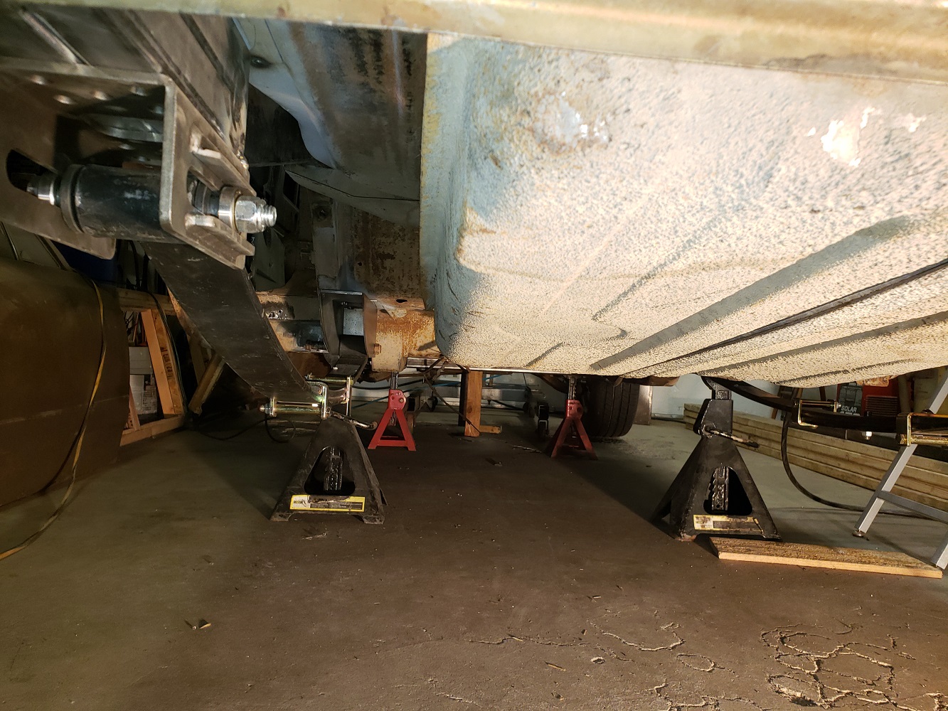

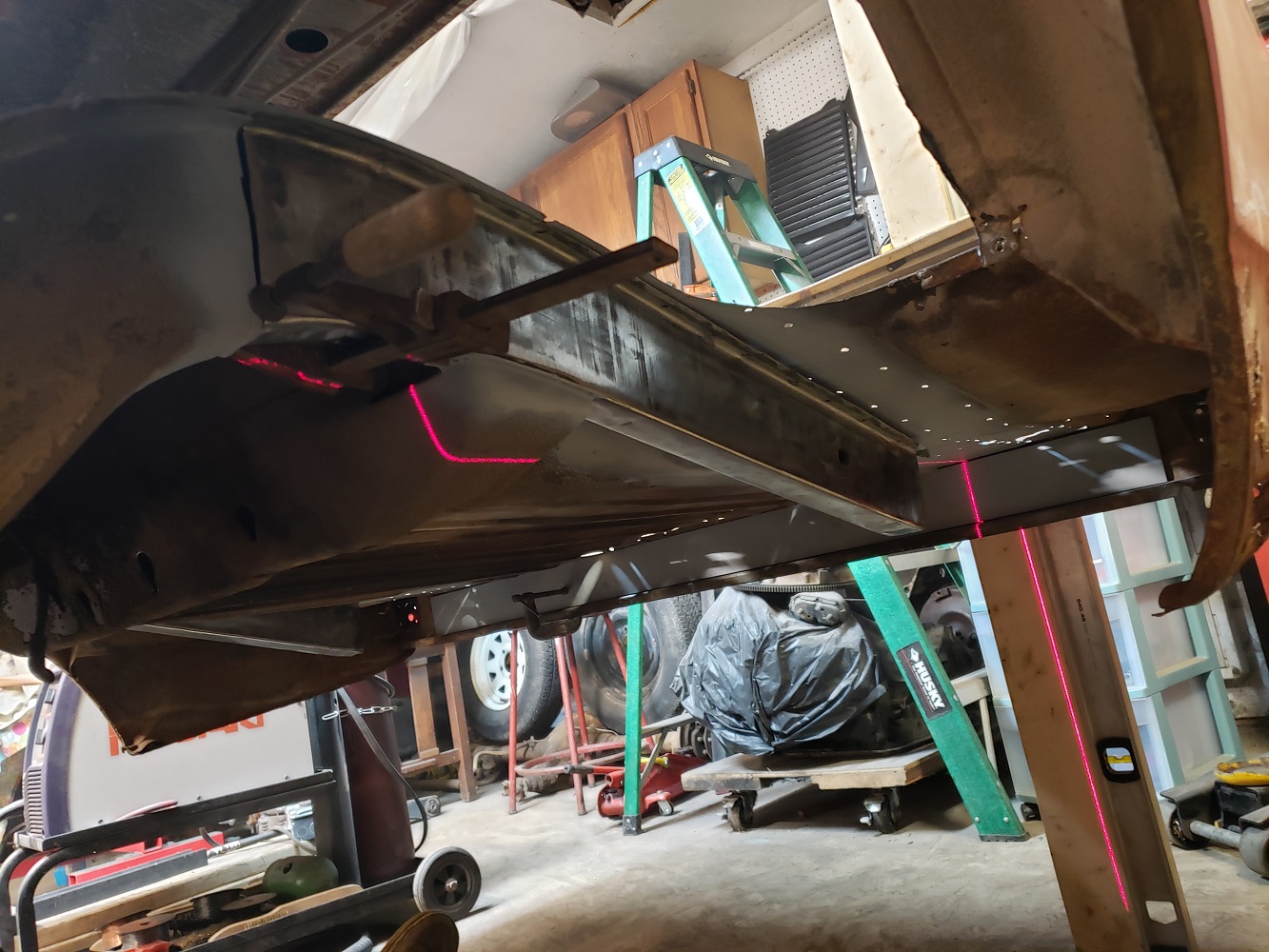

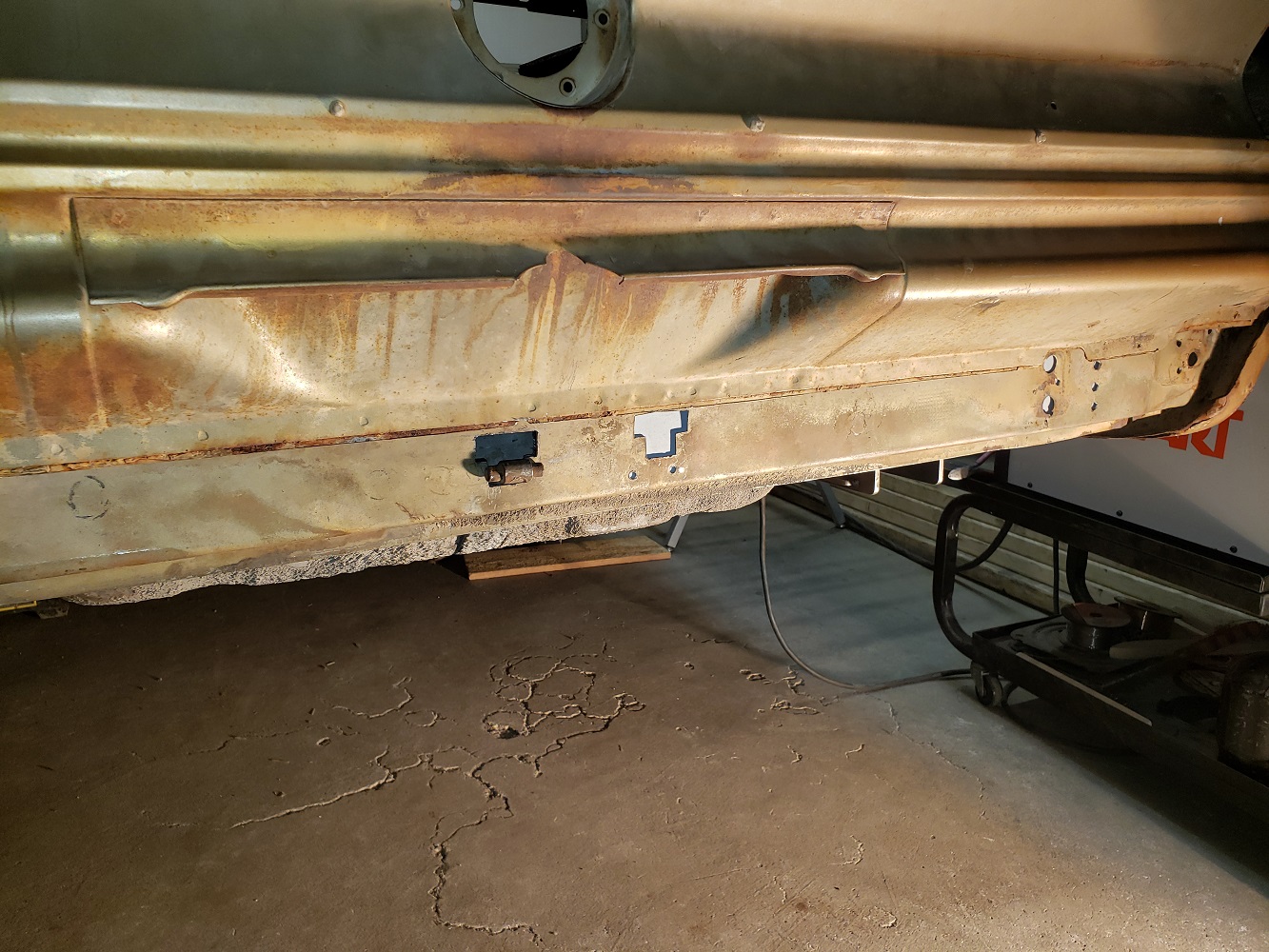

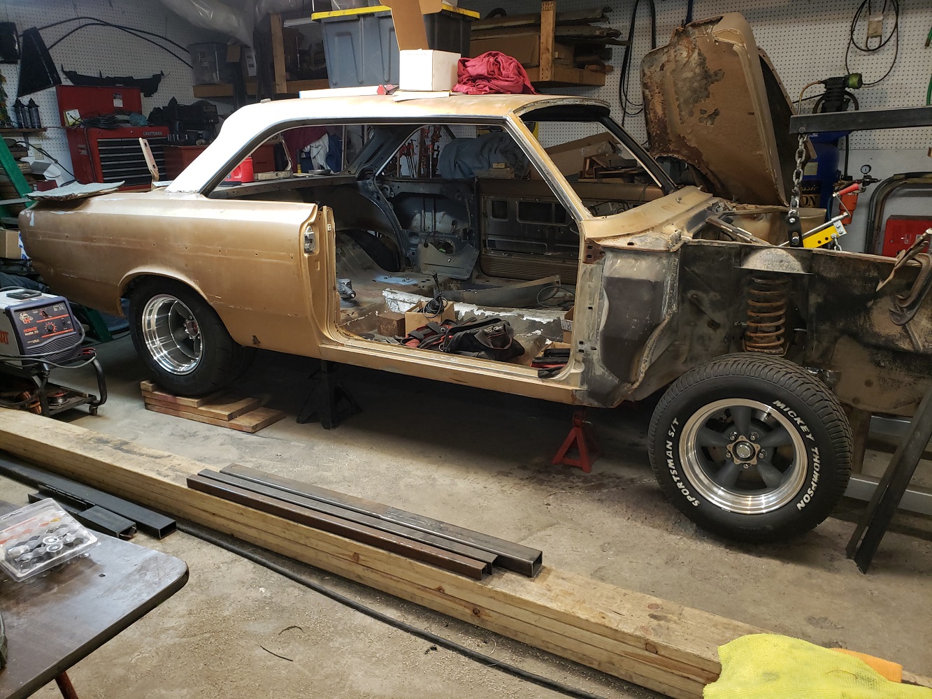

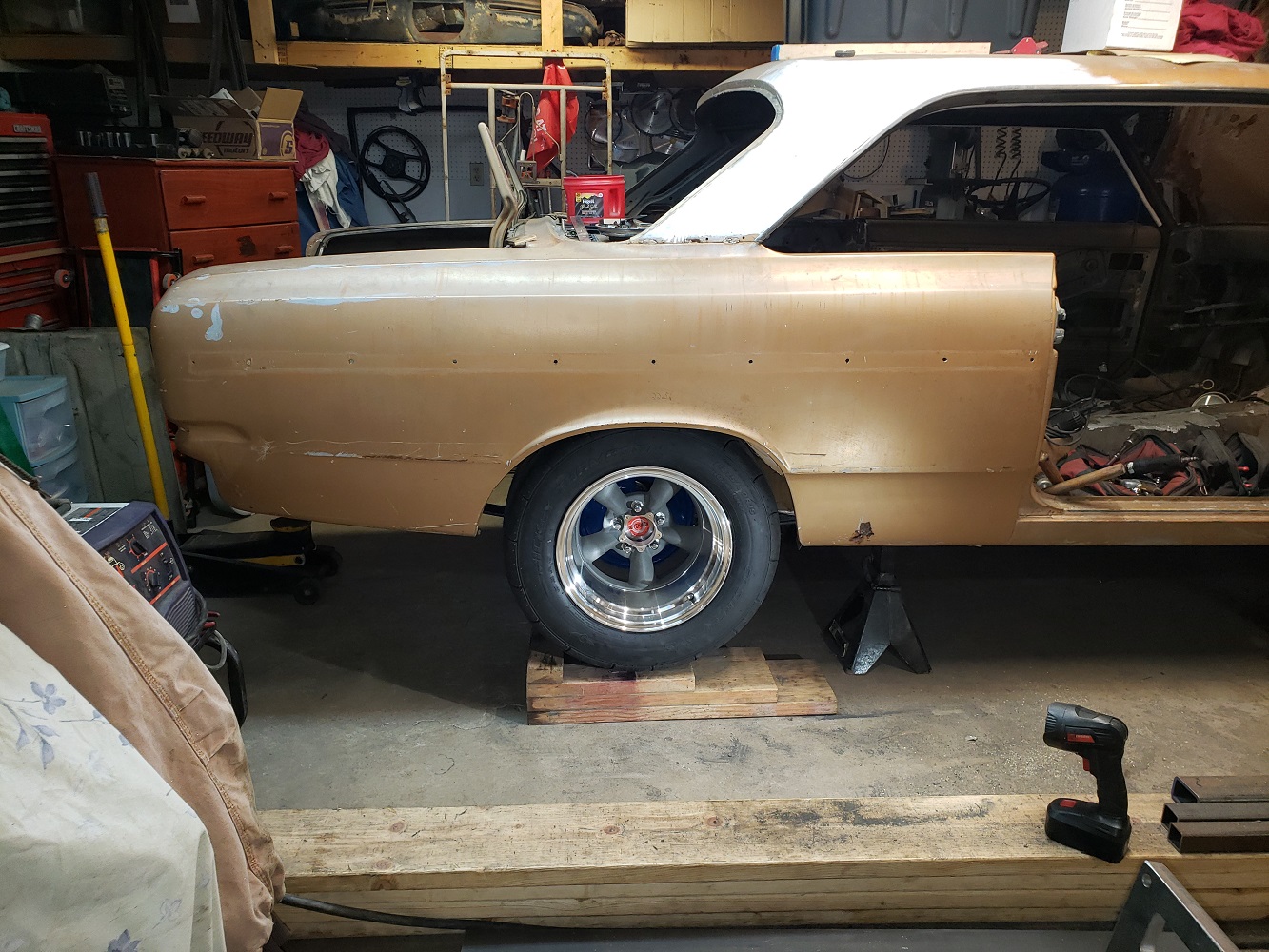

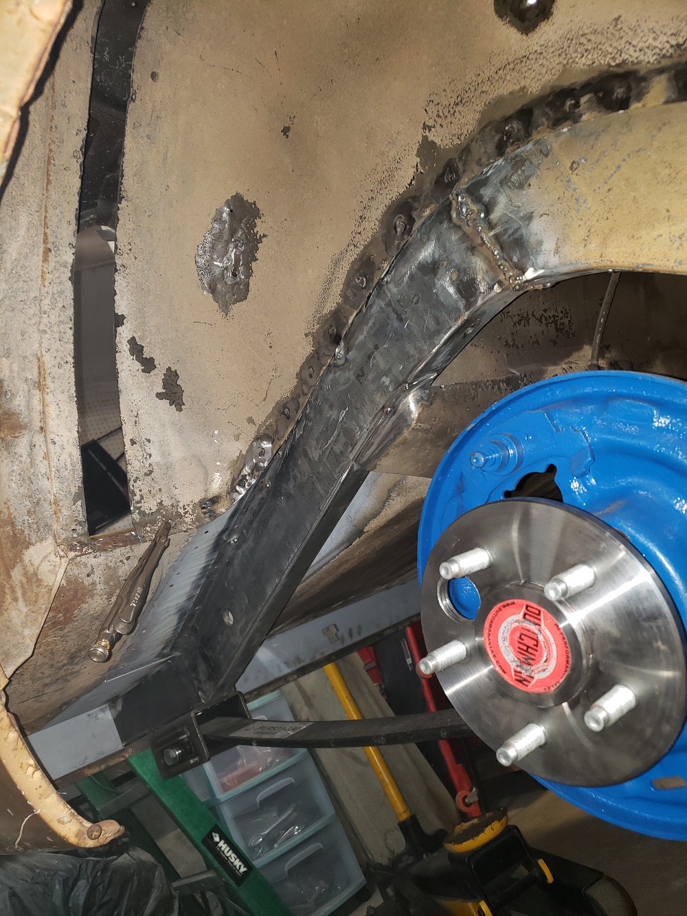

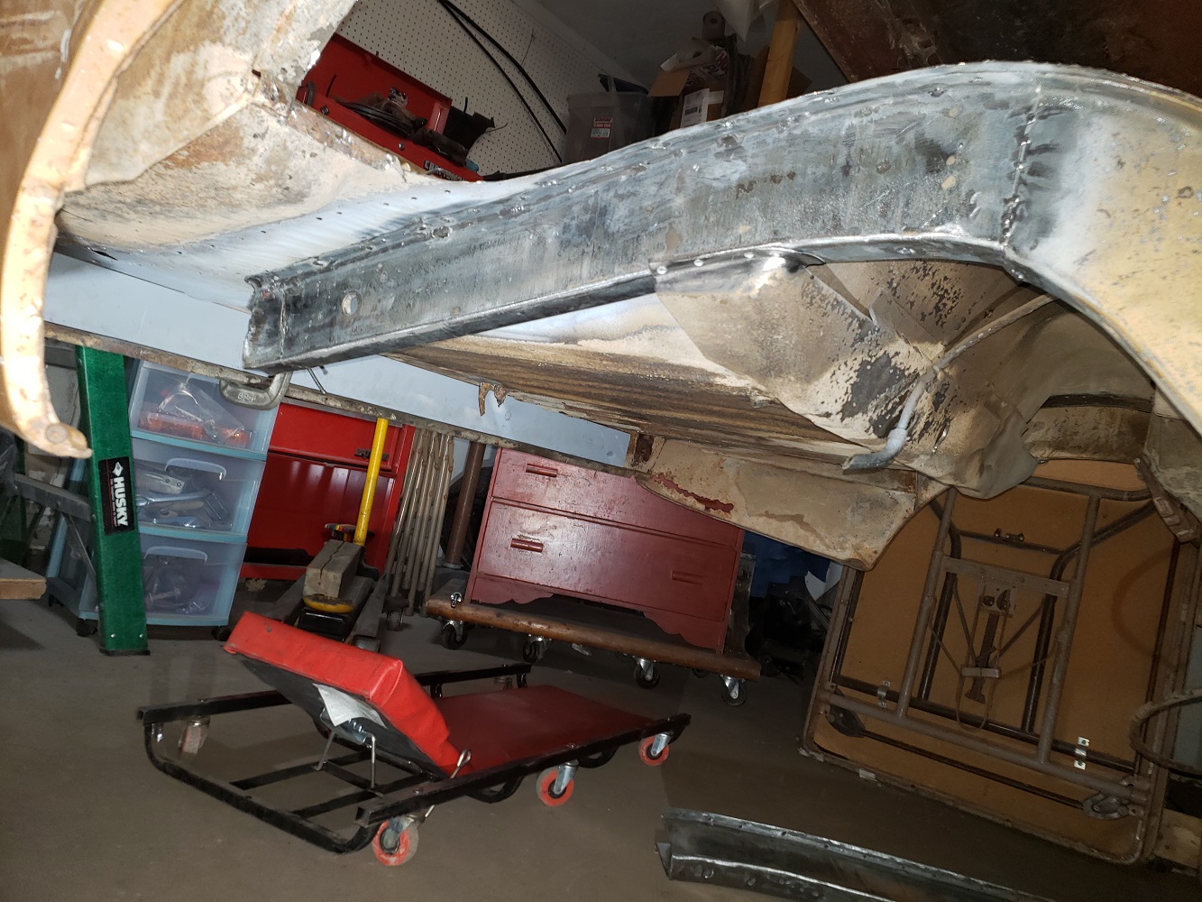

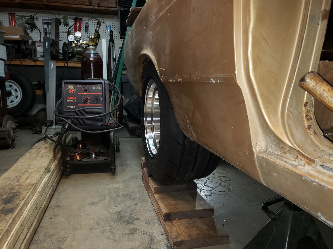

Got some more work done on the frame rails tonight.

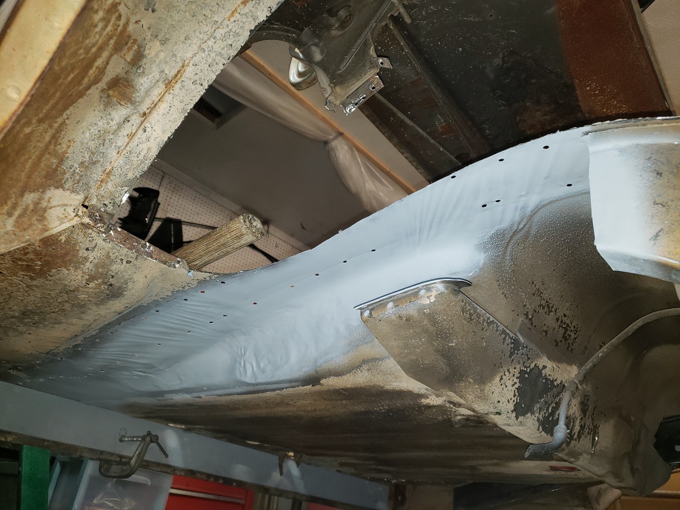

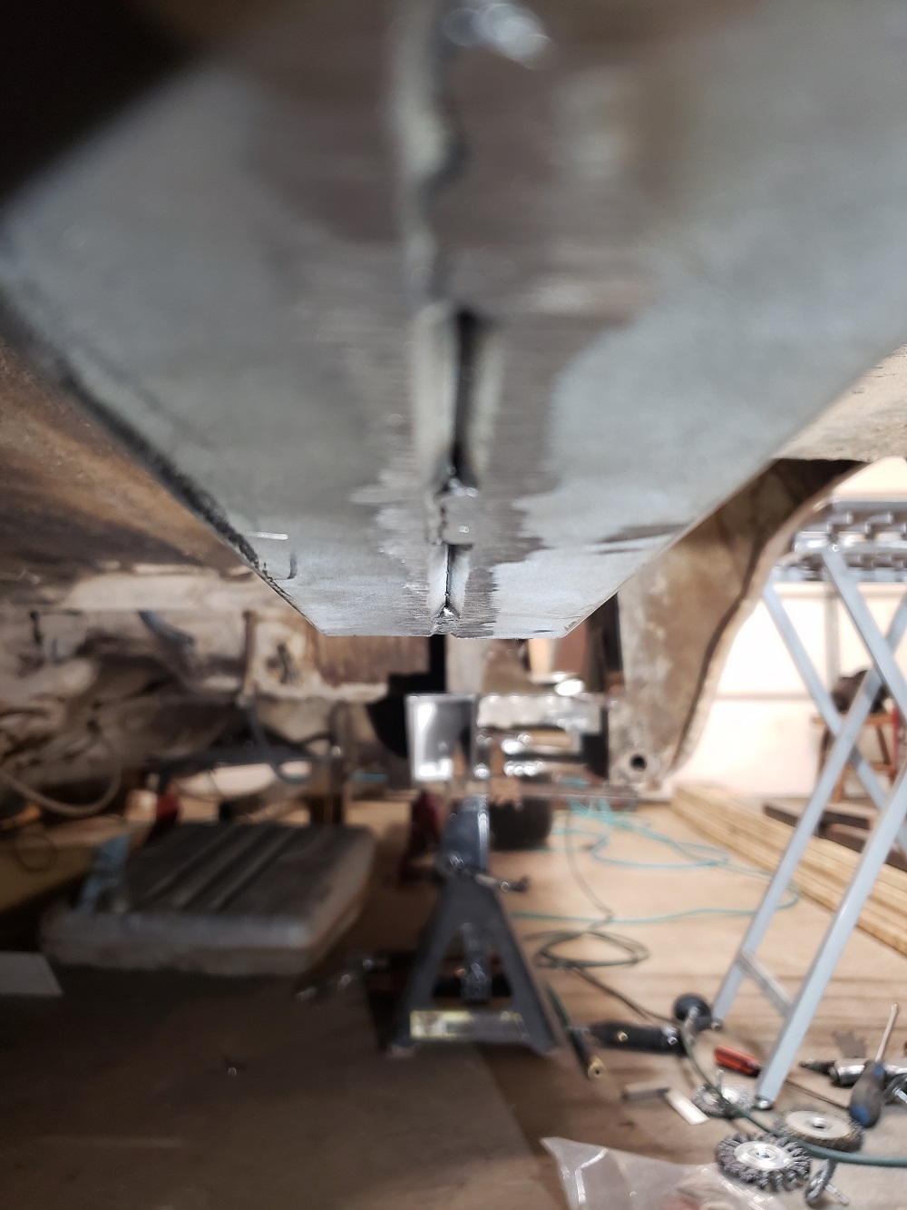

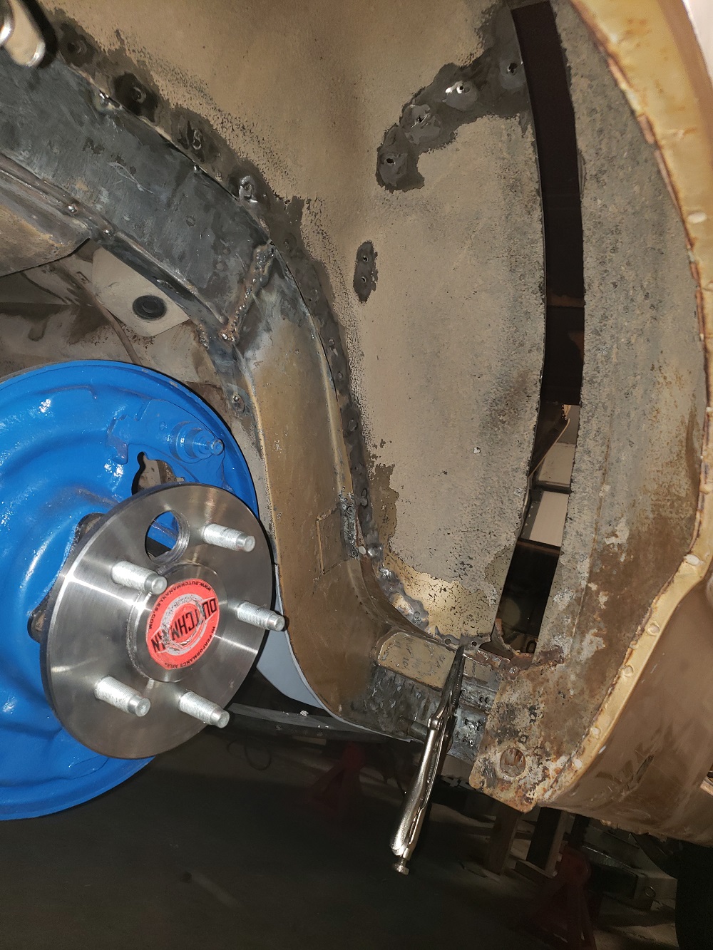

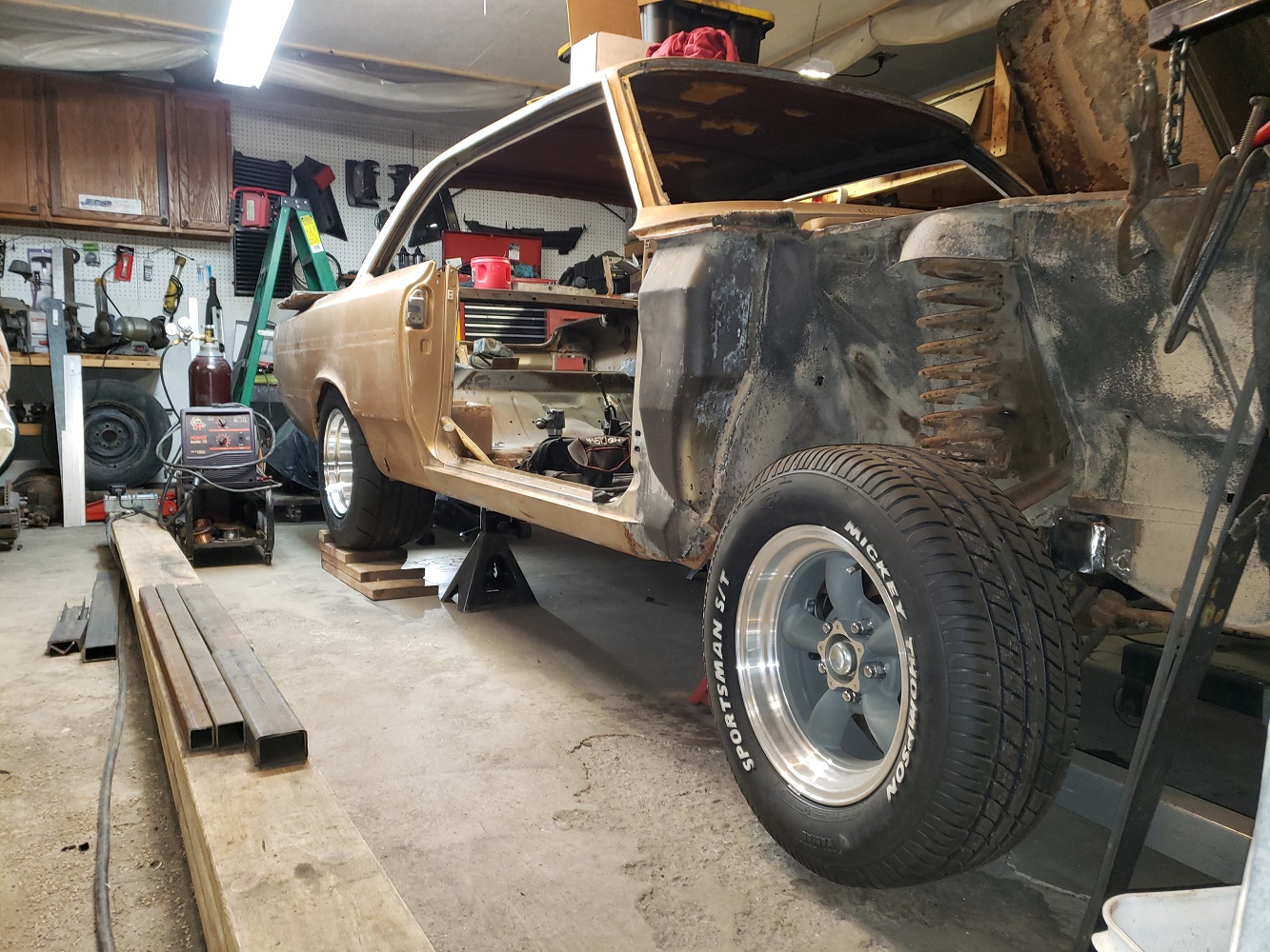

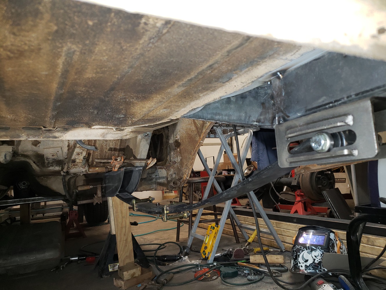

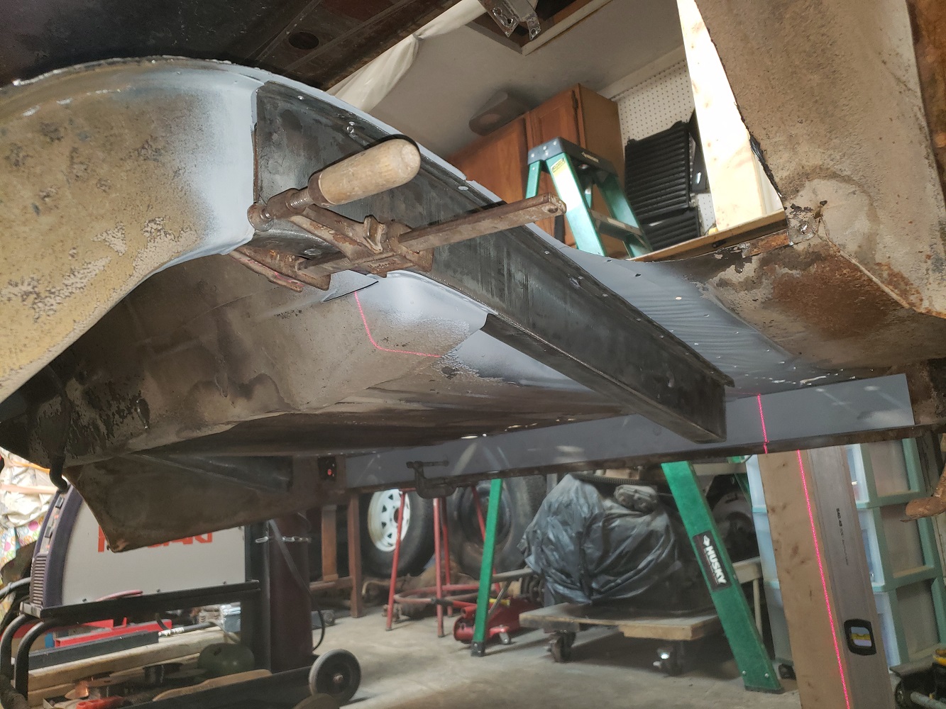

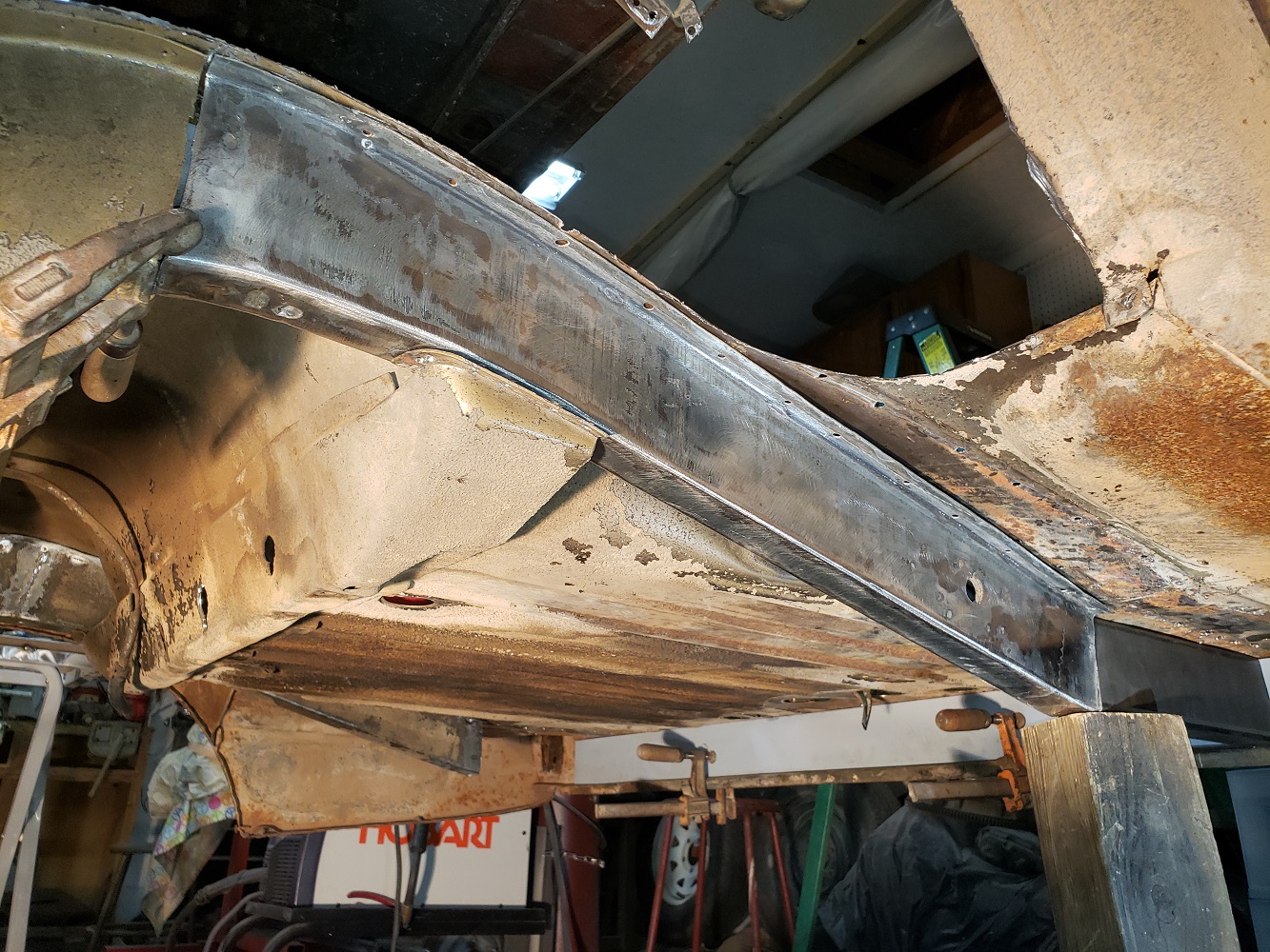

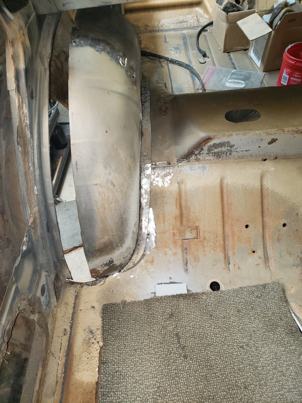

Starting to weld them back in.

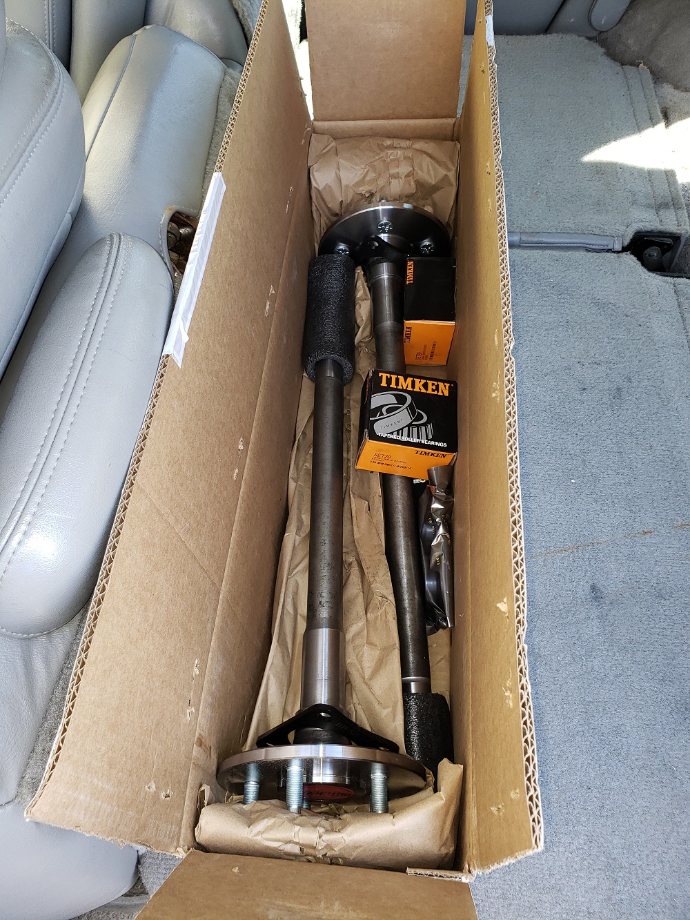

MAY 18, 09:57 PM

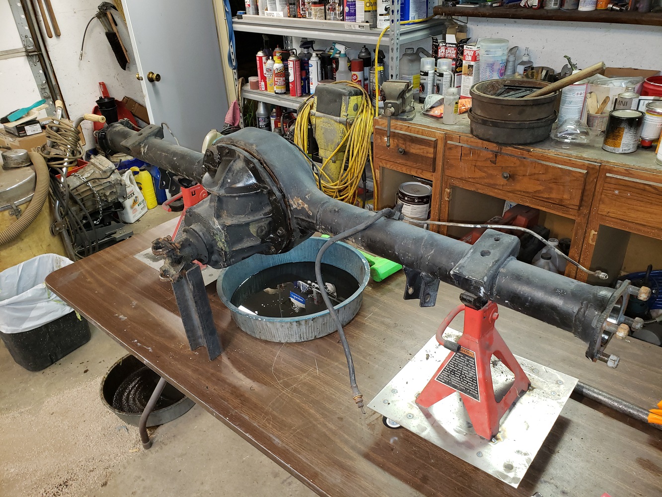

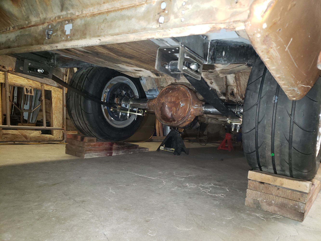

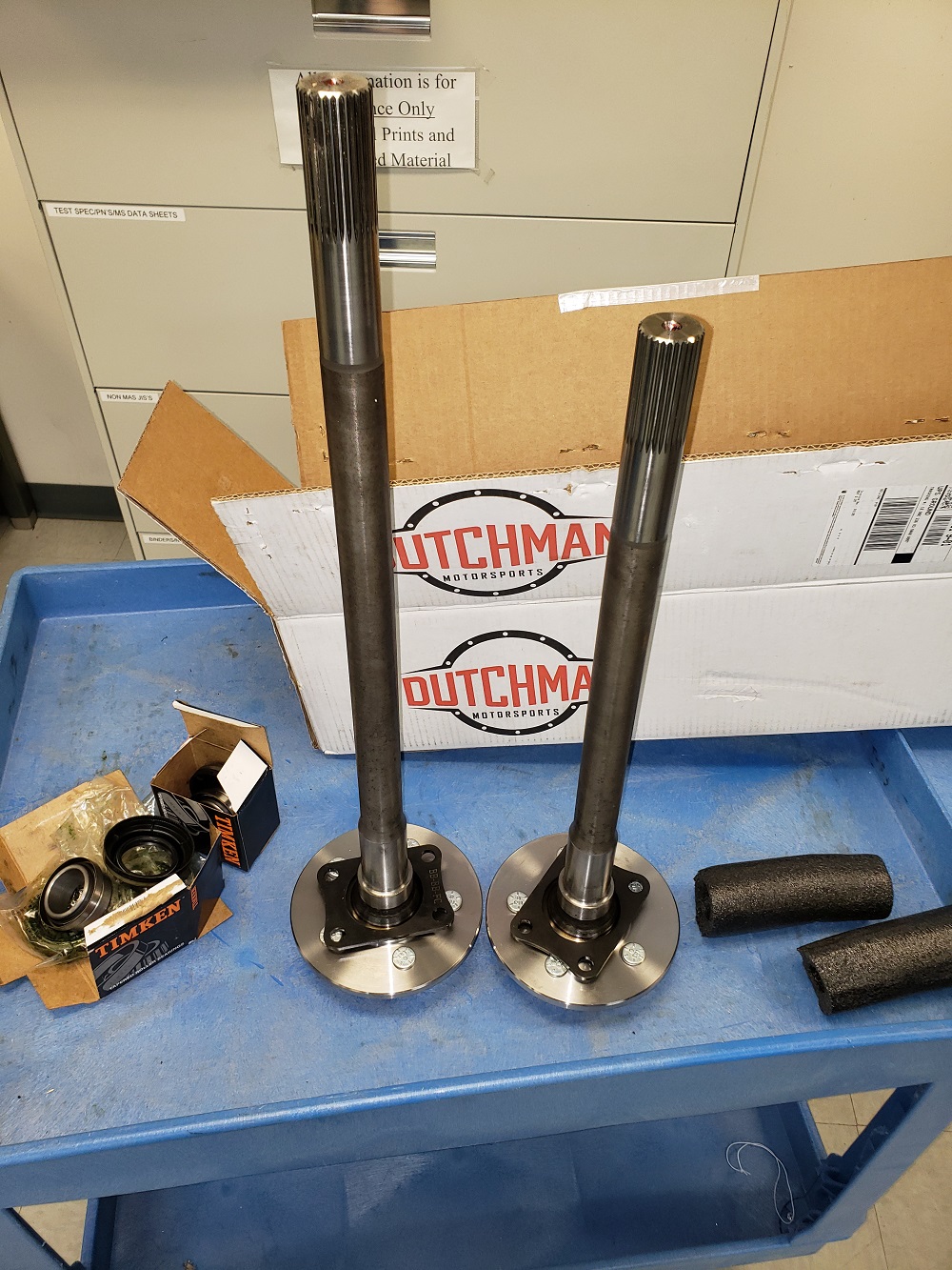

I got mt axles friday.

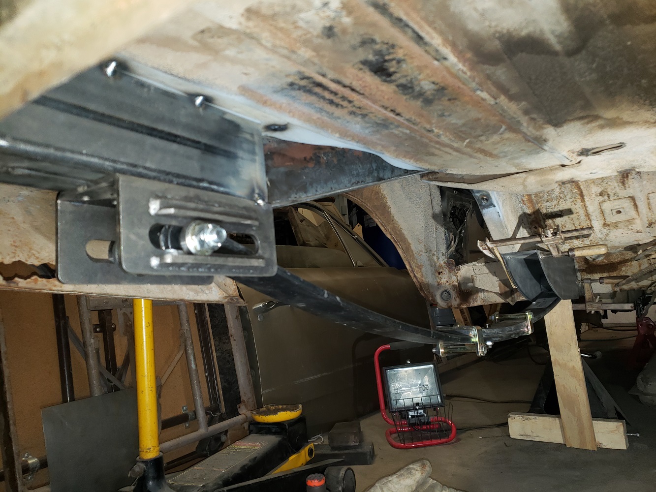

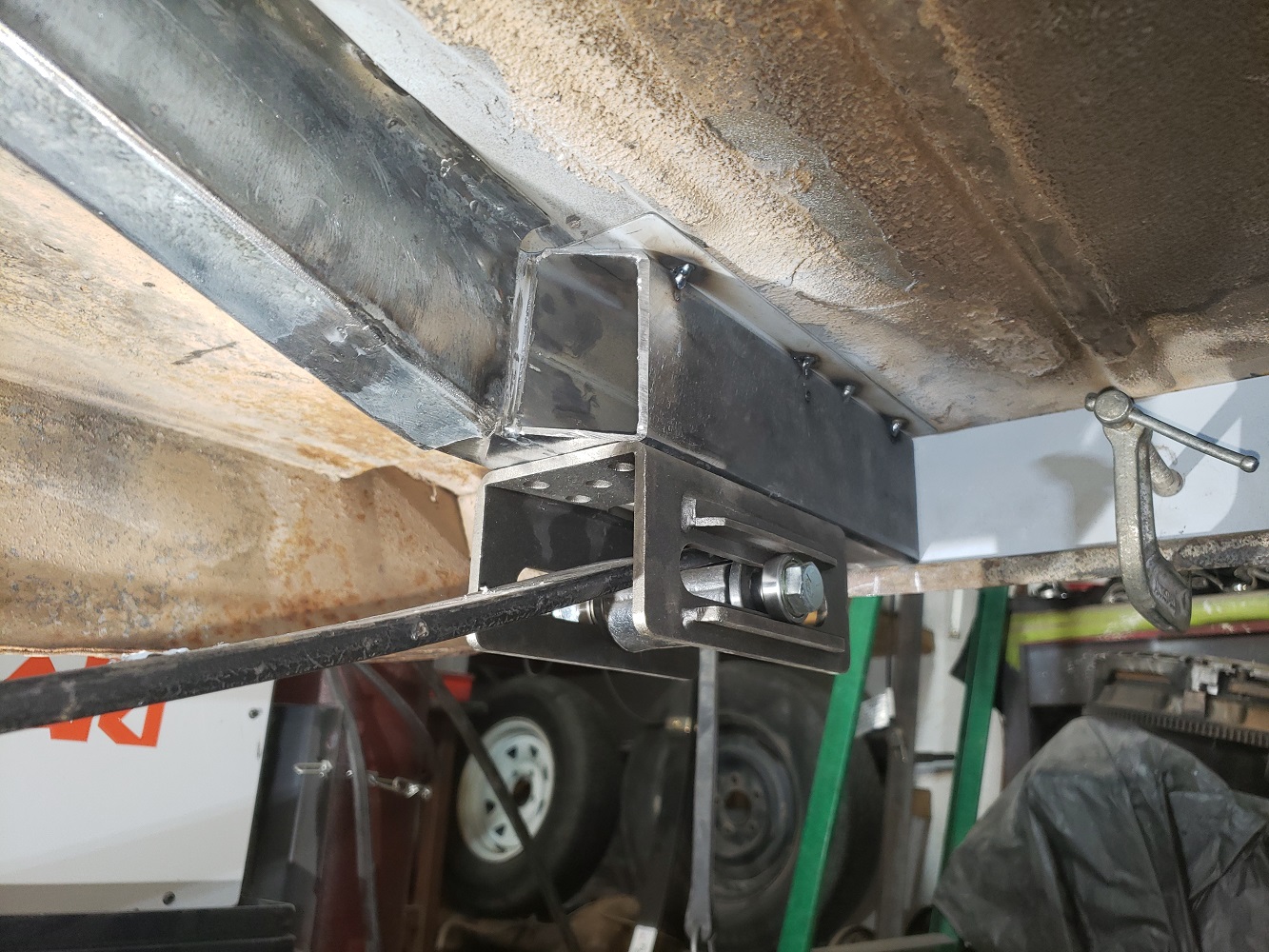

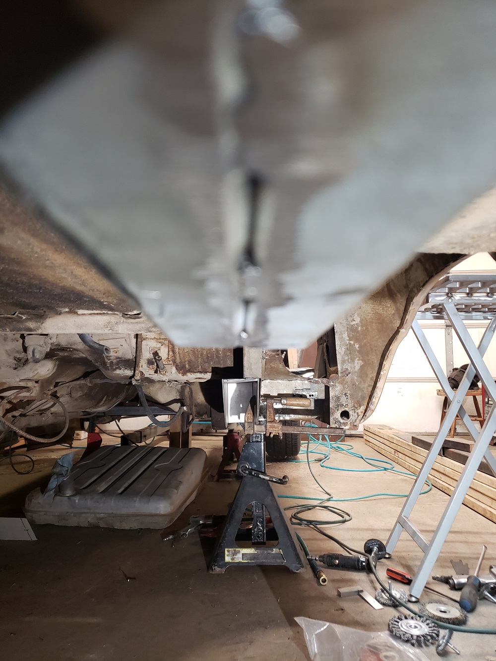

JUN 01, 12:53 AM

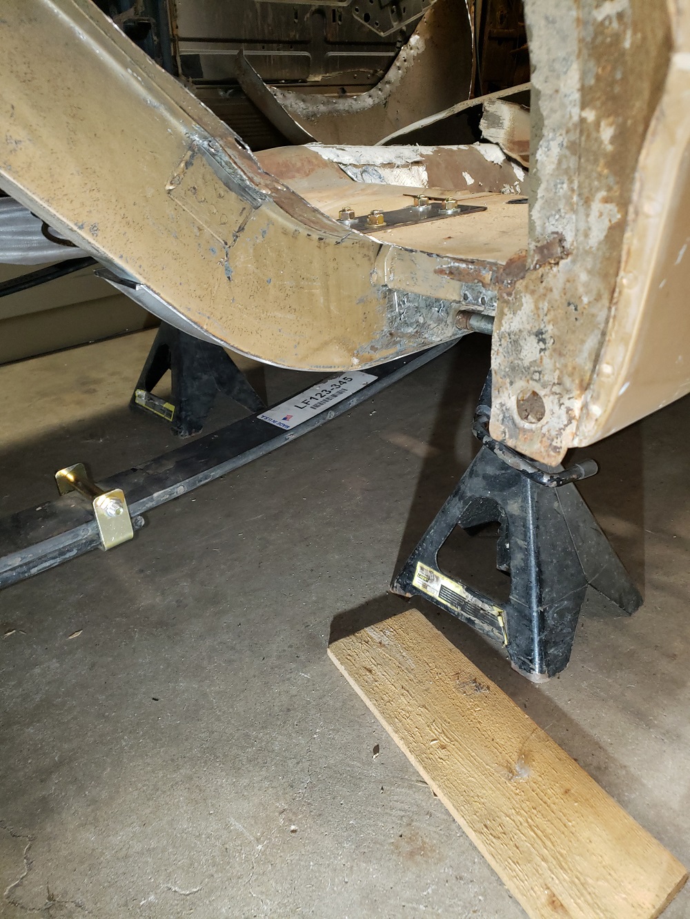

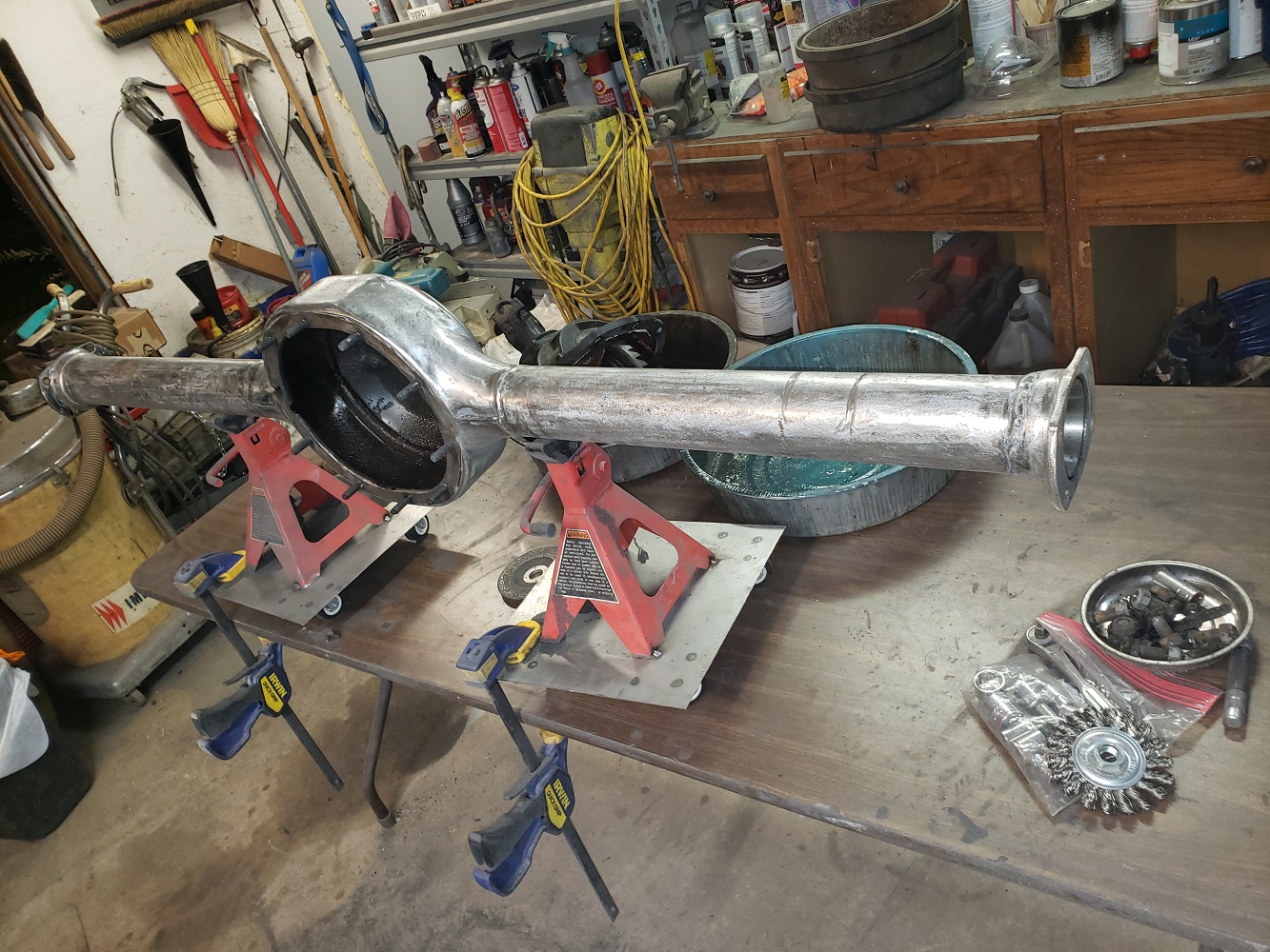

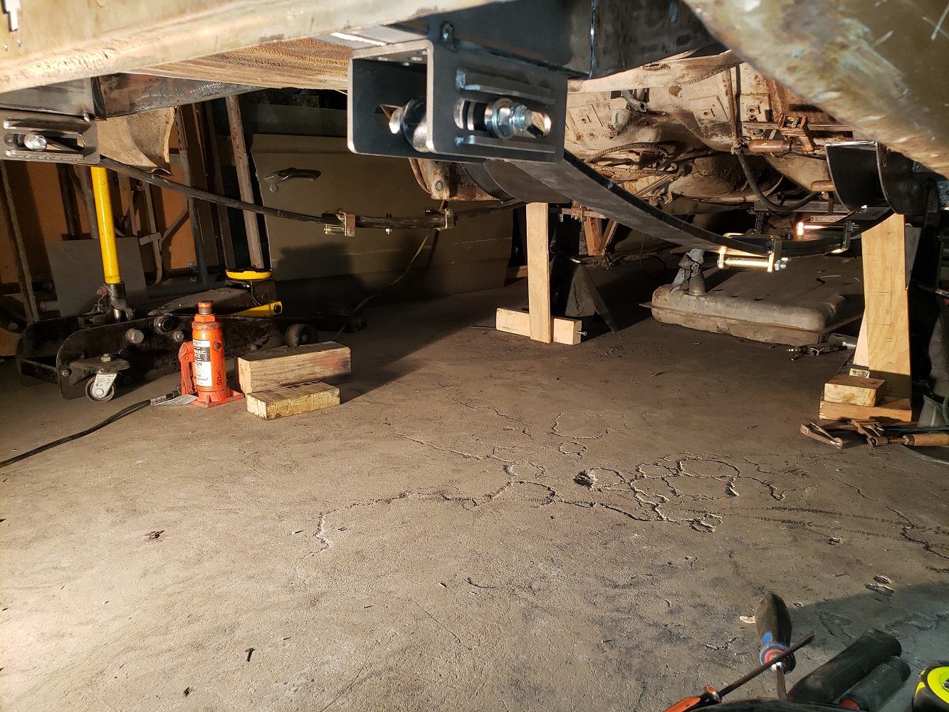

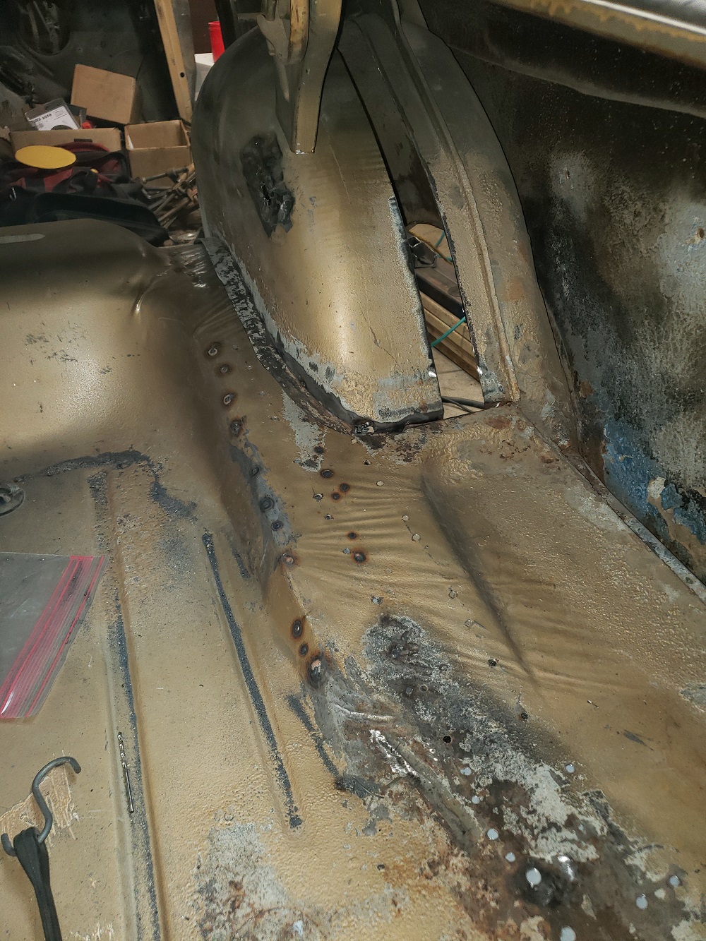

Got the front spring hanger boxes bolted in and gas tank in. Next is cutting the rear end down to size.
I had to move the gas tanks to center it.

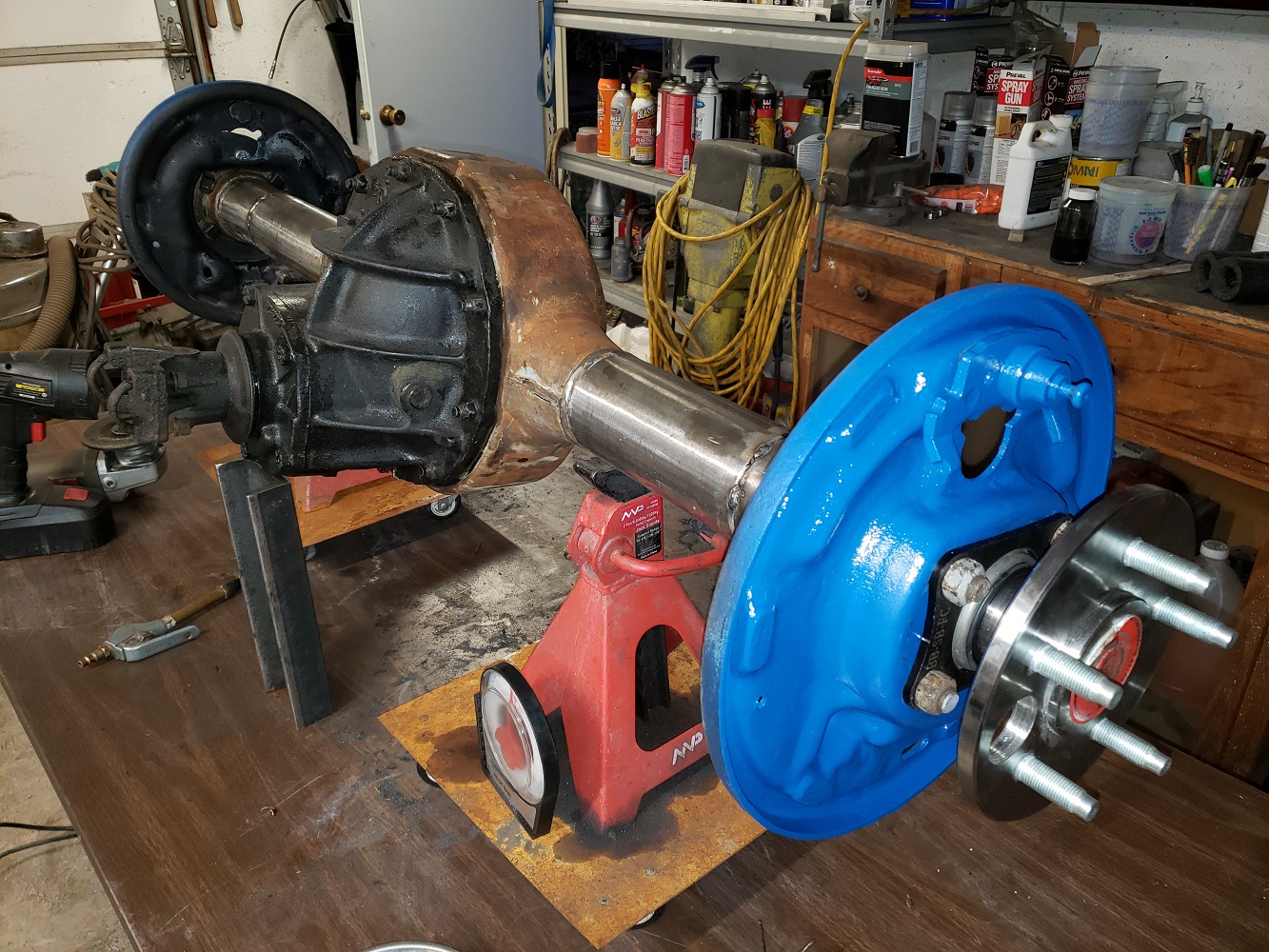

JUN 02, 01:04 AM

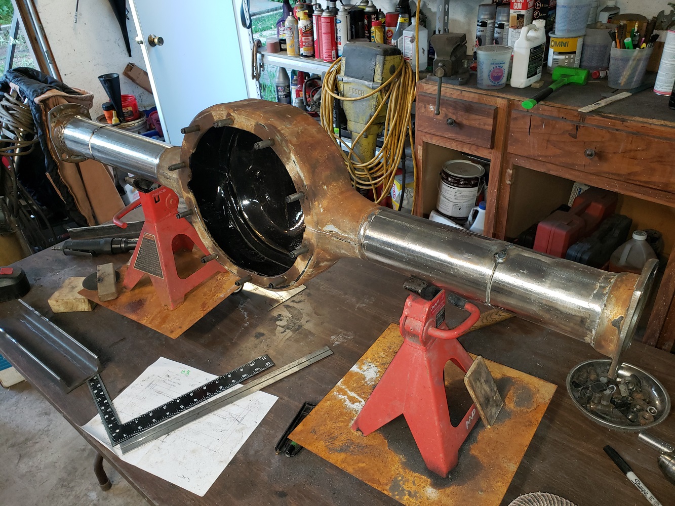

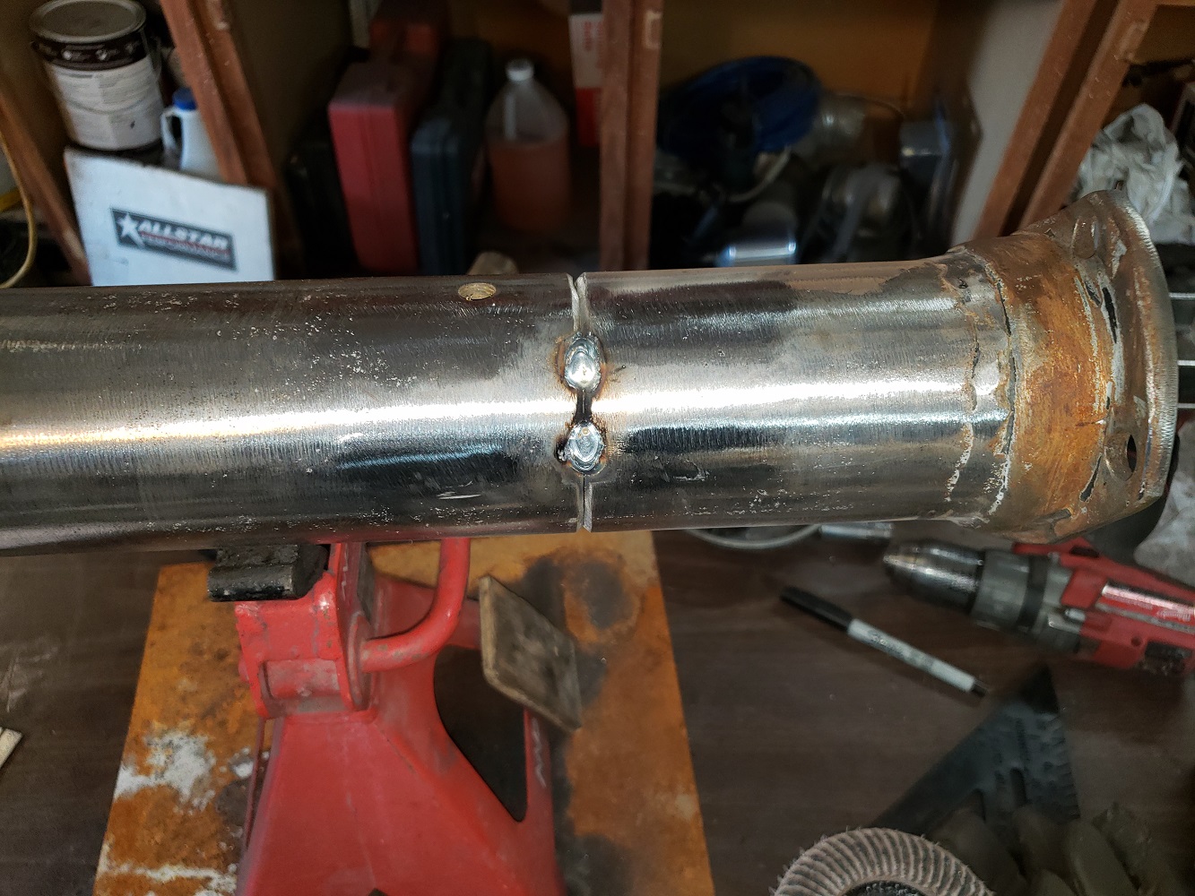

I still have mental block trying to envision the difference in setup for a stock width 78 Bronco axle 65.25" (the dark tall ones 31.75" each) and the new ones cut for a 50" wide centered pinion axle. The new ones are LH 22.312" and RH 26.562" from 31 spline Dutchman axles.
