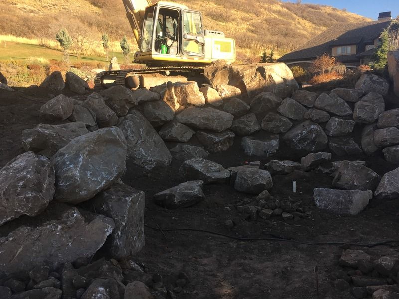

Are you expecting mortar fire? Heh heh... looks good.
