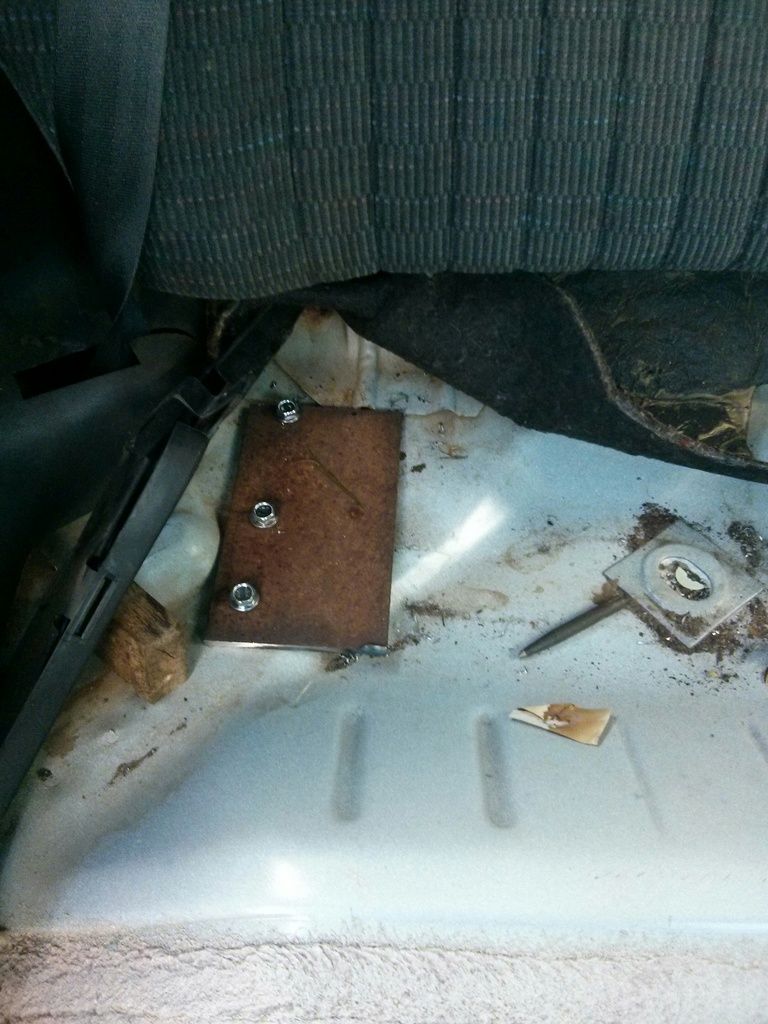

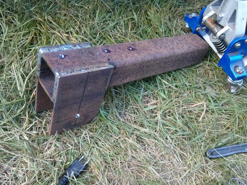

Well, I haven't done any forging just yet... I may not actually have to... But here is my new sub-frame and trailing arm mount, hilariously overbuilt. The tubing is 3/8" thick, and the plates on the side are 1/4" thick. The rest of the car will be rust and dust while these parts still exist :P
I'm bolting them through the floor, and having a 7"x4"x1/4" plate of steel inside to sandwich it to. I'll then weld it all up just for extra overkill. There's a transverse crossmember that the fronts will be welded an bolted to as well, so I should be able to use these as jacking points, too. That's the idea, anyway...
