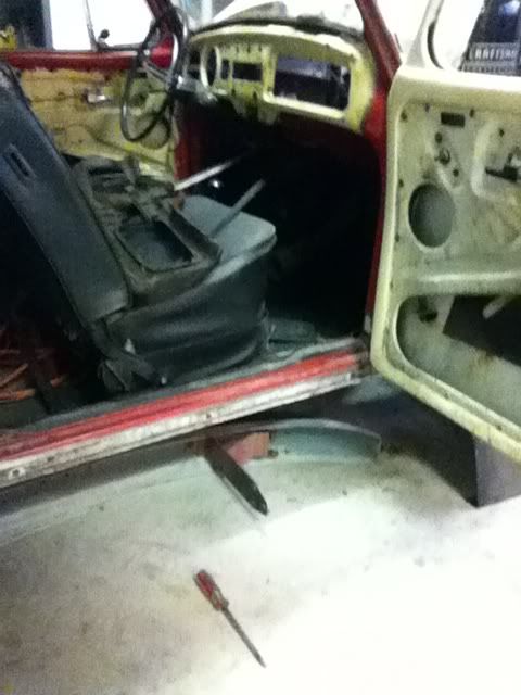

More photos and an update on progress.......
I have a little over a quarter of the car sanded down, found some more rust in the front quarter area that was hidden behind bondo. The car was an electrical nightmare, the PO had used a universal fuse kit that accepts glass tube fuses (instead of using the stock torpedo fuses) and hacked the whole wiring harness to bits. Nothing was soldered, lots of crimps and even some wires just twisted and taped together. Not sure how this thing didnt catch fire with the gas tank up front there. I tore all the wiring apart, chucked the homemade fuse panel and found the stock one was in place, but someone had painted it. No biggie its only $20 for a brand new one with a cover.
I ordered parts for it yesterday and was shocked just how cheap parts are for these, I knew they were cheap but were talking a fraction of the cost of parts for other cars. Heres a brief list of parts I got already
Both complete floor pans complete headliner kit rear apron (body panel) complete body seal kit (theres tons of seals on this car) complete door seal kit complete window seal kit (windshield, rear window and both quarter windows) with aluminum trim interior handles custom chrome window cranks and a couple other minor things
only paid $600 for it all! You cant even get door window and door seals for that for a regular car.
Pics taken today
dash removed and gutted
hard to see but right about center is the stock fuse panel
After the pics I got the windshield and rear window out, next step is to gut the interior as its getting new seats and carpet.
