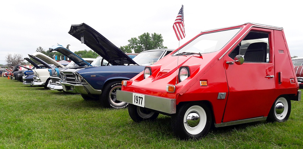

Thanks! I must have not resized those when I uploaded them
This was a great show, with some great guys and a diverse selection of cars. The fiero would not have done as well there. There was a red notch there with some extremely nice additions that would have made mine look shabby. I'm not sure if the owner of that won anything, but it could have.
The citicar at a show offers a neat experience. I have a luxury lawn area behind it since it takes up so little room.[This message has been edited by gen2muchwork (edited 06-11-2018).]
