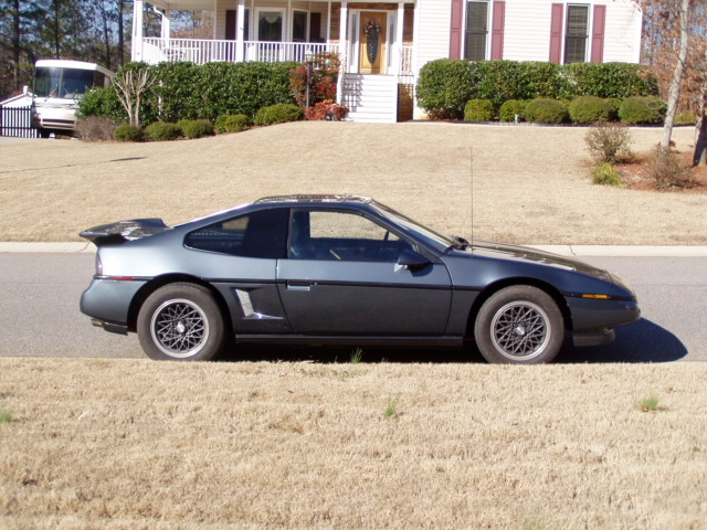

I removed my wheel well liners, lower quarters, rockers, belt line trim, rain gutters, mirrors, headlight doors, dew wipes, rear grills, and rear window moldings. Also the nose badge. I think I removed my tail lights when I got to the paint shop. The quarter windows were installed later, since I used a salvaged fastback clip. All the stuff that needed to be painted body color was left in the passenger side floor, with instructions to "paint these too". (The interior was also devoid of passenger seat and door panels.) Some stuff still needed to be masked/taped, but it was all big stuff like door jambs and windows.
I also had my windshield replaced at the same time, so that didn't have to be masked, either. They could pull off the trim and paint right up to the edge of the roof panel.
This was right after I got it home and installed most of the "loose" pieces.
