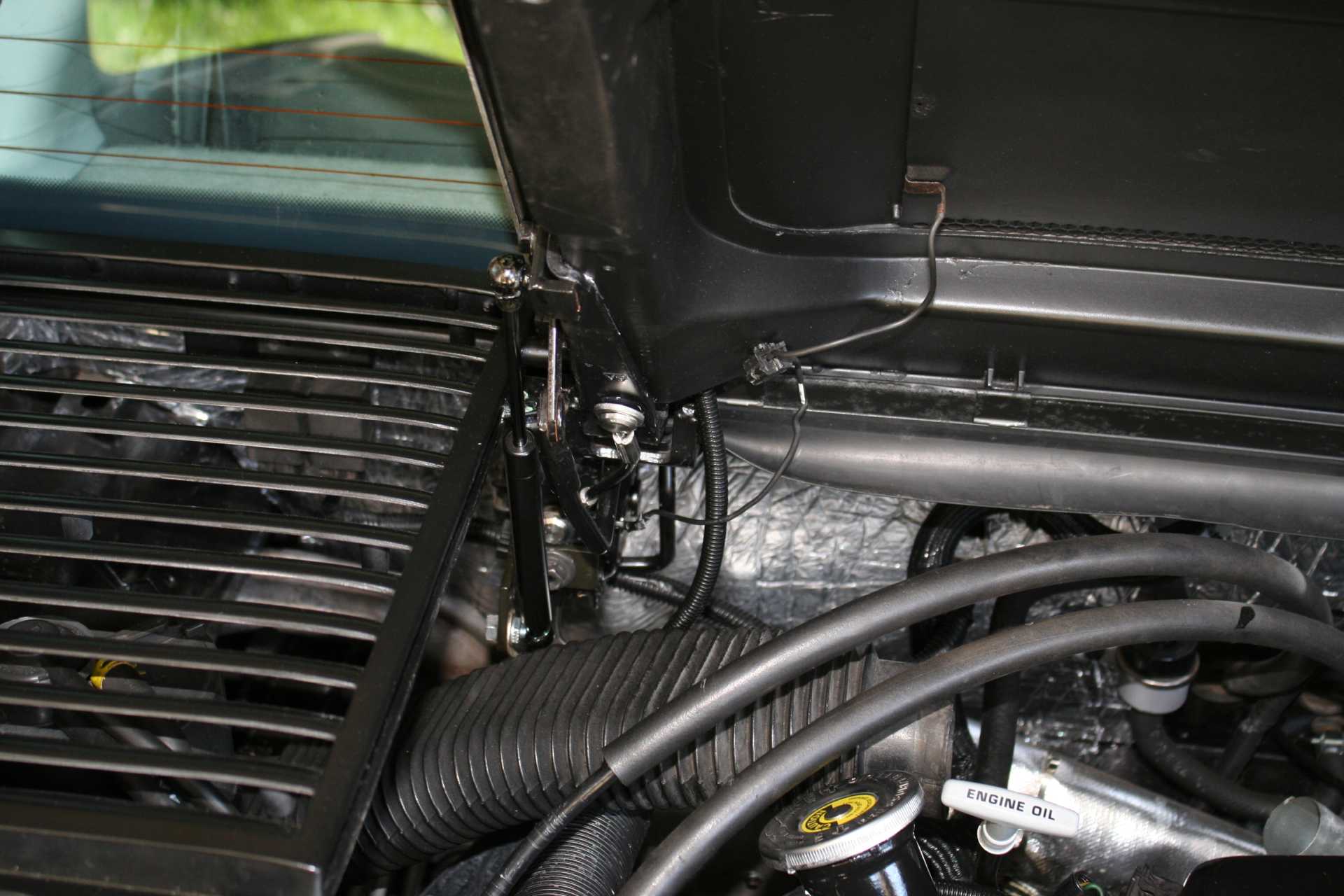

So, I was trying to find my original post on this, but I think I piggy backed on someone else. One of the things I've done on my daughter's car restoration that she couldn't do, was the torsion bars. I felt it was just a bit too dangerous for her to get her hands in the wrong spot, and it required a lot... I mean a lot of strength. I tried all the little tips and tricks I could find, none of them worked. I ended up using brute strength, and the most I could possibly muster (to be honest), was the middle hole on the passenger side, and the bottom hole on the driver's side... and with that, the decklid STILL won't stay up on it's own. It's almost there. If the one on the driver's side could also make it to the middle, it might work... but I was honestly just totally over it.
Anyway, I bought Rodney's decklid gas strut, and installed it on the driver's side (where there's less stuff going on). It works awesome...

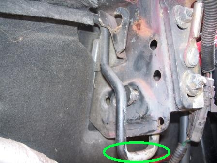

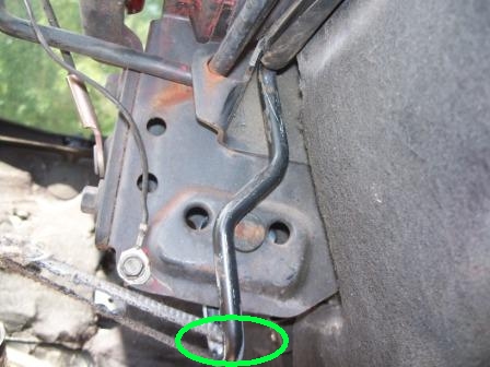

First, this is where the rope is looped through. It's at the end of each torsion rod.

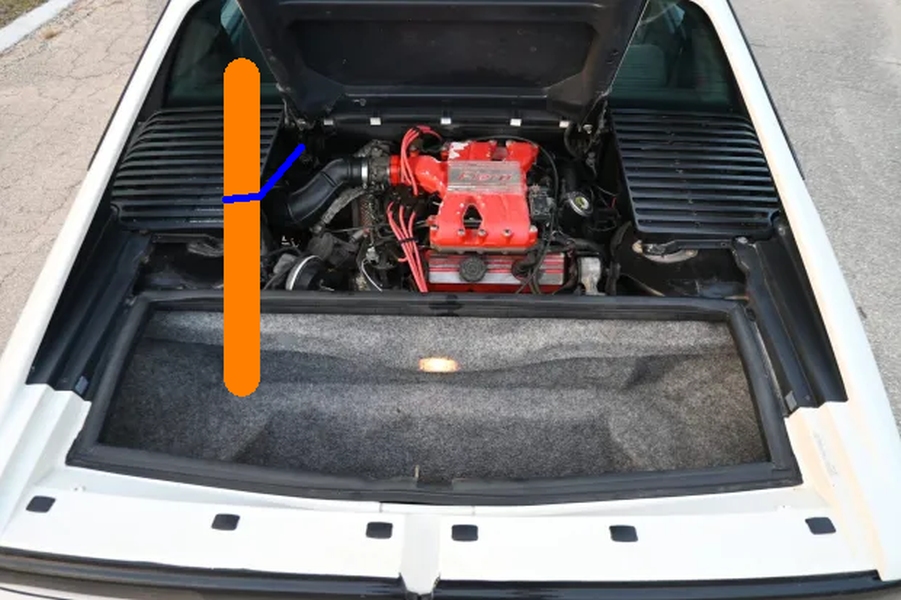

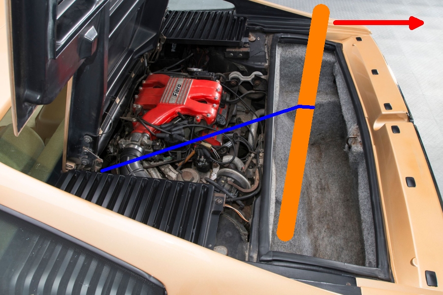

And now the following two images show the positioning of the 2x4, and the rope attached to it. Notice the 2x4 does not go to the bottom of the trunk. It rests on the shelf.
Push or pull the top end of the 2x4 back. Takes one hand. With your other hand, move the adjustment pin. Repeat on the other side. (Perhaps put a short piece of wood between the bottom end of the 2x4 and the front edge of the trunk to dissipate the forward force of the bottom of the 2x4 against the trunk wall.)
