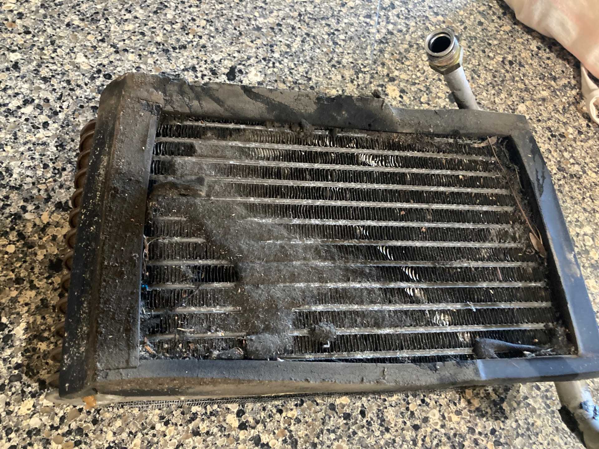

1 - We never removed the evaporator coil to clean it. We just removed the fan-speed coil thingy, and stuck a vacuum cleaner in there. 2 - The air flow coming out of the vents was almost non-existent.
I even replaced the fan itself because I kept thinking that was maybe the problem. It improved it slightly... but still, it wasn't the air flow I was expecting. So I tore most of it apart this afternoon (she didn't see me doing it), and I removed the evaporator (which was a pain in the ass):
I didn't take a picture of everything that was in there. We sucked out most of it from the fan speed coil thing. I kept sticking a tube in there and a coat hanger, and my fingers. There was so much crap, I can't even tell you. It was insane. What you see in the image above was all the other stuff that had been sucked into it... like all the dust and whatever else.
I was just going to buy a new one, but this one pressure-tested ok, and I straightened all the fins and blasted it with air and warm water from the other side. I can now see through the evaporator... so I know it's "good." But I'm kind of pissed we didn't do it sooner. I haven't hooked everything back up yet... so I haven't checked the air flow from the vents, but I expect it to be a lot more than it was.
"Whatever else"... such as mold, etc. It's really disgusting when you realize that we have to breathe the air that's blown through all that crap. Ughhh!
So even if there wasn't a potential fire hazard, there's probably plenty of health reasons alone to clean all that debris out of the HVAC assembly.

There was probably enough crushed leaves and dirt crammed in there that it could easily fill a 16 ounce coffee cup.
It was nasty...

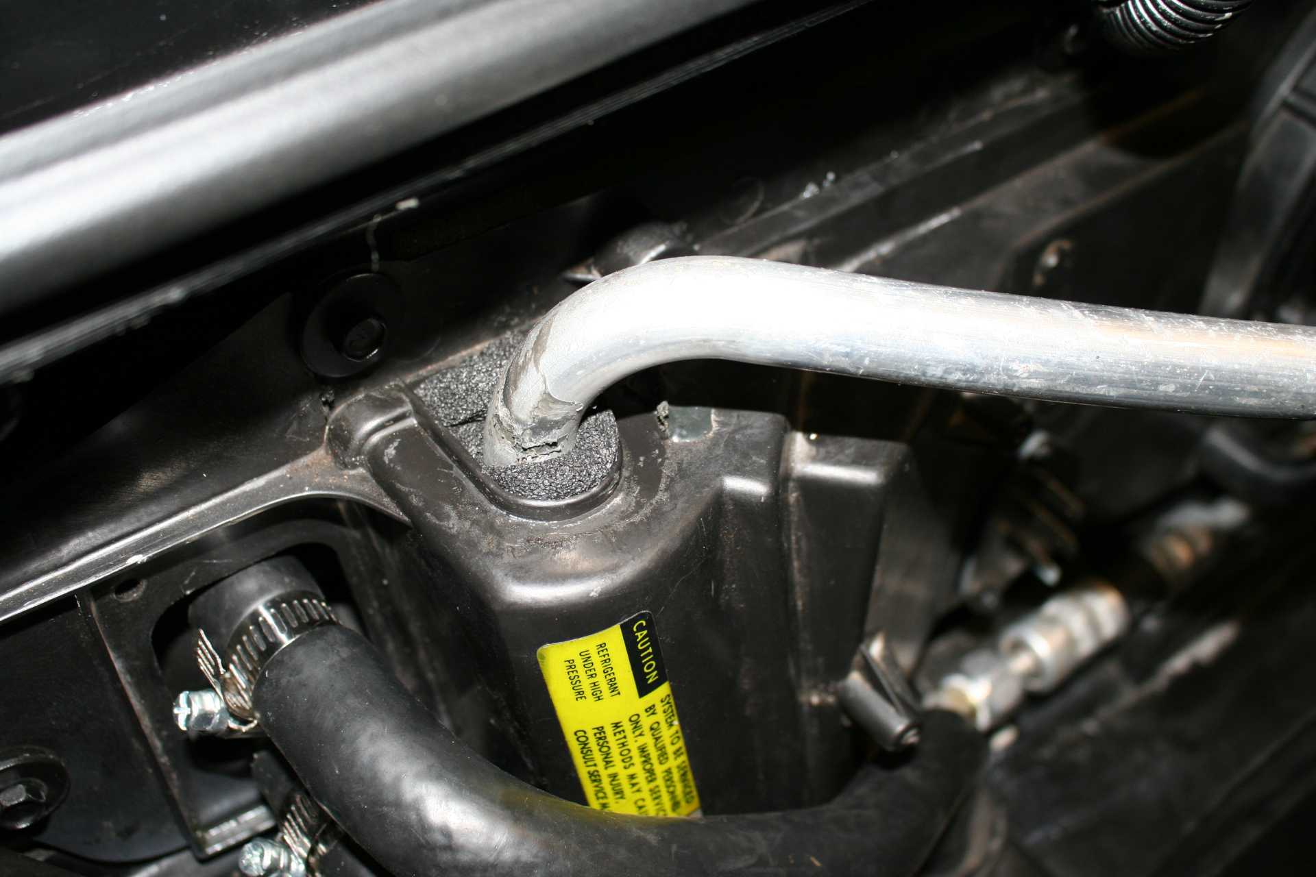

This is what I ended up ordering: https://www.amazon.com/dp/B008A3UG94

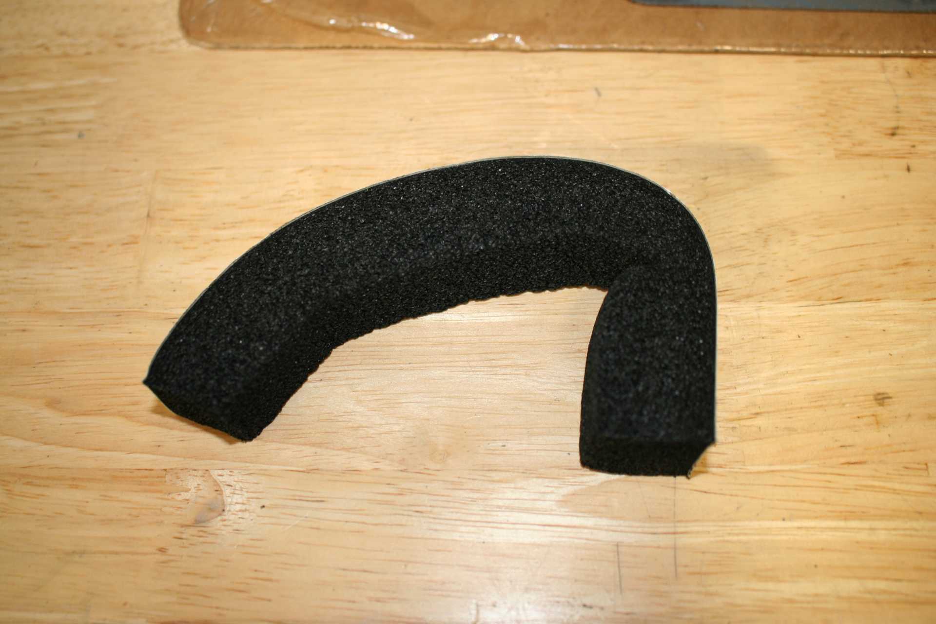

It's a dark grey, almost like a charcoal... so not exactly like the factory, but I think decent enough. I also stuffed the hole with adhesive backed foam insulation too... just so the putty would have something to sit on:
... and the foam strip:
