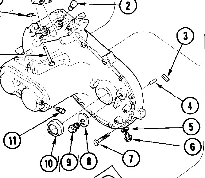

Is there a replacement available for the 4 speed , the nylon washer that says 5w 30.. ?

It's not an oil drain plug, and it's large compared to one, Thanks thou..

Unfortunately, No GM Part Number for the {8} fill plug washer... Only a description: WASHER, FILL PLUG (M20X29. 5X2)(NYLON)

i found a dorman washer no problem, if you gotta you can make one out of copper with holesaws edit: should specify it was for an air cooled vw i forgot the part number but the drain plug is about the same size[This message has been edited by cartercarbaficionado (edited 04-25-2025).]
