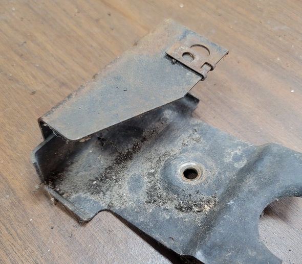

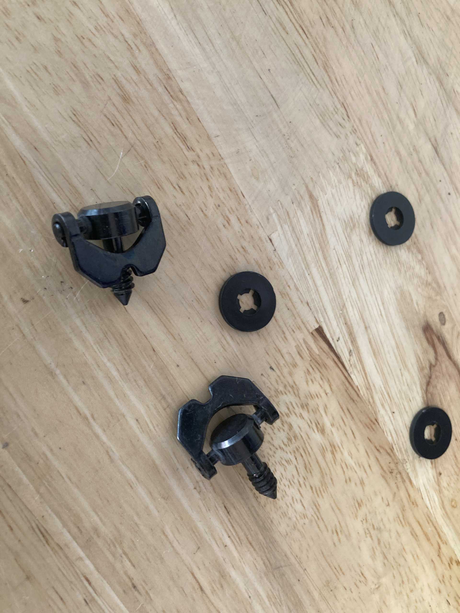

Ok, when my daughter and I were taking apart her car early on, she was really good about putting everything in bags and writing down where everything came from.
There is one thing though that we've completely missed.

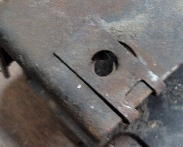

The decklid vents, when they get screwed down (tightened down) on the little perch that mounts to the top of the shock tower... there's no clip or anything there for them to screw into. I'm quite sure there were clips of some sort, but we can't seem to find them anywhere.
We have these... (below), but we're just missing the clips. Are these standard clips that we can buy or anything? Anyone know what they look like? They don't seem to fit the standard screw clips that are used everywhere else on the Fiero...
Thanks!!!

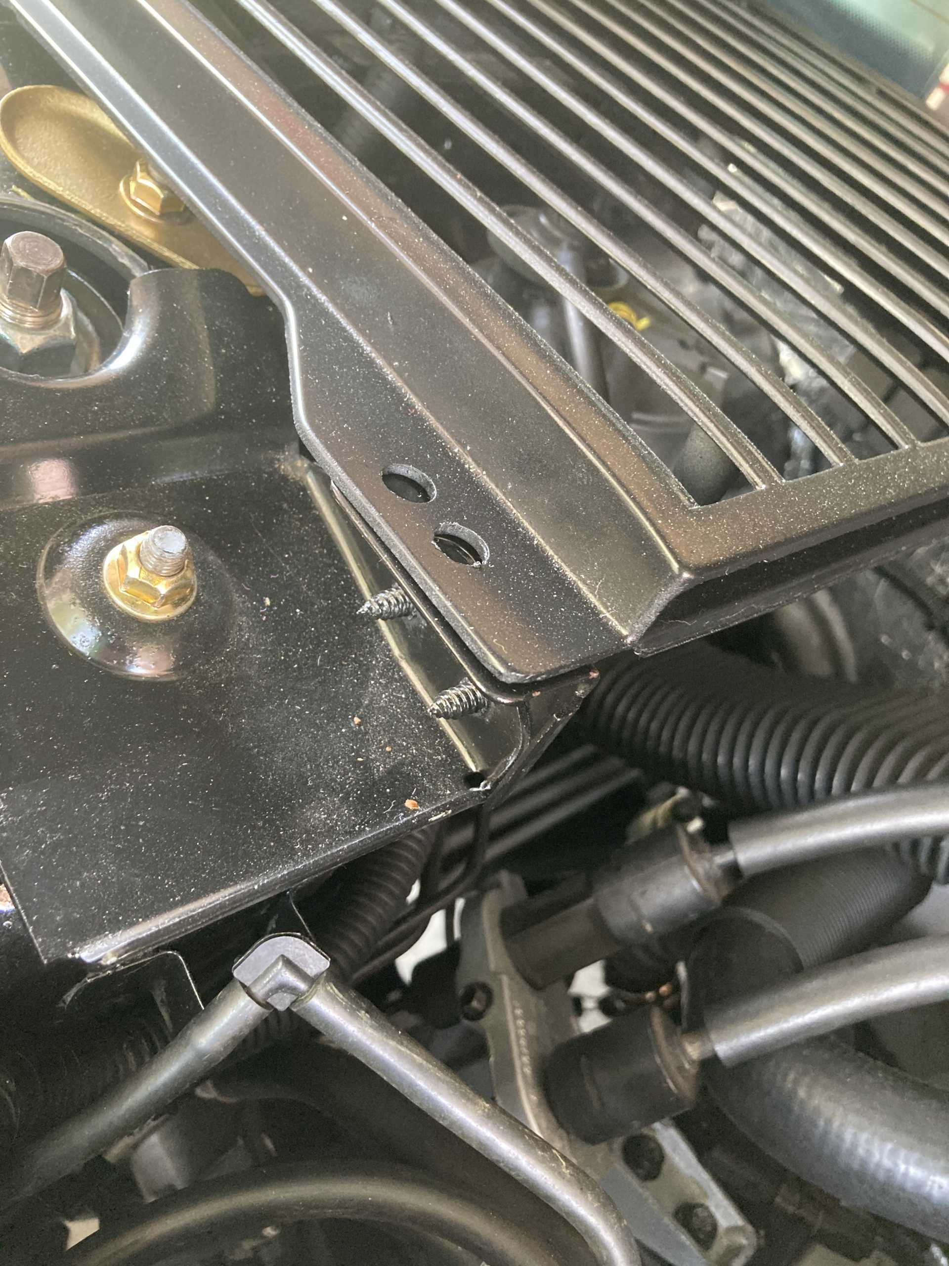

Mike in Sydney APR 20, 07:11 PM
A fender clip is used. See https://www.google.com/aclk...HKQQ5bgDKAB6BAgFECc& adurl= ..
You can find these at most auto supply stores. The factory ones have a black oxide coating.

fender clips or you can use nut serts if you dont wanna lose them again
82-T/A [At Work] APR 21, 07:22 AM
Ok, thanks guys... then I just need to find the correct ones that we took off then...
Thanks!

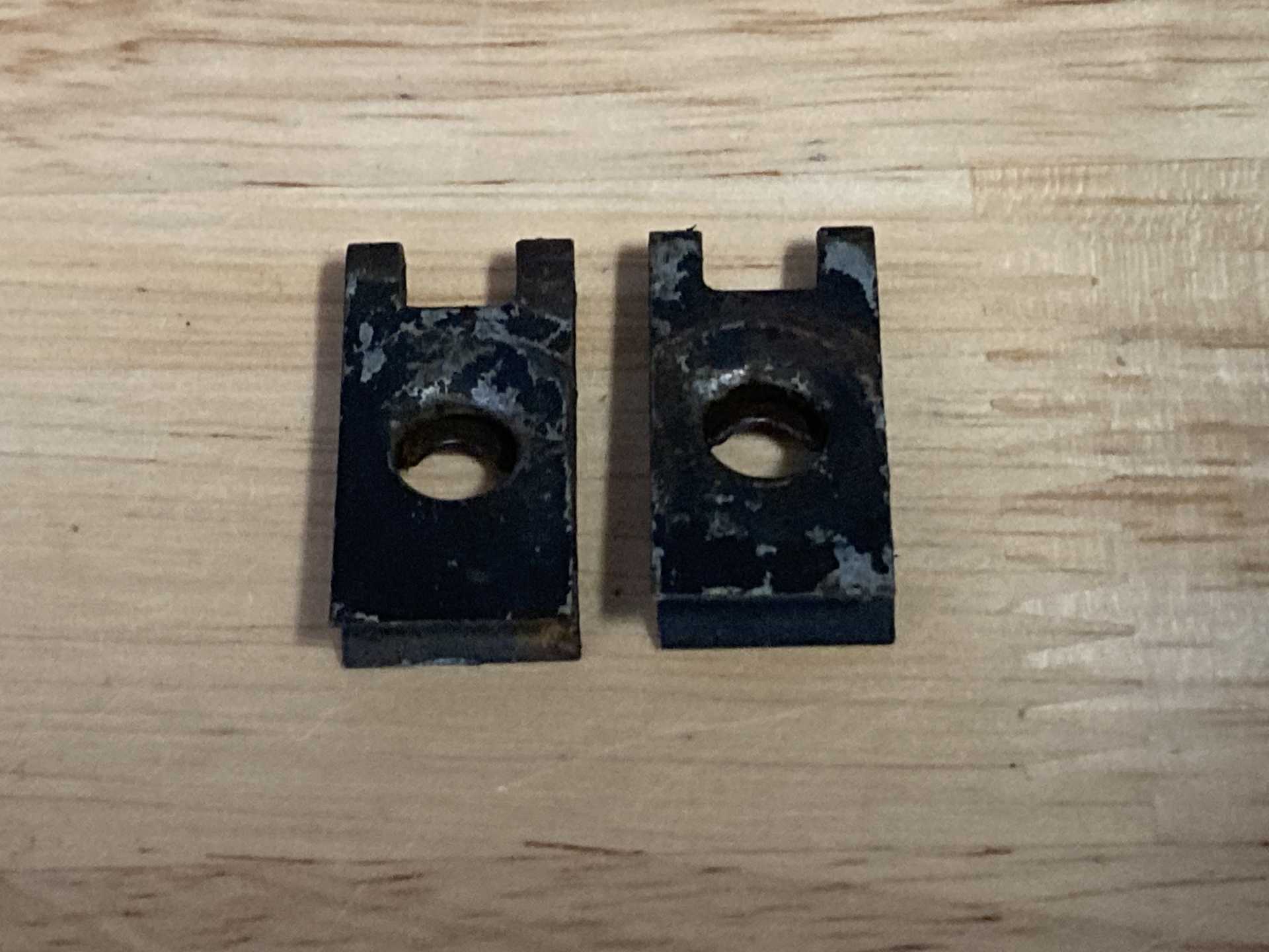

82-T/A [At Work] APR 21, 05:45 PM
Originally posted by IMSA GT:
Thank you! Damn... those are huge. I'm going to have to look for those... we have some unsorted stuff (usually for stuff we tried to replace with better hardware), so it might be in there. Thank you!

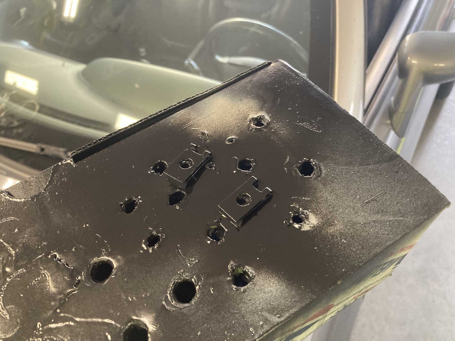

82-T/A [At Work] APR 21, 06:26 PM
Thanks guys, just found them. They were in the bag of spare parts of things I didn't think we needed.
I'm going to hit them with some anti-rust paint, and then spray them with some epoxy chassis black.
EDIT: Give it a day, and they'll be ready to go on...
