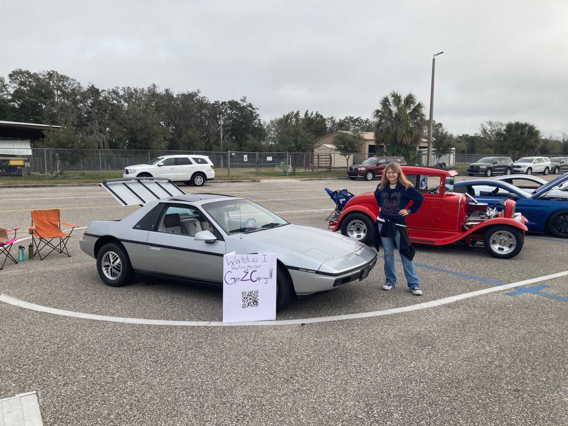

Those are actually some seat covers that came with the car. Remember that this video is like... 6-8 months old... she's just getting to them now. She's already re-upholstered the seats, but hasn't done the video for it yet... haha. The seat upholstery basically came out looking like 86-87 SE and GT seats, but in leather.
Kind of hard to see... and I just got back from a business trip so I don't feel like going outside to the garage, haha... but this is a picture of her car from her high school's car show that she went to a few months ago (car was running and driving again at that point with the new motor).
... you can kind of make out the recovered seats. I do still have those weird seat covers if anyone wants them... they're made for Fiero seats, haha.
Also worth nothing... in the background you can see a bunch of Dodge Durangos. Her school has 8 Dodge Durangos for Drivers Education. They all have V8s in them. When I was in high school, I went to school in a good area, and we had two piece of crap Dodge Omnis. She has no idea how lucky she is that her school basically has everything.

Ok, makes sense, I wondered what was up haha, looks great, only thing is it's maybe riding high, which I guess makes sense, I think you used the ws6 springs (stiffer for the heavier v6), and of course new struts (gas charged, adds some extra springiness), other than that, looks great, cool that her school has so much car related stuff, you both have it lucky haha, my (2) high schools had nothing, nothing at all for drivers Ed, car club, etc. didn't really matter, I got my driver's Ed through a specific driving school, paid by Hagertys license to the future program, not that it taught me anything (it was a garbage driving school, and the amount of teaching they did should not have gotten a diploma, I literally had no class time, anyhow, I had driven 10,000kms with my dad before I could even drive alone, in 8 months, everywhere from NB backroads to Toronto in rush hour, so I'm well taught)

But yeah... she actually already had WS6 springs on her car (hers is an SE), but the odd thing is, when we checked the RPO codes... three of the spring RPOs were the stiffest spring rate, but ONE of them (in the back) was the one just below. It's the craziest thing... her RPO sticker is either incorrect (meaning they typed it in wrong at the factory), or she actually had 3 WS6 springs and 1 Y99-rated spring. I'll post a pic of the RPO sticker later...
But yeah, on the ride height, it's not horrible... the front-end still hasn't been re-done, but it'll look the same as the back once the shocks are changed out. When I swapped out the struts on my 87 back in the 90s, it did the same thing. I had KYBs at the same (which I'd never do again for a car that I wanted to just drive around). But the ride height was high like that for at least the first few thousand miles, and then it settled down again.
