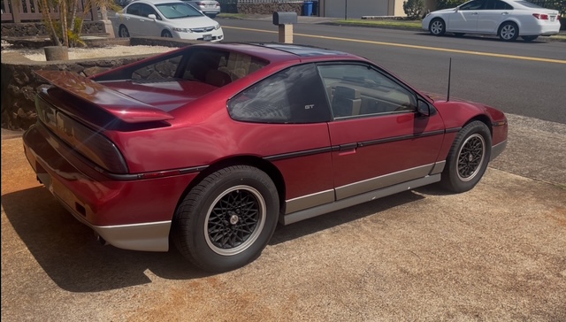

I can't believe it's been over 17 years since I last came to this site. Really happy to see it's still here! I had to sell my last Fiero and had moved on... UNTIL...
An '87 GT 5spd came up locally on FB Marketplace. I watched it for a month telling myself I didn't "need" it... as it came down in price from $12k, $10k, then $8k. The Universe was calling so I had to go look at it.
It's crazy how this deal fell together. I was in a class for work and the car was parked in the same parking lot I was in. He declined my initial offer due to another buyer, but that kid couldn't get his finances straight. I ended up buying it for $7k. Car was originally sold in Minnesota, and came to Hawaii via North Carolina. 186k on the chassis, reported 40k-ish on the engine (see below)
The more I look it over the more I really like it, and the more I see little things I need to address:
It's pretty well loaded with power windows/mirrors/locks, A/C, cruise control, sunroof... and a factory subwoofer I didn't even know was a thing! LOL!
2 owners ago swapped in a Camaro 3.4 with headers and full exhaust but also a stock Fiero intake. Yeah, it hits a wall just over 4,000.
Poly bushings on the cradle are a nice upgrade.
Front brakes are converted to GA vented disks but are worn out. New drilled/slotted will be going on. I've read about the concerns with the GA swap and I get it. My main issue is the rotor center bore not being perfectly sized to the Fiero hub, and it seems the hub isn't long enough for the wheel to be supported. The wheel looks to be completely supported by the lug studs only. Need to address that.
Oil pressure drops to 0 as the engine warms up. It does not exhibit a single symptom of low oil pressure whatsoever. I've read about the pressure sensor issue and have parts on order for an '88 Fiero for a swap. I'll also be double checking with a mechanical gauge for peace of mind.
Cruise is inop, add it to the list.

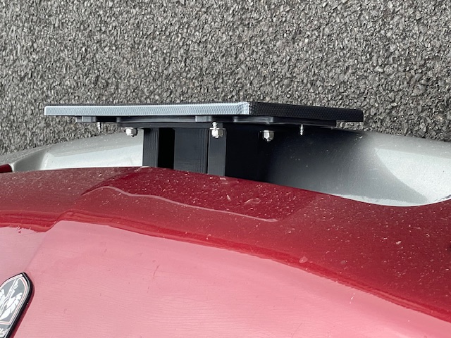

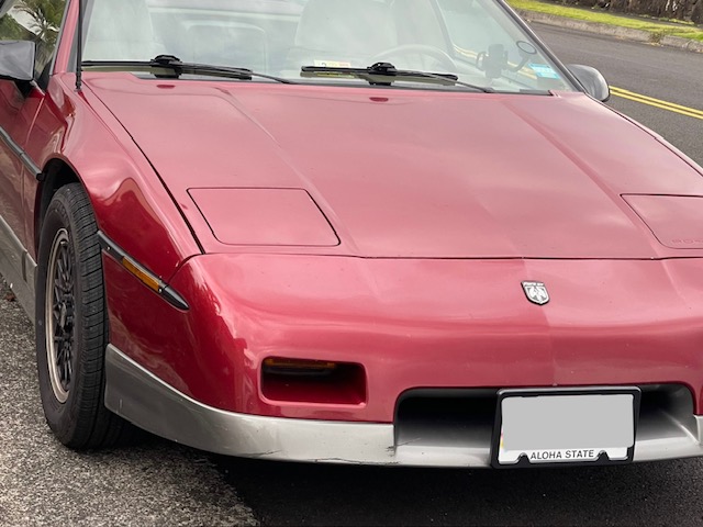

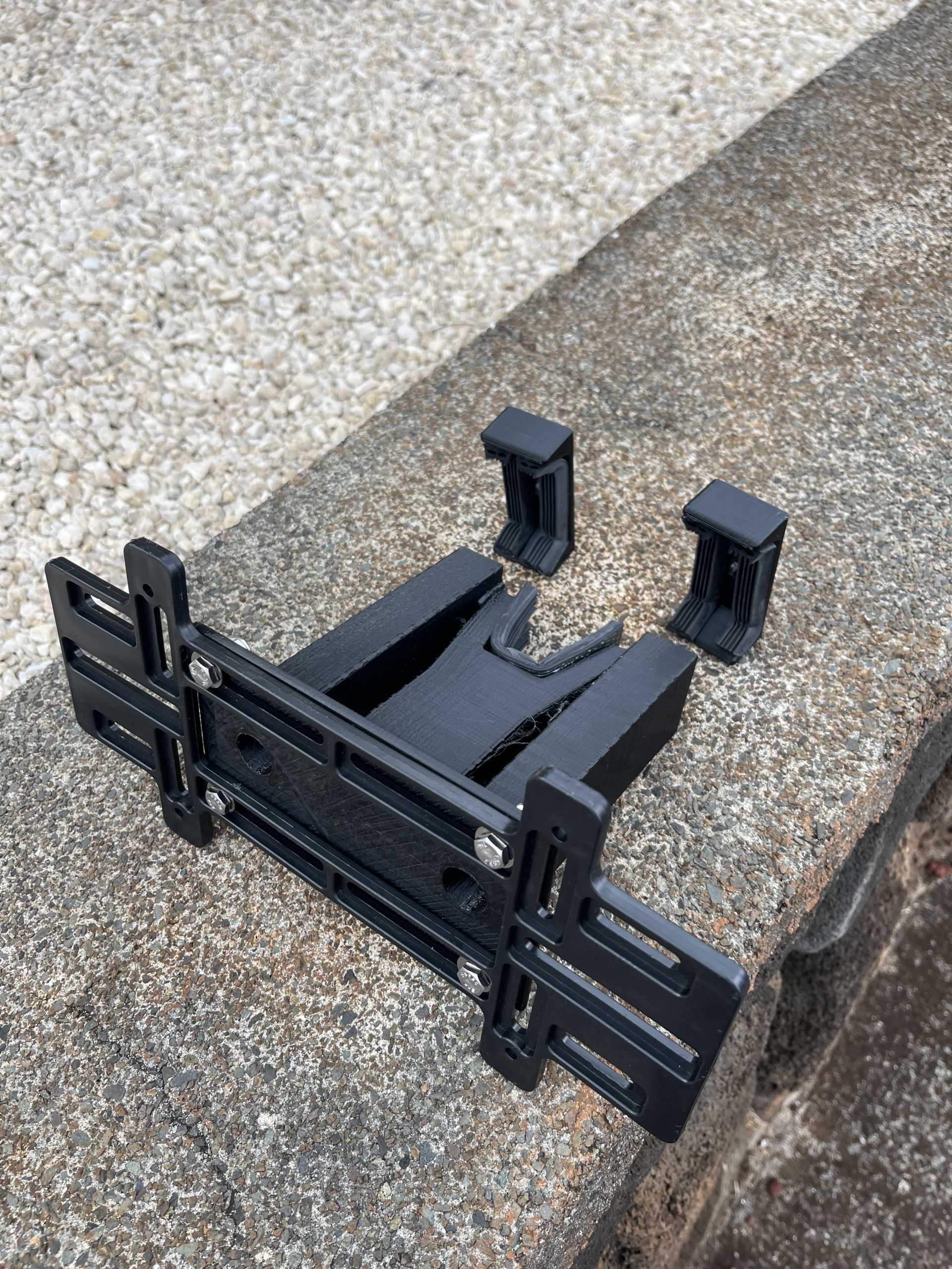

One thing it didn't have was a front license plate. Looking on like it seems they're tough to find under $200 shipped to Hawaii. No thanks! I fired up the ol 3D printer and after a couple of prototypes came up with a working model. It's not perfect, I'm a total novice, but it works. I already have plans to make it better. Seems to be a theme with these cars and their owners!

Here’s a pic of the plate holder its self. I learned Fusion360 from YouTube while I was on my ass for 6 weeks. I’ll get better eventually

| quote | Originally posted by Chad87FB: Here’s a pic of the plate holder its self. I learned Fusion360 from YouTube while I was on my ass for 6 weeks. I’ll get better eventually
It looks great. Just make sure it's not PLA or it will melt/warp in the sunlight.[This message has been edited by IMSA GT (edited 04-05-2025).]
100%! The PLA prototype warped while sitting in the front seat LMAO! This one is PTEG. Haven’t been able to get ABS to stick to the build plate on my old Robo3D R1+ without warping.
