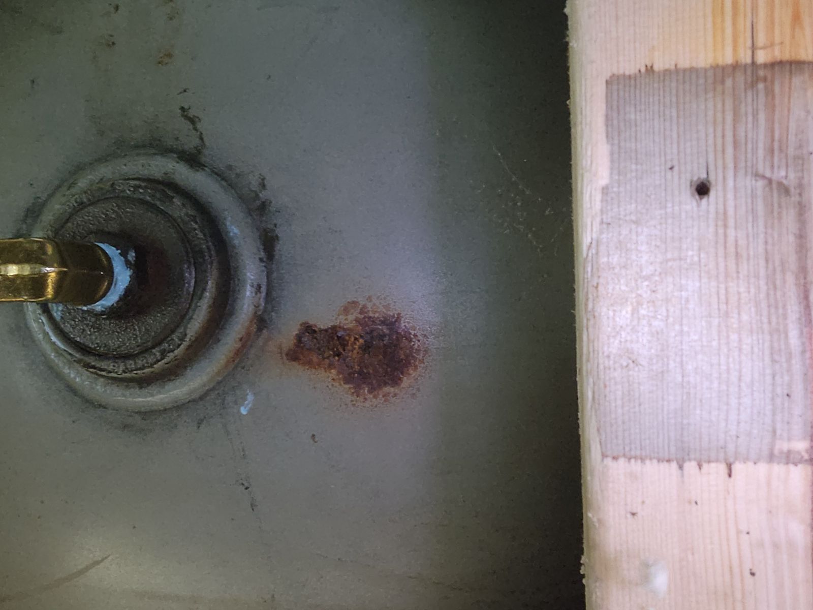

Thought I'd start this off by an issue I'm having to deal with.
Many of us have used tools in various ways, I'm sure as well not always the correct way, but what about the tool is unfit for service?
In my case the receiver for my air compressor developed a silent leak. I say silent because I usually have a radio on and the torpedo heater is way louder.
Here's the issue from the bottom/hidden side of my compressor
Thankfully I caught this before it ruptured and I can tell you it doesn't take a lot of pressure to harm anything.
Stay safe y'all

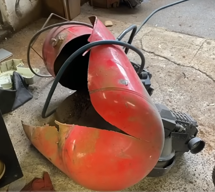

One of the Youtubers had a rusted out tank. He was lucky but his garage took a huge amount of damage.
 [This message has been edited by IMSA GT (edited 01-15-2025).]

I've seen worse at just 60 psi, regardless I'm sure there are more.

Was a guy local that had an old 26 gallon Air compressor tank explode. Thank fully he wasn't in there when it blew. Blew The garage door out, windows and the one side off the foundation.
Thank you for posting this, it's reminded me something I have been meaning to do, put a bore scope in my compressors air tank's. I have a 30 and 50 gallon compressor's, don't want them blowing up at 120 psi[This message has been edited by jelly2m8 (edited 01-16-2025).]

It is important to drain the water which collects at the bottom of the tank. Regulary.
All have drain valves such as a car radiator has.
cliffw
JAN 16, 12:47 PM
Did that rust from the inside outward ? If so, I would discard it.

A couple of years back my air compressor of nearly 20 years developed a pin hole leak n the bottom in a similar location. Some were suggesting I weld it up and get more life from it, but I just went and picked up another one and sold off the old one for parts.

JAN 16, 07:04 PM
Did that rust from the inside outward ? If so, I would discard it. |
Yeah this is from the inside out, also agree and did drain it daily since I owned it. Got it used from a small business. The boiler stamp year was 1998. I don't know how many hours this unit had but I'll just say I was fortunate as it was pressured up a few days ago. I tried getting my boroscope in for a look it's just not bright enough to do any good.
Not sure if I'm gonna get a replacement tank or swap the whole thing out. Checking prices today YIKES, at any rate this tank is headed to a recycle yard soon.
