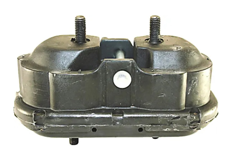

This is a solid motor mount from a Fiero V6 and L4 (seems all years):

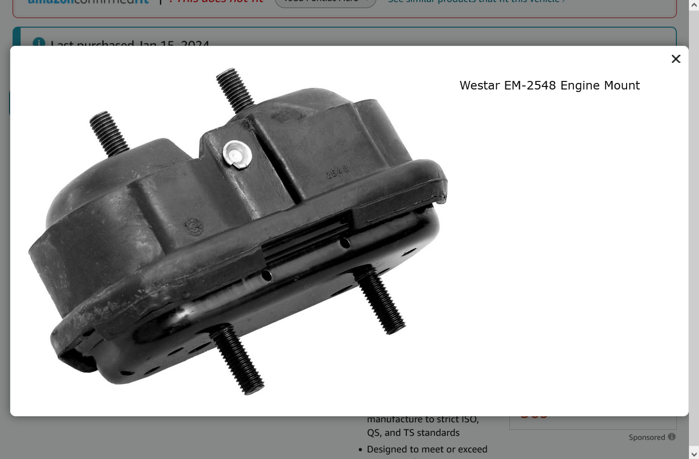

And this is a "Hydraulic" motor mount from a Fiero V6 (88) and L4 (87-88):
From what I can tell, they appear to be totally identical in the way they mount to the frame and the engine bracket. I just ordered one on Amazon for $28 bucks.
Best I can figure, the biggest difference is the ability to dampen vibrations better than rubber, and reduction of harmonics across other components.

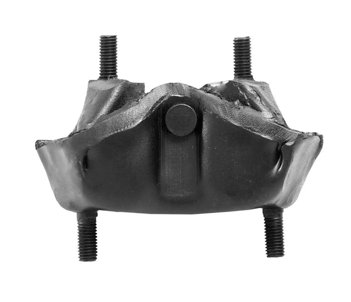

There is a solid rubber motor mount for the '88 V6 (engine bracket is different from previous years). in April I installed this:
It's listed for 86-88 Fiero and others on RockAuto; Amazon says it does not fit. But it is a perfect direct fit. I have it with rubber tranny mounts and a poly dogbone, and it works just fine.[This message has been edited by OldGuyinaGT (edited 08-17-2024).]
