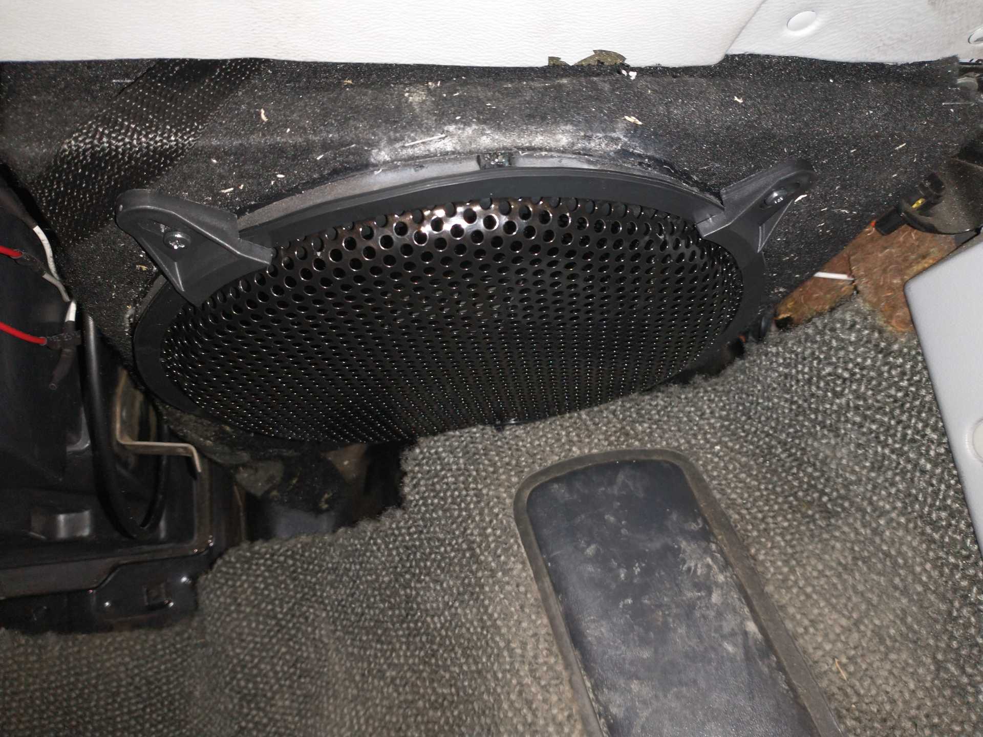

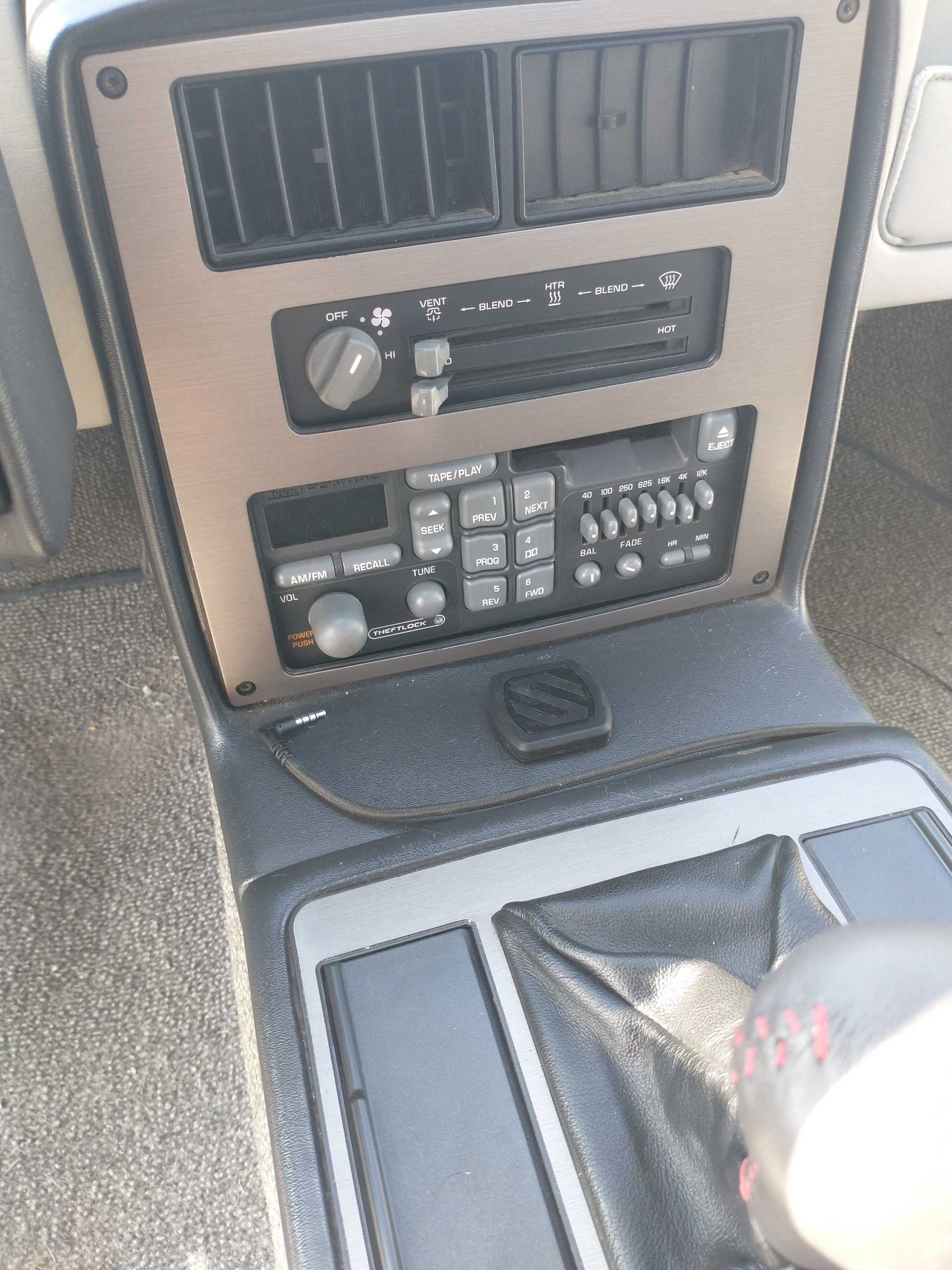

I have a pretty good system, much much better than factory, and everyone who hears it loves it, I have Rodney dash speakers, pioneer 4" 2 way speakers in the headrests (wired in series instead of factory parallel to account for ohms difference), I built an enclosure for a cheap 10"sub under the dash (no AC, with AC max is 8"), and I run a 90s Pontiac cassette radio, with a hardwired aux port (with microphone in cluster and cruise control button controlling play/pause like a headset), sound is great, can get plenty loud, but I have it tuned nice and flat, like it's intended, sounds great!
