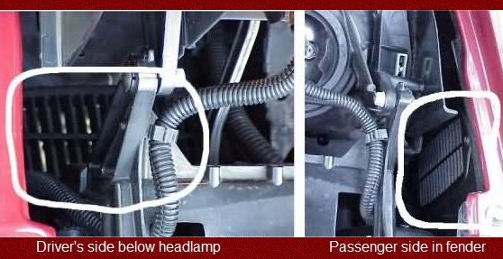

Sorry for the crappy pic but I had to enlarge the only one I could find. People add vents to the headlight buckets and they supposedly work great.
1985 Fiero GT
JUL 14, 02:45 PM
Ok, interesting, I vaguely remember reading about those, thanks for the pictures.[This message has been edited by 1985 Fiero GT (edited 07-14-2024).]
I'm looking to do this mod after I lost my headlight covers due to a semi (on a windy day going while driving about 65mph) passing me in the opposite lane. I've seen the vents placed on the bottom of the bucket, wonder if more effective on the side?
