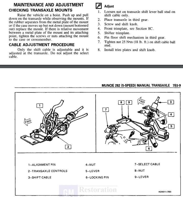

Before doing all that, try adjusting your shift cable, if you haven't already. If it's mis-adjusted, it can cause the trans to jump out of gear.
Basically... start in neutral. Loosen the shift cable nut, at the trans. Shift the trans into third, by hand. Go to the shifter. Move the lever to third gear. Place a pin or drill bit through the shifter arm and the base, to align the front rear motion. Tighten the nut on the shift arm at the trans. Remove the pin.[This message has been edited by Raydar (edited 02-23-2024).]

Hm….I’ll have to give that a try. I did notice the other evening that the shift cable nut was very loose. And by very loose I mean I was able to spin in by hand. I just tightened it back up but didn’t pay any attention to what gear it was in. Hopefully this will solve the issue.
Working on this this morning and a little confused about exactly where you place the drill bit or pin. Is this at the arm on the transmission side or inside the vehicle at the gear shifter side?

Oh I think I figured it out…..I have Rodney’s short throw comp shifter and it doesn’t have this hole in it to be able to pin into 3rd gear.

Makes sense, you'll want to reinstall the stock shifter arm to adjust the cables, then reinstall the short throw shifter.

Yes that’s what I ended up doing. So then I went for about an hour long drive. Many starts and stops. It didn’t pop out of gear not one time. I came home and parked it for about 30 minutes. Went to go for another drive and it started doing it again. It’s a definite improvement than what it’s been. It went from about 75% of the time popping out, to 0% to about 25%. I recently replaced the clutch slave cylinder and bled it using Archie’s method. Is it possible I may need to bleed again?

Popping out of gear won't be in your hydraulics. It's mechanical and you're working in the right area to correct it. I had the same problem when I swapped transmissions and it turned out to be that the cable wasn't properly adjusted when the swap was done. I followed Raydar's instruction sheet and resolved the issue.
When I place the shifter in 3rd and pin the shifter, I loosen the cable nut then grasp the transmission shift lever and move it forward and backward, feeling for it to settle into a detent of sorts. I feel that's properly engaged in the gear, then I tighten the ball stud nut. Of course, you want to be sure the square shoulder of the ball stud is seated properly in the transmission shift lever.
