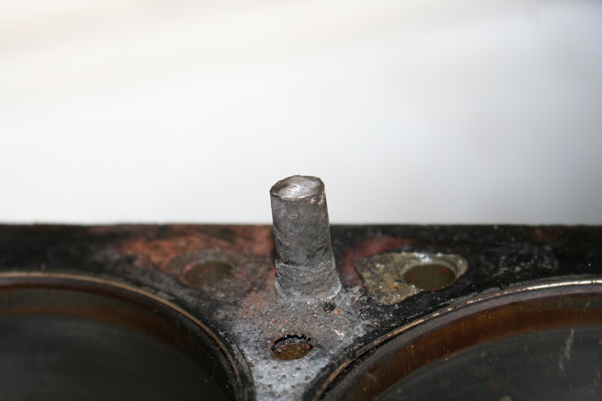

First... one of the cyl head bolts in the middle of the cyl head broke. THANKFULLY... it broke with almost an inch of it sticking up out of the engine. I wasn't expecting a bolt to break off of the block... not sure how this happens, but this is a first for me.
I'd normally hit this with some heat, clean it up and spray some PB blaster and then attack it with vice grips and a pole... however, after looking at the cyl walls... I'm just going to let the machine shop mess with it. The cyl walls are actually not that bad, but the engine clearly has some 120k miles on it, and there is a little bit of a ridge where the rings stop. I'd probably hone this myself, but I already have a set of .030 overbore pistons that I bought, so I'll just have them hone and bore the engine block when they take care of the bolt.

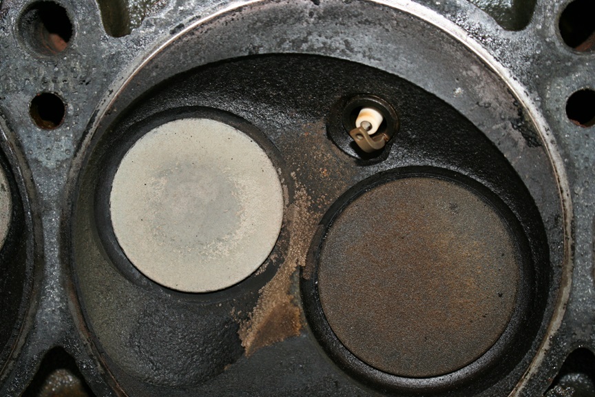

Combustion chambers actually look pretty good... there's obviously some carbon deposits, but none of the valves look burnt.

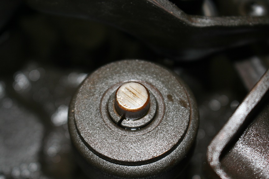

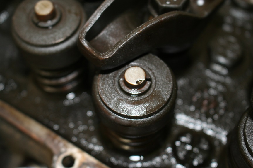

One thing I did notice though when we were removing the pushrods... the tops of the valves look like they're coming apart. These are the two that are the worst, but some of the others were in varying states like this, a lot of scoring... didn't look like the valves were rotating as they should. Any idea what causes this? It's kind of weird... I've never seen chips break off of a valve stem before...
I'm obviously not going to re-use these, so I'll replace them. I wanted to ask your guys' opinions on two things:

Hi Todd; The valves are going to be new so get the machine shop to check and or replace the guides. Then grind the seats so they are concentric. Retainers and keepers are ok but springs are cheap and should be replaced. the shop will check head for straight and resurface as necessary. The chipping is from loose rockers bouncing on the valve tip. sleek
