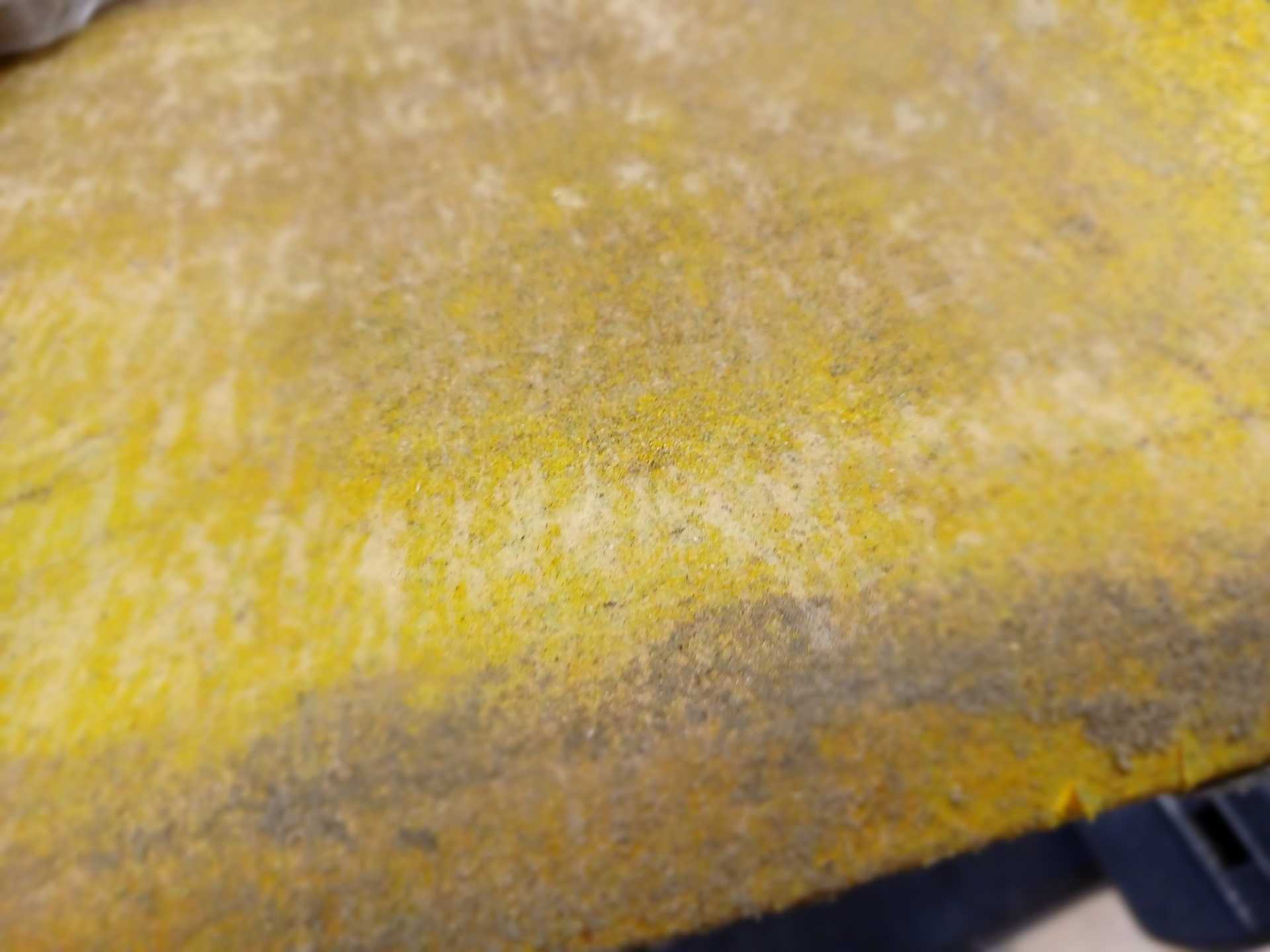

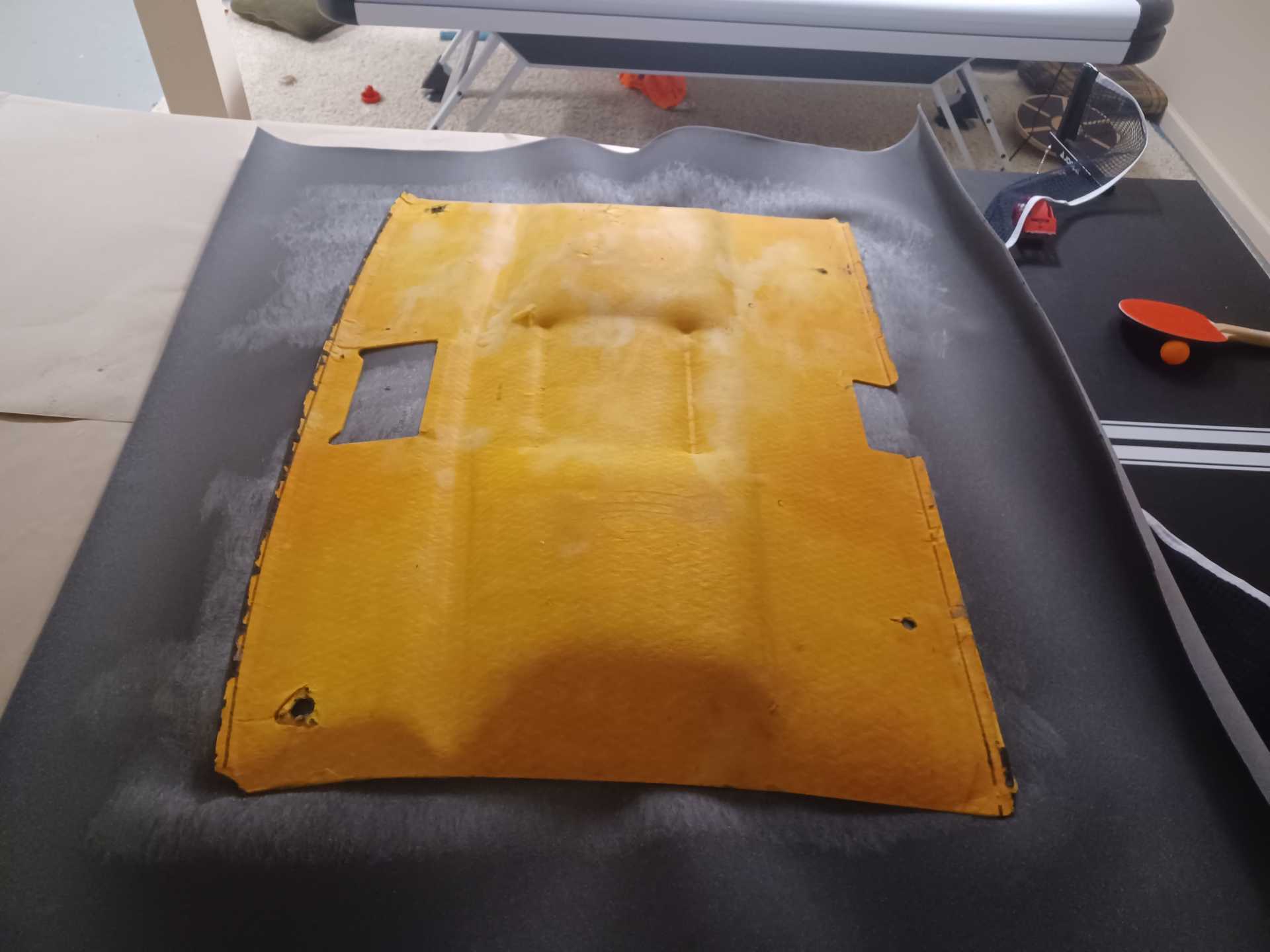

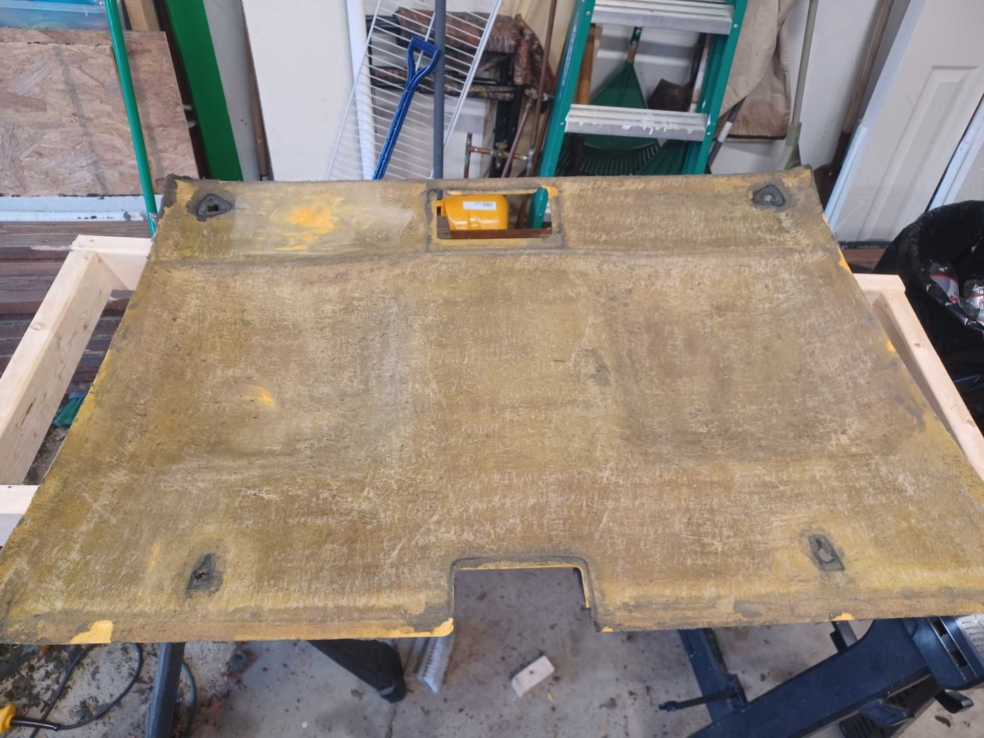

I had a sagging headliner that got worse and worse until I couldn't take it anymore and decided this spring it was on the project list. I've got it out, my board seemed to be in pretty good shape.
My question is, how far do I need to go in removing glue residue before applying new glue and sticking the material on? I've got most of the headliner fabric and foam scraped off, but it's still kinda rough to the touch. The one spot where it's more yellow than the rest was where I got brave with a power sander. Second picture is the top side for reference.
So basically, do I have to get it all the way down to the yellow?

The 3M High Strength 90 spray would probably be best but make sure to coat the board and the backing of the new headliner material thoroughly. If you use a true contact cement, my fear is that if you make a mistake or want to change it later, you'll destroy the headliner board trying to pull the material off of it. [This message has been edited by IMSA GT (edited 04-09-2023).]
APR 10, 07:20 AM
3M 777 spray adhesive.
Only coat the headliner board.
Your headliner board looks great!

I agree, your board is in comparatively great shape. Not cracked like my first one was. I had to patch a few areas with fiberglass cloth and resin, and then of course I had to sand those areas even more. In my naivete I assumed the new fabric would hide all manner of imperfections. It didn't. I could see every flaw. I also made the mistake of bunching some of the fabric into the headwell areas and that caused wrinkles. Si I searched the junkyards for a year and found another headliner board ( a much better one this time) and did the job a second time. It came out just about perfect.
hyperv6
APR 10, 01:28 PM
The board looks good. Just get the foam off and make sure it is mostly smooth. That is all you need.

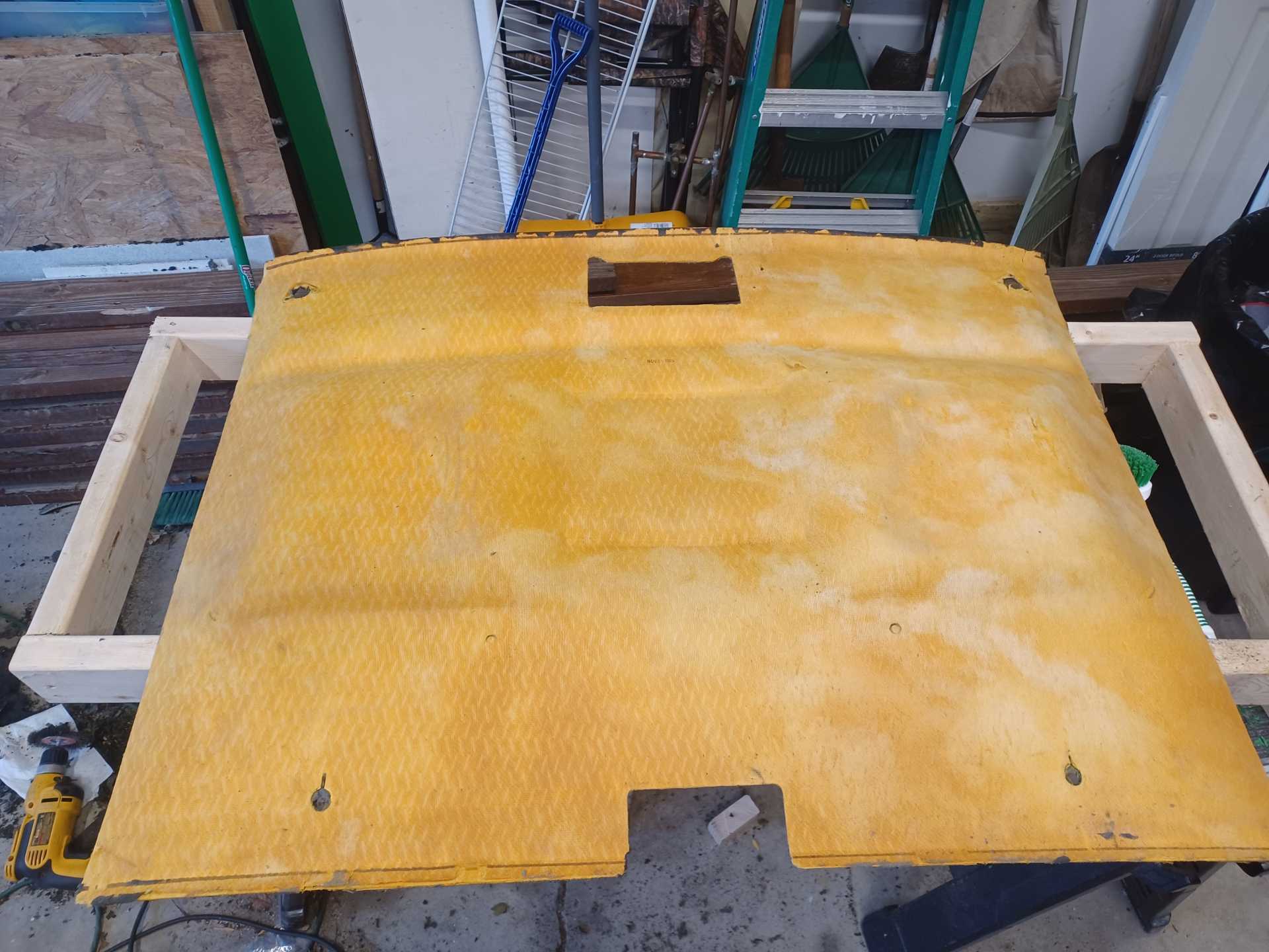

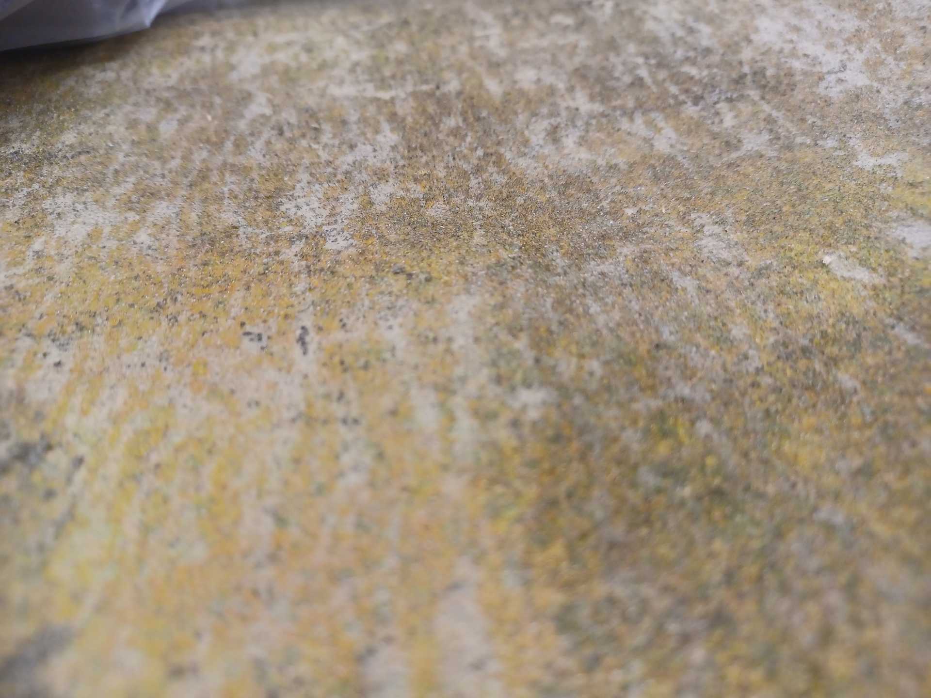

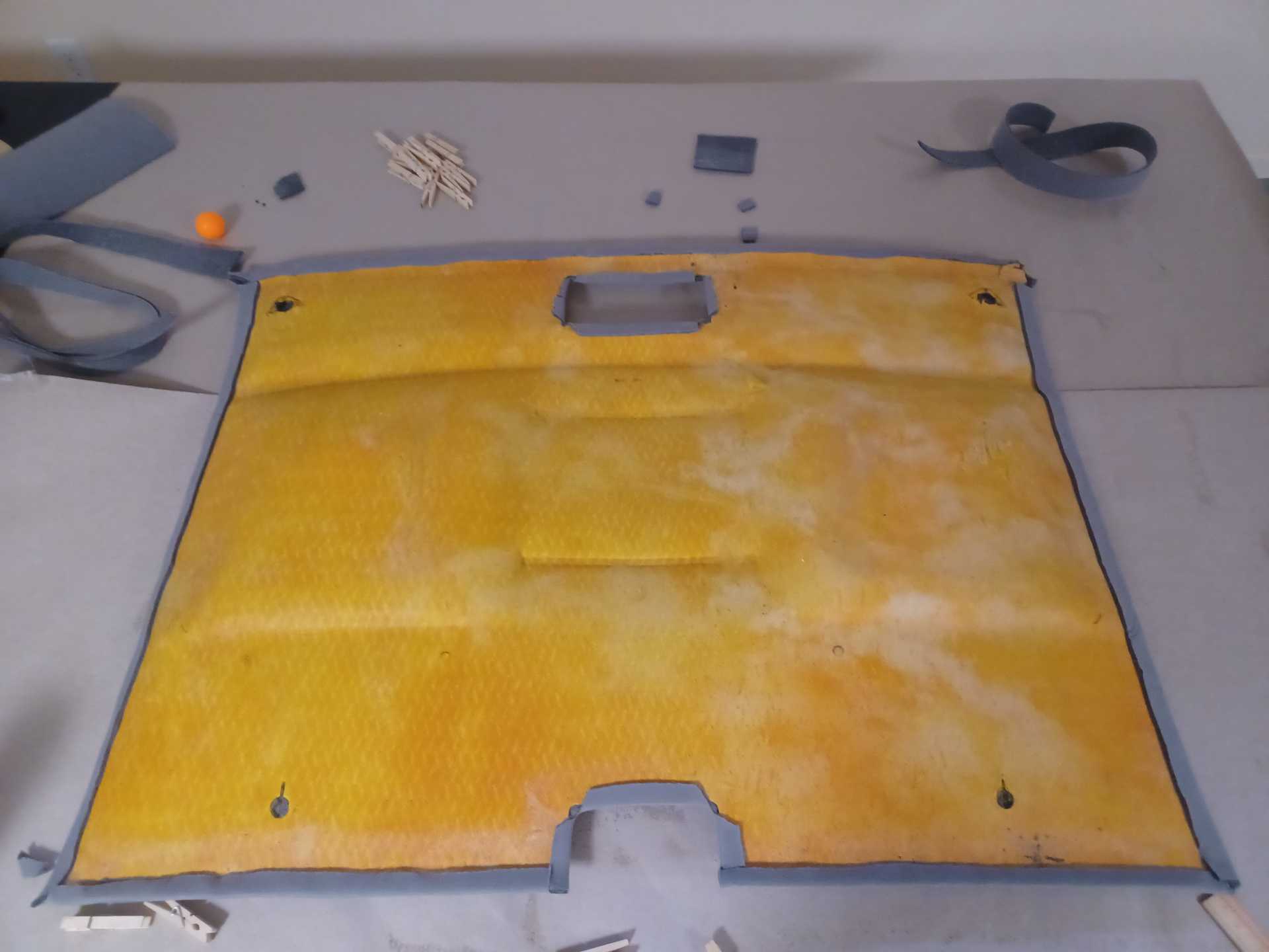

Here's where I'm at on the board. I've got the foam backing off. I was able to scrape it with a stiff bristled nylon brush. I think I'm settled on using the 3M spray glue as recommended by the folks that have commented. Here's some pictures of what it's looking like. It's till got some texture to it... likely 40 year old glue residue. Do I need to take that all the way down to the yellow to get a good result? Or am I ready to go?
Thanks!

Scrub back original with hard brush and cover with new foam high temperature adhesive. I used a real suede skin that i had which was large enough and it looks brilliant.

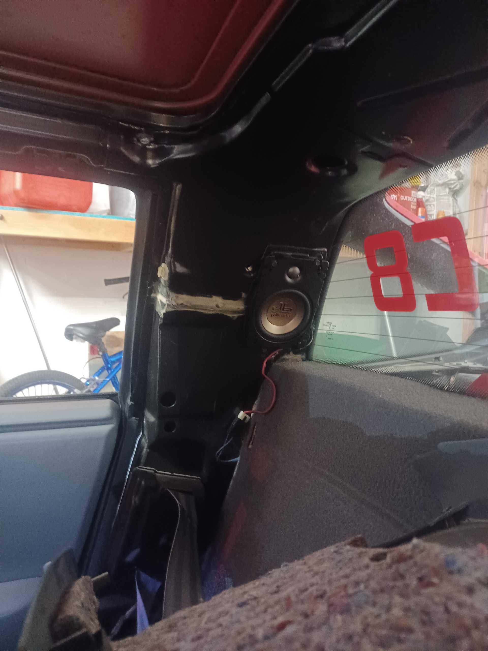

- I had easy access to the rear 4x6s. I have the performance subwoofer stock and the sound is decent, but I figured no sense having easy access and not updating. I replaced with Polk plate speakers.

A little late to the party, as usual, but when I was trying to remove my adhesive, I just put on a nitrile glove, and wiped the surface until nothing else seemed to want to come off. It looked a great deal like the 1st pic.
