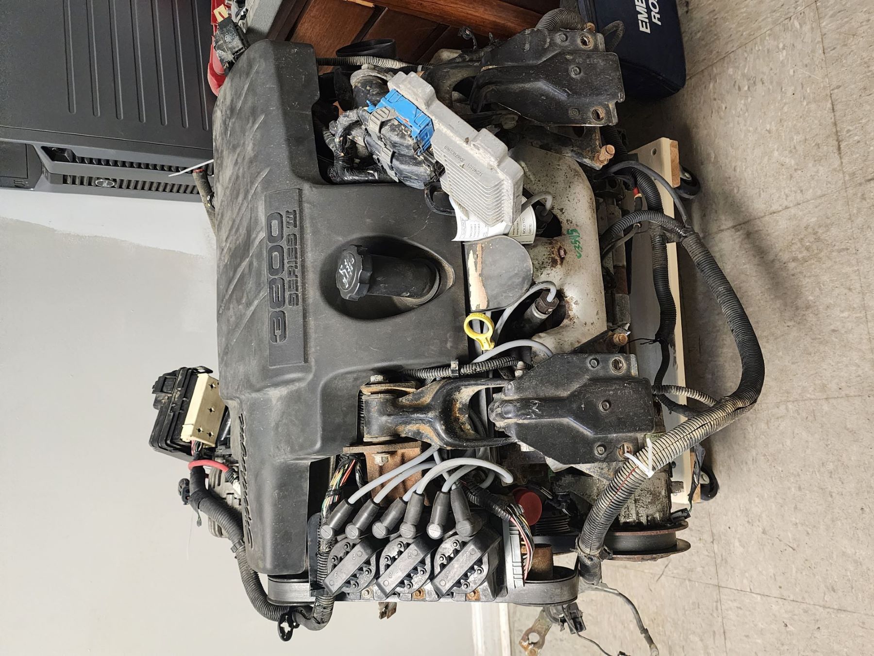

The 4.9 has been parked for 10 years while I messed with a couple Mercedes. Though I love my S55 AMG, I have been itching for a fun project. Looked at different ideas, and kept coming back to the Fiero. Last week I bit the bullet, and this showed up today.
 2007 GTP complete drop out. I have a few decisions to make about the build, but do know I will be doing the cam, lifters, timing chain, pulley, injectors and E85. I will be doing a leak down and bore scope over the next few days to decide if I am pulling the heads or not. Not sure if I am keeping the DBW, or going to a cable TB. I guess a lot depends on a conversation with a PCM tuner. After that is decided, I will completely separate the old harness and build the new one. I see a lot of older threads, but who is currently doing PCM tuning?
I did make it this far today.
This will probably be a six month build, due to just closing on house so money is tight.[This message has been edited by scrabblegod (edited 02-08-2023).]

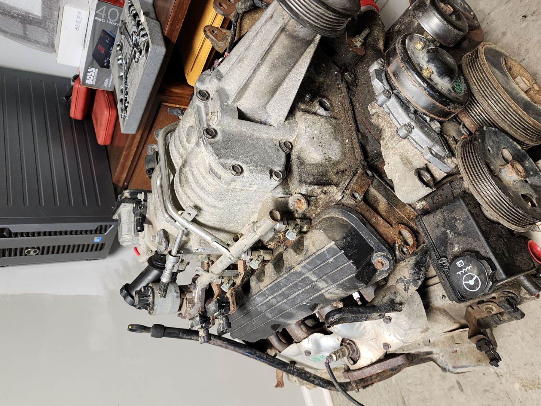

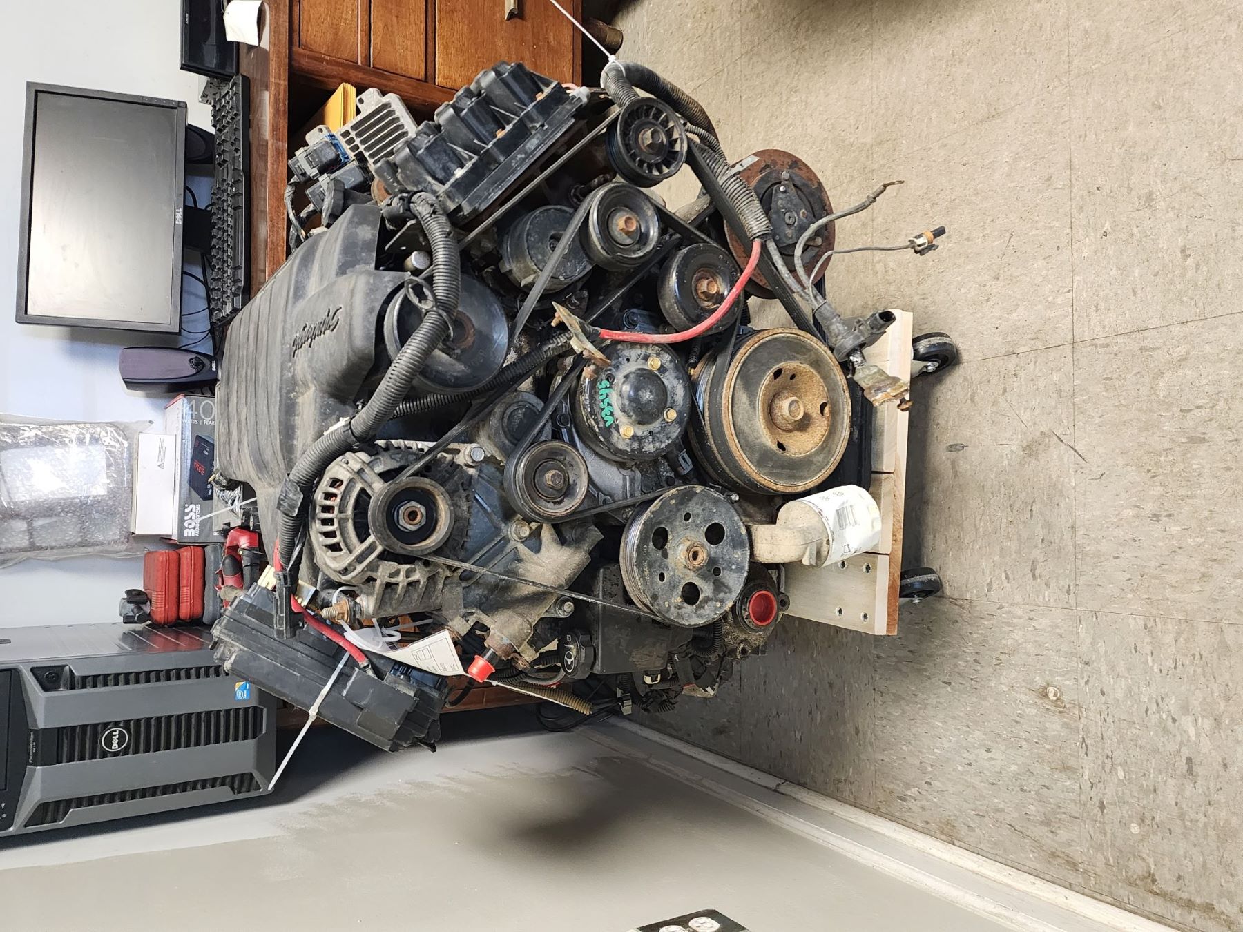

This engine has 120k on it. I am in the used parts industry and bought it from a yard I trust. Also saw a video of it running. Stuck a bore scope in it today, and it looks great inside. Plugs have some of the best burn patterns I have seen. Pulled the valve covers, and it is spotless inside. I will do the leak down test this weekend, and if it is good, I will not be pulling the heads like I had originally intended, since I can replace the valve springs with the heads on.
