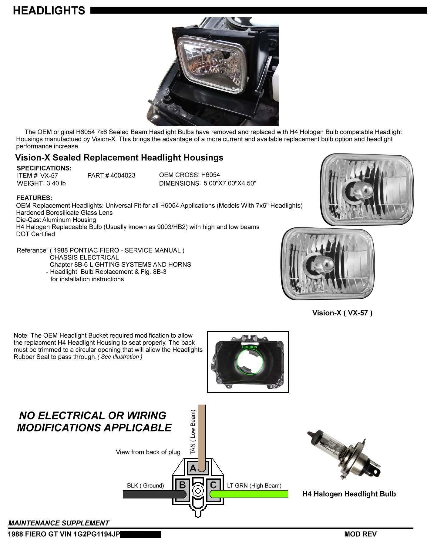

I replaced my OEM headlight bulbs with H4 Halogen Bulb compatible housings. The ones I got are made with a glass lens (not plastic) and are DOT approved. They look nice, much brighter and I can easily find replacement bulbs. I have a pic of my notes with more information
