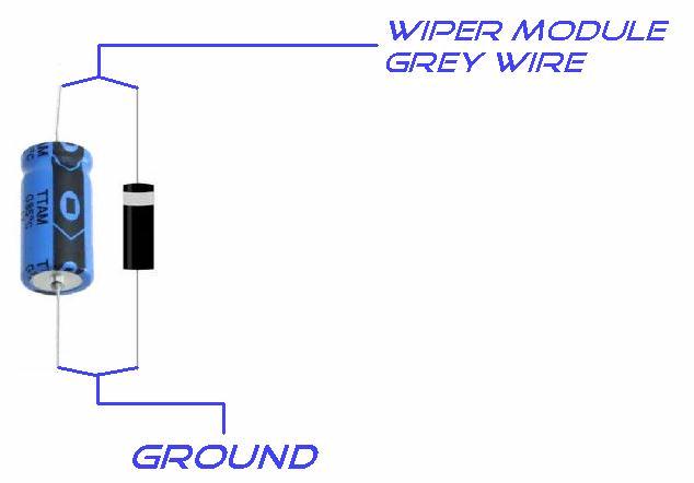

The wiper fix is a few bucks to make. You need a 250 microfarad capacitor and a diode. Here are the parts and schematic:
And a simplified view. You can see how the 2 items will fit together side by side inside the proper size shrinkwrap.

Thanks IMSA!  I looked through my parts drawers and found some 220 UF / 100 volt caps. Will these work or must I have a 250 uf cap to get the job done? As for diodes, I have some IN4004’s on hand but those are probably too small. Kit Thanks, Kit[This message has been edited by Kitskaboodle (edited 08-16-2022).]
IMSA GT
AUG 16, 10:39 PM
The voltage of the capacitor can be higher but the microfarad rating should be the same for it to work correctly so I don't think a 220 will work.
Kitskaboodle
AUG 16, 11:58 PM
Understood on the 250uf minimum requirement. Last question: can I go higher in UF? I found some 330 uf / 50v. Will this work? Thanks again! Kit[This message has been edited by Kitskaboodle (edited 08-17-2022).]
cyrus88
AUG 17, 12:55 AM
Don't sweat it. Use the 220 and test and see if it solves ur problem.
