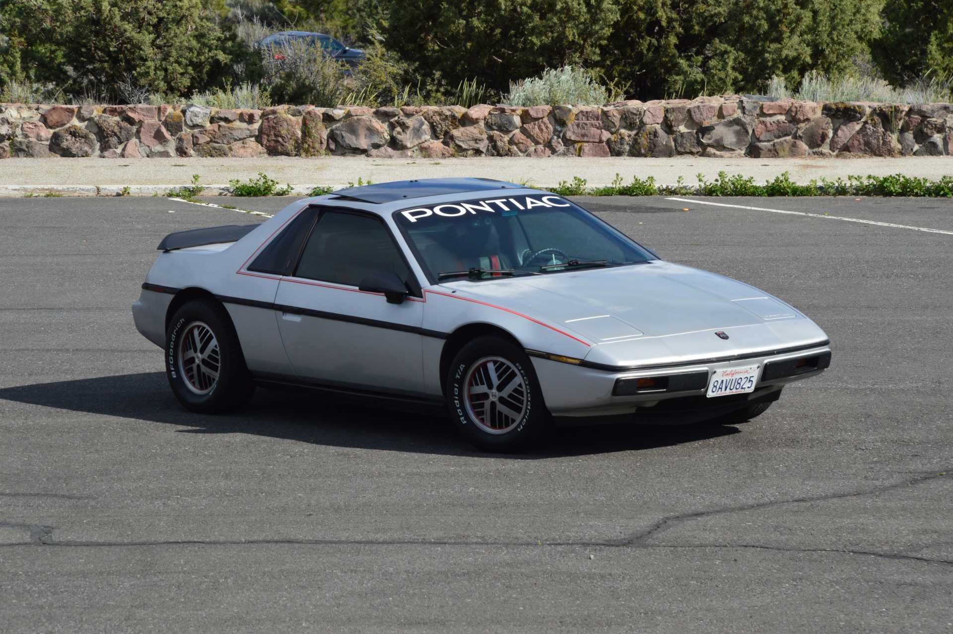

Welcome to the Fiero family! I also use an 86 Fiero as my daily commuter. She has 230k miles, but I swapped in a low mileage V6 a about 5 years ago which only has 200k on it My daily commute is pretty lengthy at 150 miles and I actually made a video about it a few years back explaining why I think the Fiero is the perfect car for the job: https://www.youtube.com/watch?v=trD7hF8SHdU.
Here's a recent shot of her:
I hope you will enjoy daily driving your Fiero as much as I enjoy mine! Also, looks like you have found a real nice one, it looks beautiful!
