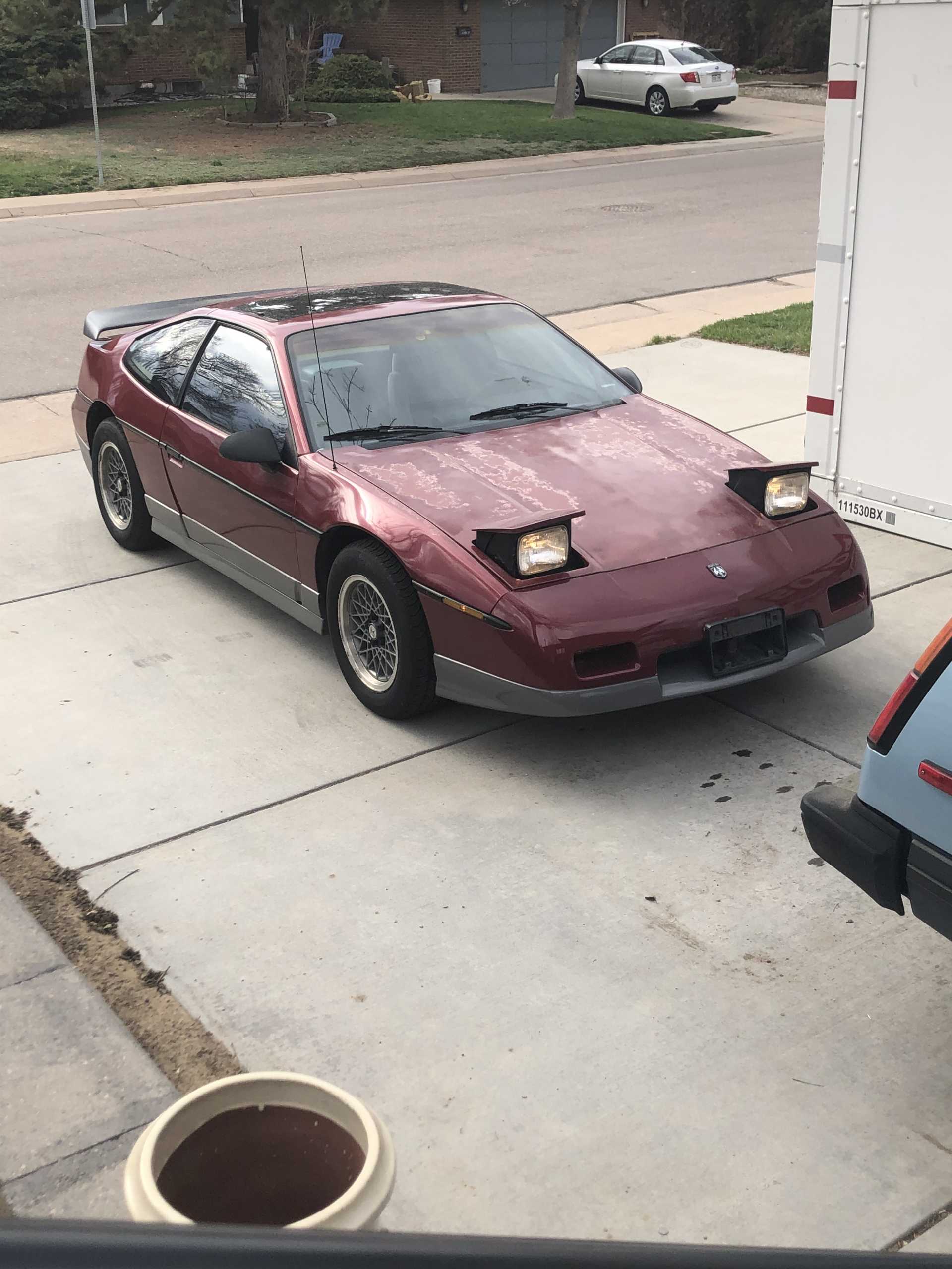

To start off Im new to the forums but I've had my Fiero for almost 2 years now. I originally wanted an MR2 (I know I know, how dare I mention the fieros biggest rival in a fiero forum) but I drove the car I have now and thought it was way cooler and felt way better to drive so I bought it. It was all original with 55k miles and came from Denver. It was honestly probably the cleanest cars I've ever bought.
The only issue it had and still has is it appears the 3rd gear synchro is just a little slow. If I try to hit 3rd too quickly it can grind slightly but as long as I don't try to bang 3rd like a 17 year old in an EH civic, it works just fine and hasn't gotten any worse since I've put 10k miles on the car. The first thing to address was changing all the fluids. Not having any service history I have no idea when it was last done and by just taking care of it right away I now have a baseline. The coolant, oil, trans oil, brake fluid, and clutch fluid were all flushed. When doing the clutch I wouldn't get any pressure when trying to bleed it it. Further inspection found the slave cylinder to be absolutely wrecked. It looked like someone had taken a hammer the internals. I guess all the gunk in the old fluid was the only thing holding it together. I replaced the clutch master cylinder as well and flushed the lines because it was bad.

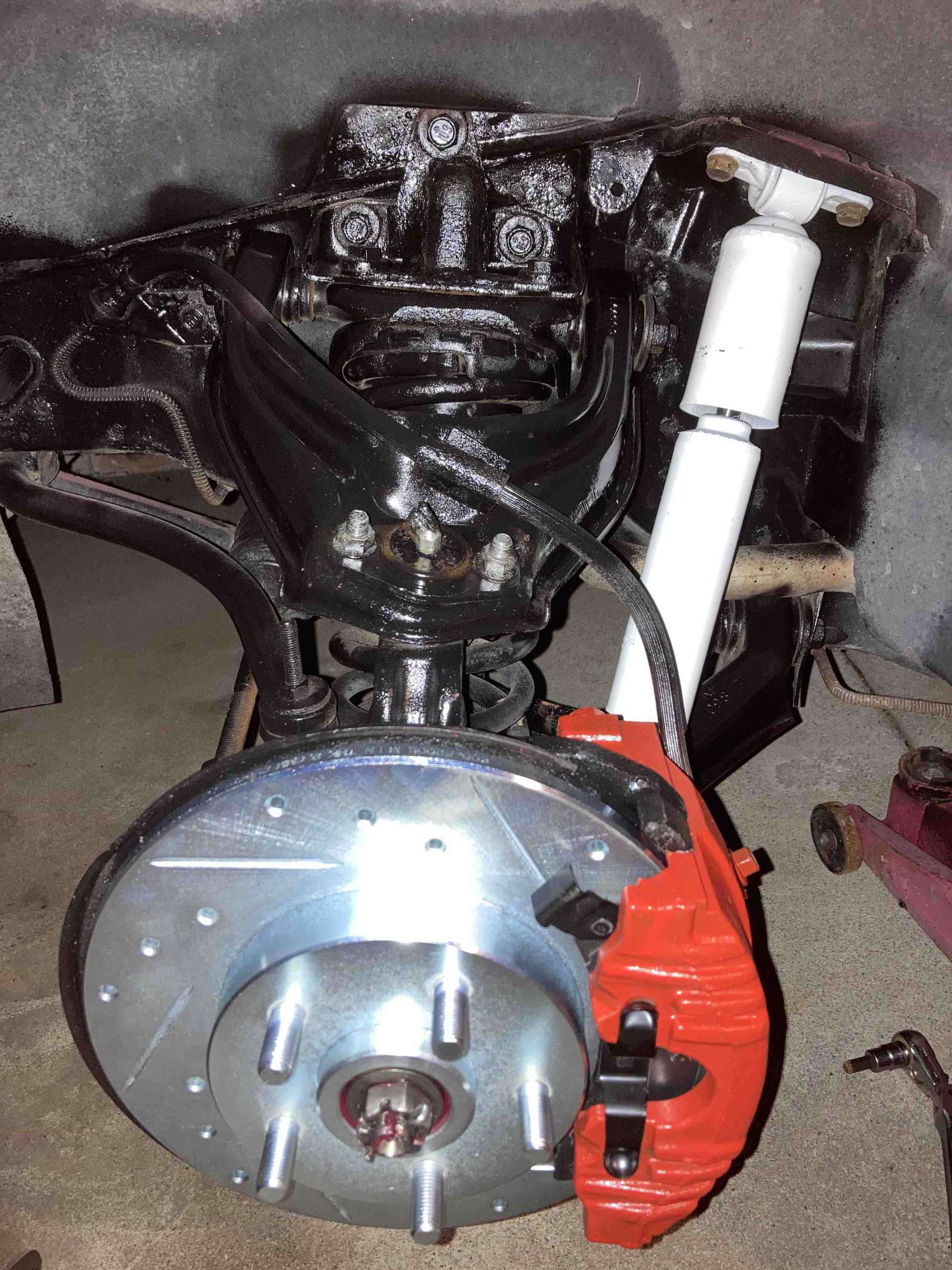

The next was suspension and brakes all the way around. I ordered a poly bushing kit for the car but when I tore it all down the factory bushings were somehow still in good shape so I left them. For being a Colorado car, the rust isn't too bad. I still wire wheeled, sealed, and painted all the areas I could get to keep it not too bad. new kyb struts in the rear and new monroe shocks up front. I did an R1 Concepts drilled and slotted rotor kit with ceramic pads. I know they aren't nessecary and i don't beat on the car but they are zinc coated so they won't rust and they look cool dammit! Also I couldn't help myself and had to paint the calipers red.

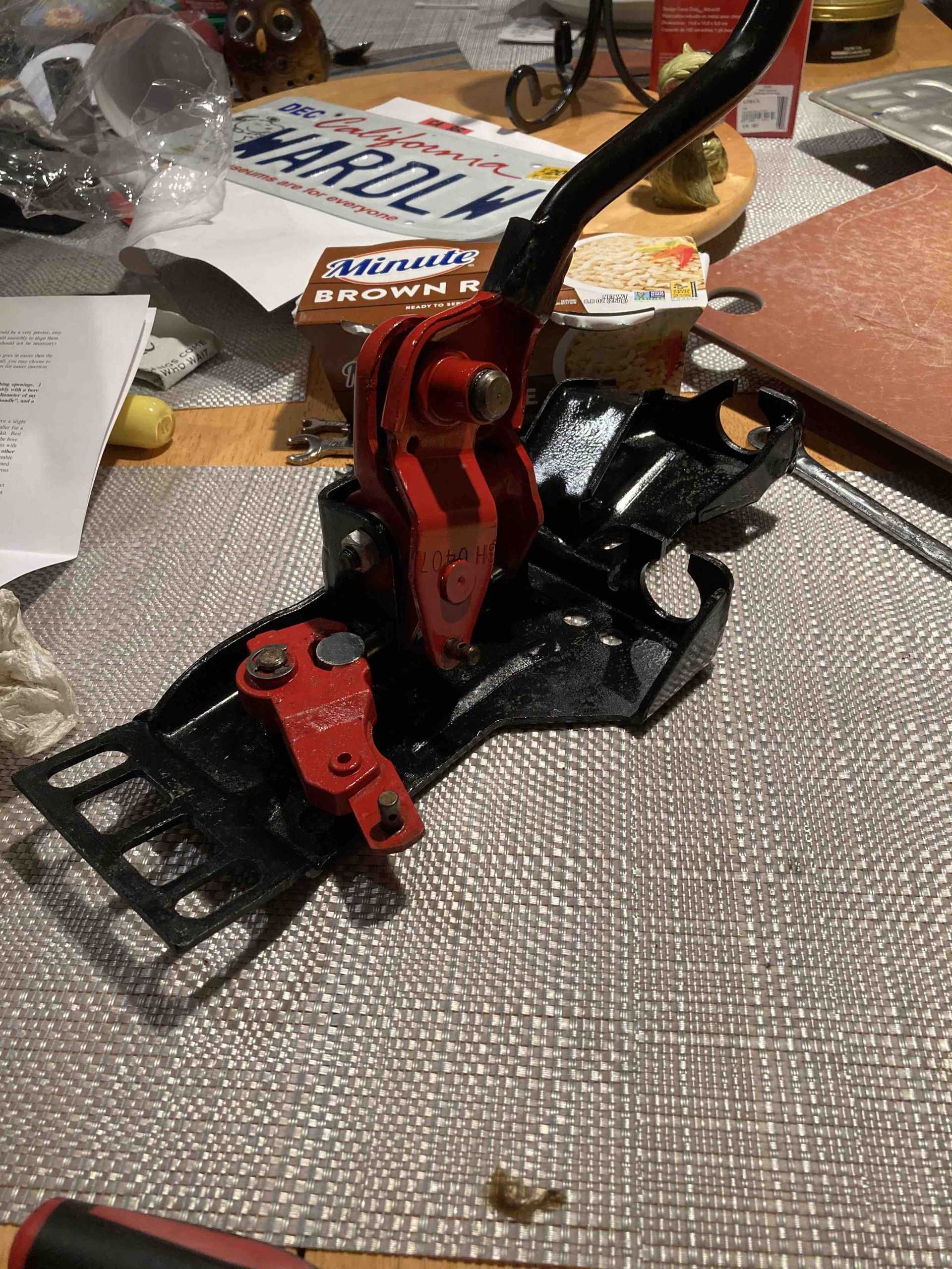

Ignore my terrible paint work. Its function over looks. After this the shift cables were in dire need of attention. I ordered Rodney Dickman cables, shift rebuild kit, and select arm shaft kit. While the interior was apart to do those things I took the time to re glue and the interior parts I took out as they suffered from the all to common vinyl separation.

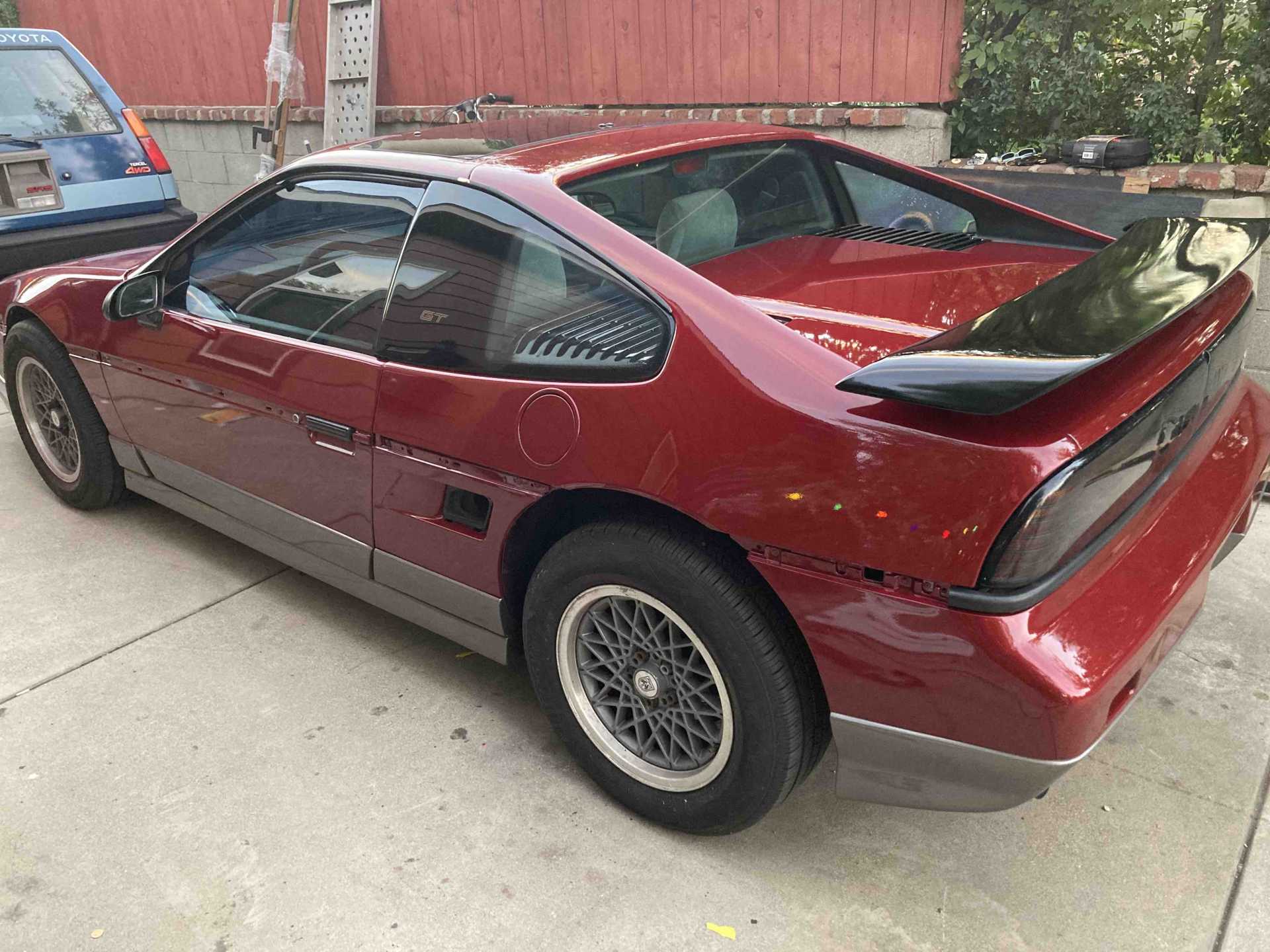

Final thing for now was to get it painted. I stripped the car down and sanded it really well and took it to everyones favorite, Maaco! Got the 2 stage paint option and used the original paint codes and wow, this local franchise I have does a really good job for the price, the masking lines on the 2 stage are absolutely perfect and the paint they lay down looks exceptional. Yeah there may be a couple specs of dirt and dust that landed in the paint but I always find the painter and flip them 50 bucks to really lay down a ton of clear coat so i have the room to go back and color sand and polish all the imperfections out.
My car came with its wing plastic dipped black and I liked the look of the black better than having it match the car so I had the body shop spray it black the right way and I love the look. All in all everything was looking great. The next thing I do are going to be the seats. Im hoping to find an original seat cover for the driver side in good condition but if not I do like the Mr.Mikes leather kit. Next thing is to throw away the 20 year old after market head unit which for some reason when ever it turns off, the driver foot well light turns on very dimly. The head unit just randomly cycles on and off. I have an original fiero head unit that i want to install, and hope it works. Im not an audio snob so the original head unit and a cassette adapter is just good for me.
