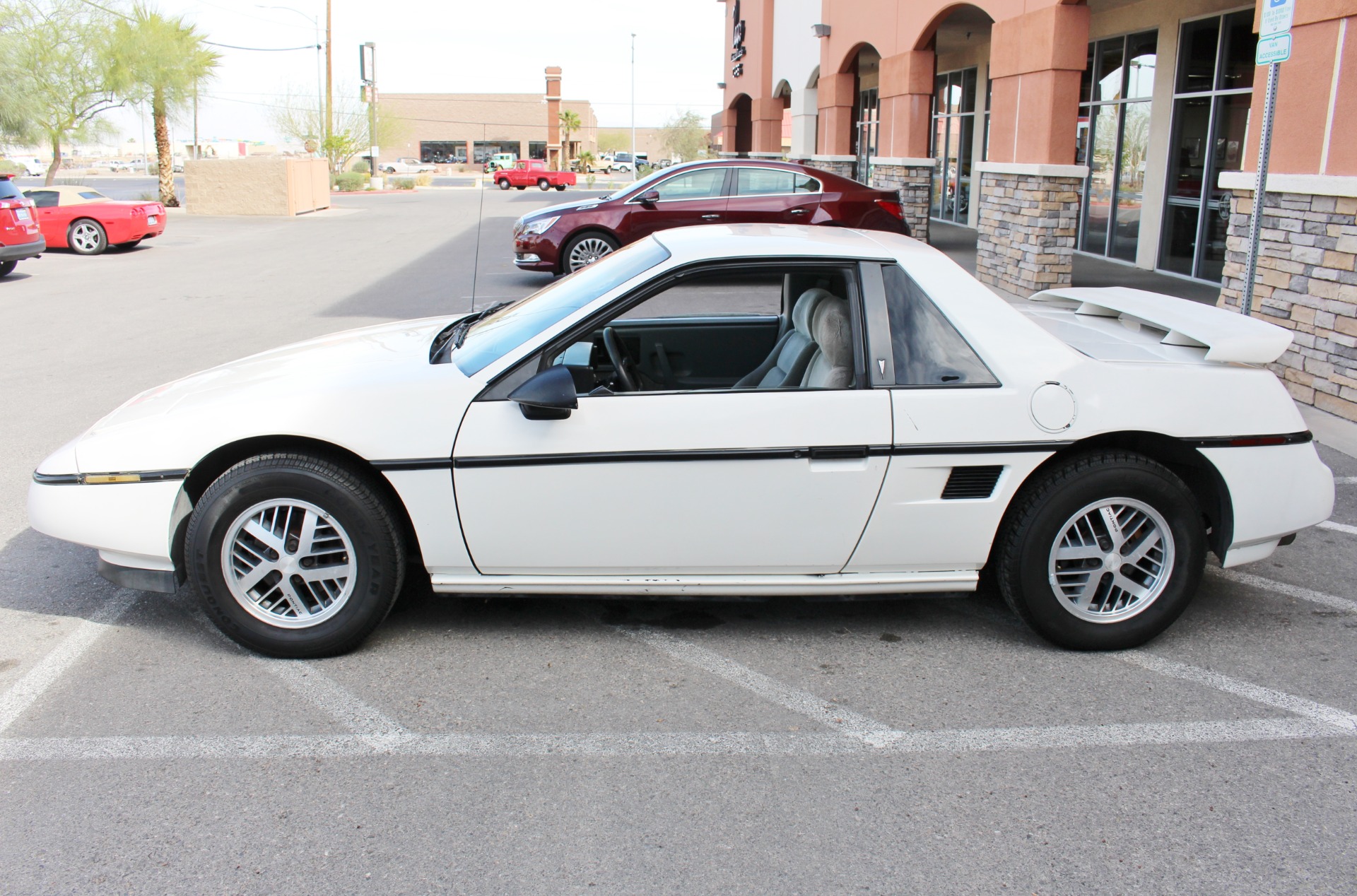

So I am purchasing a Fiero 2.5 model with only 78k miles on it, nice underbody and everything. However I am having trouble understanding something about it. The title reads that it is an 88 but every body panel points toward 86 or older. Could it be titled wrong? Could it be a car that was heavily modded with a kit and a later owner decided to make it look like a Fiero again and put panels from an older model on it? Thoughts and ideas?

The 87 had them too but because of how modified this is i would not bet on them. It has ribbed trim so whomever did this did a full front rear bumper replacement and did trim replacement (if it is in fact an 88) . Rear suspension alone would not say its an 88 as that can be swapped this is why i said check the front. Not many front suspension swaps done. I would also Check the door vin on the drivers side and look for a the small vin tag on the passenger door. Also look at the vin tag under the front hood with all the options.

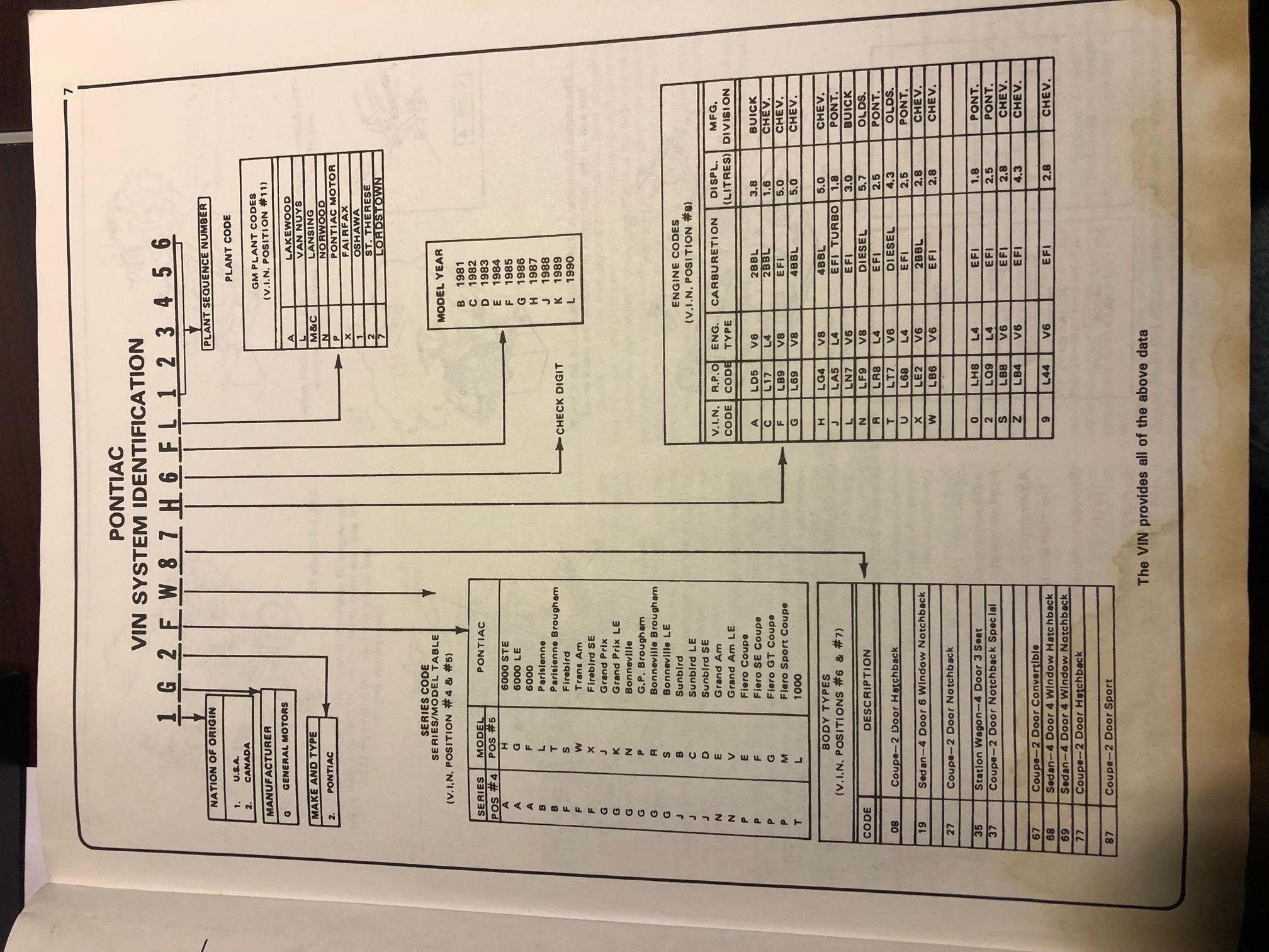

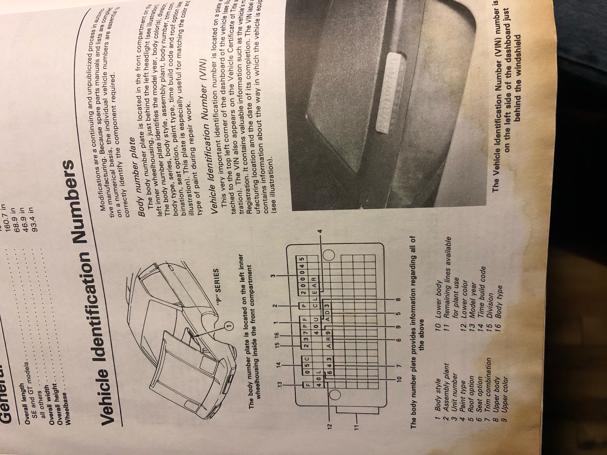

If it were mine, I would check the VIN on the windshield and all of the panels. Make a list. Check the VIN to the title. Check the VIN to the vin breakdown. Take a look at the body number plate as well....
