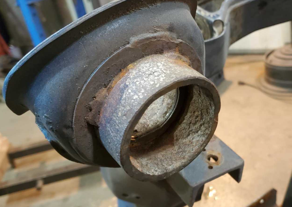

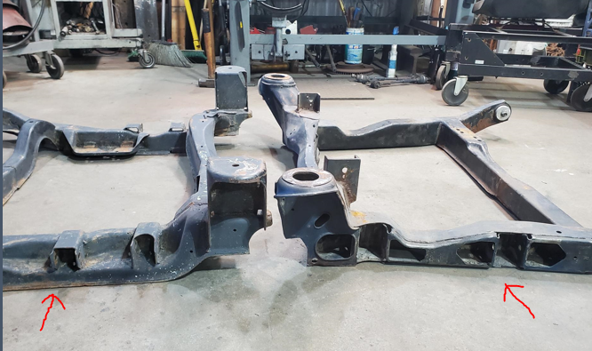

I asked this question in my build thread. While converting my '87 cradle to rigid mounts, I welded some pipe sections on the tops and bottoms of the rear perches temporarily so I could install a spare Quad to check for fitment in the engine bay.
Now that I'm done rebuilding the Quad out of my GTZ, I was just about to re-do the pipe sections on the rear perches. As I compared the '87 to the '88 cradle, I started wondering if anyone's ever just made the non-88 cradle perches smooth like the '88 cradles are. As I mentioned in my build thread, the sides of the cradle or the sheet metal would have to be altered to make it fit.
This is one of the pipe sections I tacked in place (the cradle is on its side)
The '88's perches are taller than the '87s, but the cradle is thicker and the '88's suspension mounts higher than on the '87.
I closed up the big openings on the '87 cradle, but was still planning to use spacers on top.
Ditching this section of pipe would be a cleaner, simpler mount.
I know mounting the cradle this way would alter the axis of the rear suspension travel, tilting it forward, but would it be enough to cause any problems?

Before I converted my 85 to 88 rear subframe/suspension, I solid-mounted the cradle- had a friend machine some steel to fit in the front, and used blocks of aluminum to replace the rear bushings.
The biggest problem with mounting that early subframe without spacers is that it would position the engine higher....depending on which engine you are going with there could be interference between the engine and the decklid. Positioning the A-arms higher up would be a slight improvement in geometry.
If you are doing an engine conversion then you could make modified engine mounts......come to think of it, there may be interference with the half-shafts also.

I'm thinking the changes to the rear control arm angle would not be beneficial for handling or ride quality.
Use the spacers - or better yet use an 88 rear cradle.
