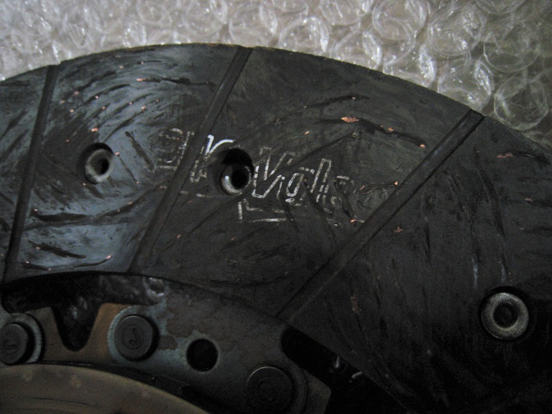

My Ram clutch (for the Muncie 4-speed) was definitely slipping with [benchracing] 318 lb*ft. I then detuned the engine to [benchracing] 291 lb*ft, and the slipping was almost all gone, with just a hair of occasional slippage.
The torque capacity might not be identical for all users.
Also, I don't think that I broke-in my Ram clutch properly.
After 12000 km of mixed-use driving (cruising, city, highway, dragstrip), the "Valeo" writing was still visible on the clutch disk friction face. Maybe with a better break-in I would have had better results, but I thought that 12000 km would have been enough.
