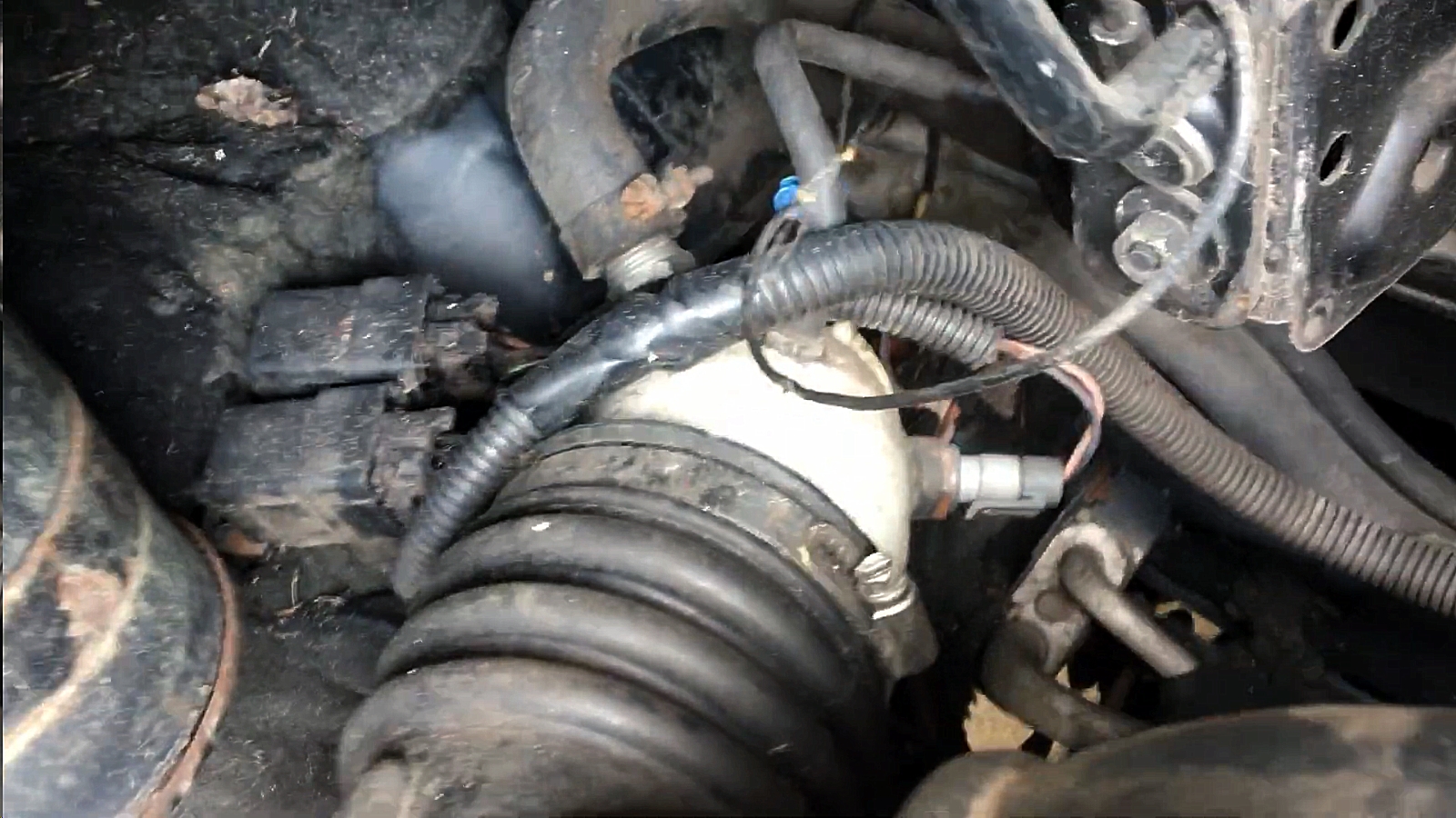

Thanks! Man I just took her out for a quick spin.....are the manuals THAT much faster than the autos? I was pretty surprised.... Put some cooling juice in her....she is ice cold. Oh and after the spin she warmed up and a fan to cool the coil it looks like came on so guess that works. Speedo does NOT work.....good thing they are not required in Texas to pass inspection. Here is a warm start...listen to that intake... https://www.youtube.com/watch?v=1JiDhnLfZdE
Here is the uh...PVC intake? https://www.youtube.com/watch?v=6mptmIoHYJU I am gonna have to take this apart and see whats what....I am not cool with it having no filter at all if that is the case.

SEP 21, 06:15 PM
Just a suggestion. Take off the driver side wheel liner and look in there to see if you have an air filter. If you do not have one, add one as it is cheap engine protection. As for the speedometer; check out the sender unit, the wiring and connector on the transmission. I suspect that the problem is there. I would say that the manuals provide more peppy performance than the autos but it really depends on the FDR. Fieros are fun cars to drive and that is why we own them. It can also be said that they are fun to work on, sometimes!------------------ " THE BLACK PARALYZER" -87GT 3800SC Series III engine, custom ZZP /Frozen Boost Intercooler setup, 3.4" Pulley, Northstar TB, LS1 MAF, 3" Spintech/Hedman Exhaust, P-log Manifold, Autolite 104's, MSD wires, Custom CAI, 4T65eHD w. custom axles, Champion Radiator, S10 Brake Booster, HP Tuners VCM Suite. "THE COLUSSUS" 87GT - ALL OUT 3.4L Turbocharged engine, Garrett Hybrid Turbo, MSD ign., modified TH125H " ON THE LOOSE WITHOUT THE JUICE "

Hope there's an air filter in there, but judging by the sound I doubt it. Cluster needs to come apart anyway to fix that pegging temp gauge.

Went to visit my boy at school (Bama) so have not had a chance to wrench on her much. I did as you suggested though and checked the VSS on the tranny. It and the wiring look fine. No corrosion or anything. For good measure I took a wire brush to the connectors and put everything back together. Still no dice though. As luck would have it 2 86s showed up at the junk yard. I was not able to get to them before the spoilers and trunks were not 100% destroyed by other scavengers but I did snag a speedo, tach, matching rim, and subwoofer housing for my sons 88. The car I took the speedo from had over 300,000 miles on it....amazing[This message has been edited by Forrest (edited 09-27-2021).]

You should've grabbed an air filter assembly (canister, brackets, etc) for your Fiero!
| quote | Originally posted by Forrest:
Here is the uh... PVC Intake? I am gonna have to take this apart and see whats what....I am not cool with it having no filter at all if that is the case.
