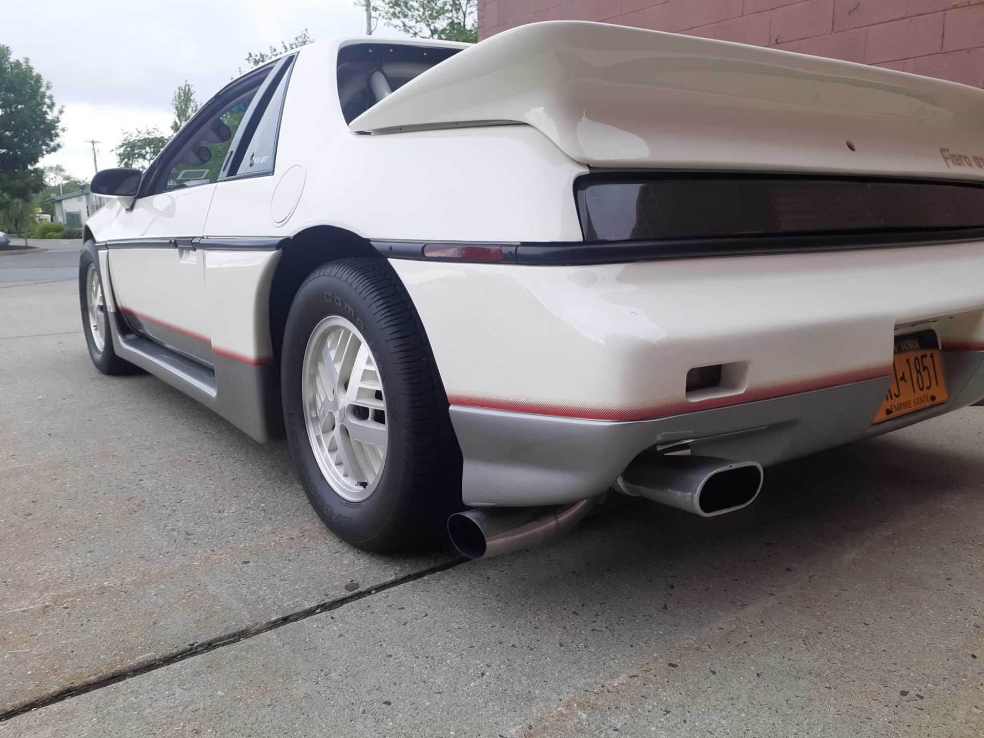

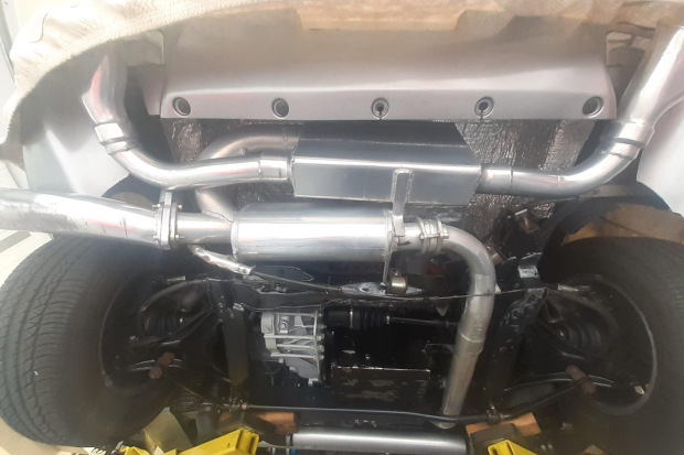

What is the purpose of the third tailpipe that branches off to the left?

I saw the car at the 25th as well and noticed the girdle he put around the stock getrag diff. You can see the bottom side of it in one of the pictures above.
The 3rd exhaust pipe is likely capped off to keep it quiet during normal driving and then can be uncapped when we wants it to be roudy. Max power was likely with that 3rd pipe open.

Before i clicked i thought strip it but then clicked and wouldn't change a thing. Exhaust has to go somewhere. [This message has been edited by Australian (edited 08-29-2021).]

Interesting, thanks. Considering how much money was no doubt put into this car, I would've thought a more aesthetically pleasing solution could've been designed/fabricated for the "uncapped" exhaust. Looks rather weird to me the way it is.

Interesting, thanks. Considering how much money was no doubt put into this car, I would've thought a more aesthetically pleasing solution could've been designed/fabricated for the "uncapped" exhaust. Looks rather weird to me the way it is. |
I am sure it was added on after the fact when they figured out they were loosing 50 to 75 hp by going through the muffler. On my LSF/F40/Turbo, the cutout was designed in from the beginning. From the turbo, it goes into a 3.5" downpipe with open tube muffler, Ys into dual 3" with one side capped with a valve and the other side goes through a 3" muffler. Both tubes exit in the stock location. Ideally the cutout when closed will be the proper distance from the Y to work as a helmholz resonator to further quite down the exhaust when running in single 3" mode.
