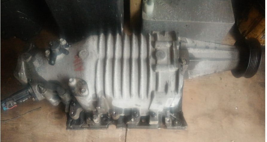

Cuppla questions for y'all. There is a Series 3 3800 at the local scrap yard. How can i tell for sure (visually) that the blower is from a series 3? Will a series 3 blower fit on a series 2 lower intake manifold? Do they use the same throttlebody??? Thanks jon------------------ Astronomy says we will find a coded signal from outer space. Then we'll KNOW that life exists there, for coded signals aren't by chance.

The later superchargers are referred to as generation V or Series 5. The earlier post 95 superchargers are series 3. They are not directly interchangeable. The series V has a bolt dead center near the supercharger snout. The other easy way to tell is if the car is 95-03 model year it should have the Gen 3 supercharger. If the application is 04-07 Pontiac Grand Prix it should have the later Gen V unit but if the vehicle was a Buick or Chevrolet it has the Gen 3 unit on all years. Both units have an identical displacement but the Gen V units make more horsepower as they were designed to run cooler and run more efficiently. ------------------ " THE BLACK PARALYZER" -87GT 3800SC Series III engine, custom ZZP /Frozen Boost Intercooler setup, 3.4" Pulley, Northstar TB, LS1 MAF, 3" Spintech/Hedman Exhaust, P-log Manifold, Autolite 104's, MSD wires, Custom CAI, 4T65eHD w. custom axles, Champion Radiator, S10 Brake Booster, HP Tuners VCM Suite. "THE COLUSSUS" 87GT - ALL OUT 3.4L Turbocharged engine, Garrett Hybrid Turbo, MSD ign., modified TH125H " ON THE LOOSE WITHOUT THE JUICE "

i went and pulled the blower off a 2006 Grand Prix. My friend, who the blower is for, said it would work if i also pulled the lower intake manifold, which i did as well as the purge valve which is different also.
