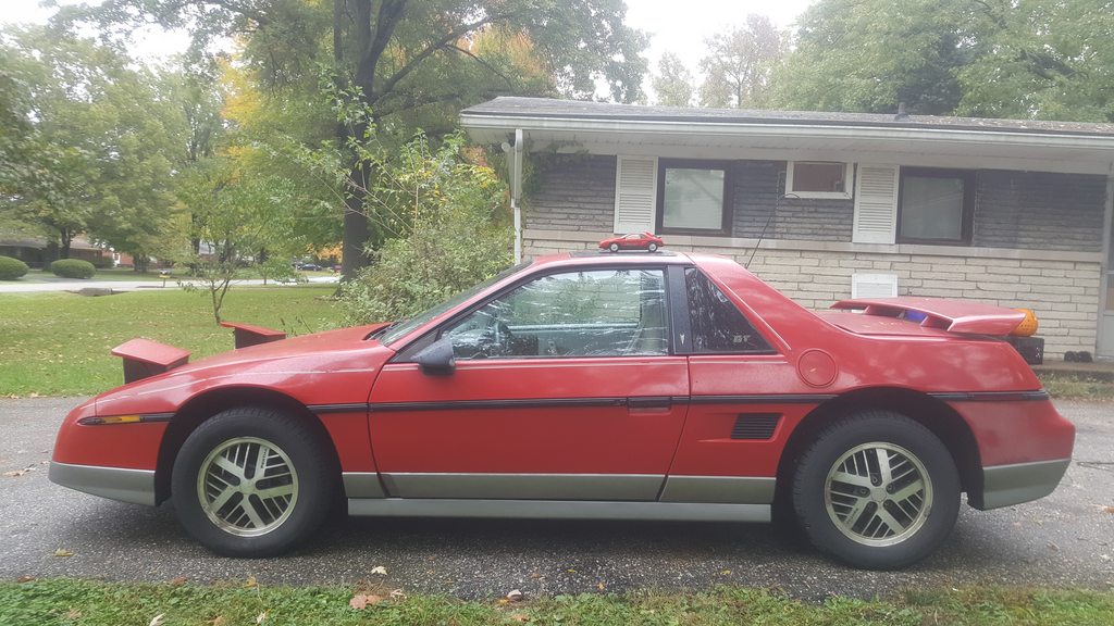

Besides the Fiero, one of my other hobbies is radio control vehicles. They're mostly scratch built, generally about 1:10 scale (ie fairly large, especially if you're talking about, say, an M-1 Abrams tank and its associated prime mover and trailer.) Was chatting with fellow enthusiasts in that hobby and came to discover that one such enthusiast and I share another hobby: Fieros. They were kind enough to share with me this picture of the cars:
Look very closely on the roof and you'll see a matching Fiero on top on his Fiero.
Anyway, I thought this was a great idea, appeals to both my OCD "match all the things!" and to my Fiero habit, without having to buy/store/maintain a second actual car. Plus, I could modify the little car to look like the big one. I mean,

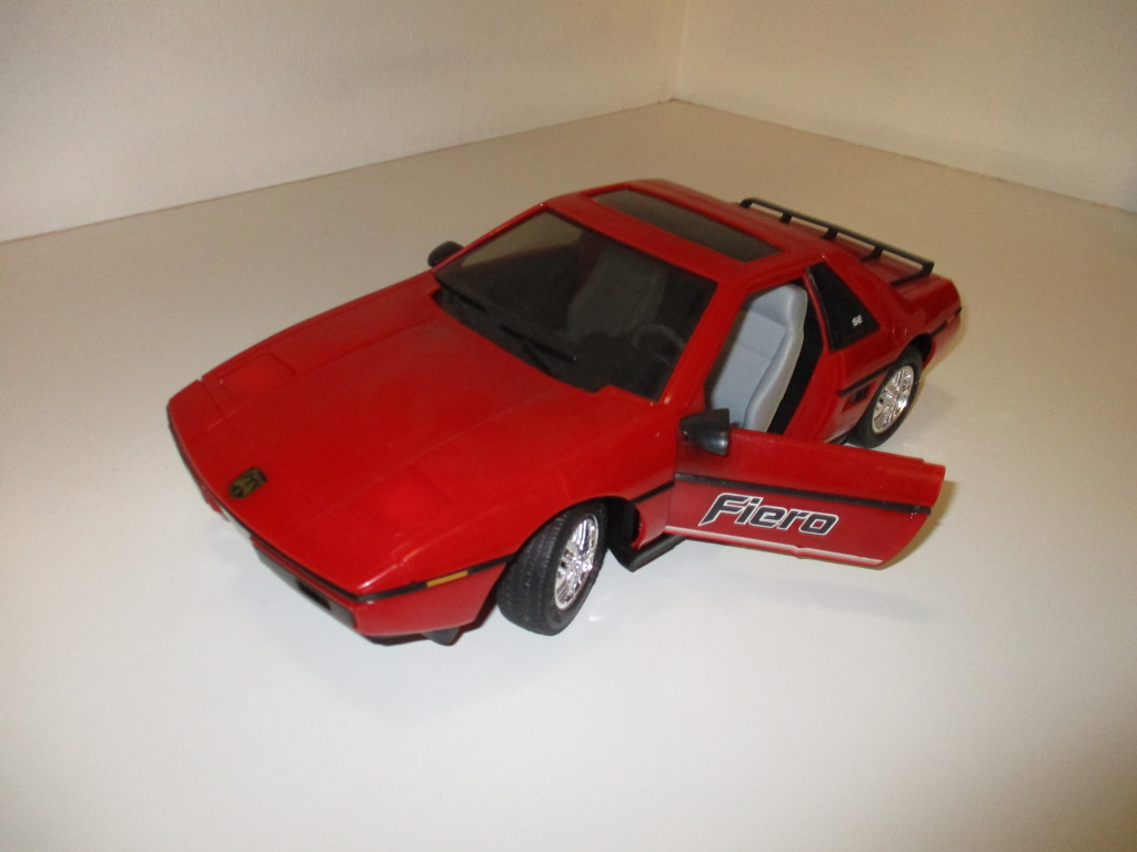

Okay, enough memes. So there's a few remote control Fieros like that, all those horrible cable-controlled ones (ie no actual radio.) Found one on Fleabay that wasn't exorbitantly priced (some people think they're made out of unicorn poop), good cosmetic condition. The mechanicals were pretty bad after 30 years, but that's all gonna get replaced anyway.
Started with this:

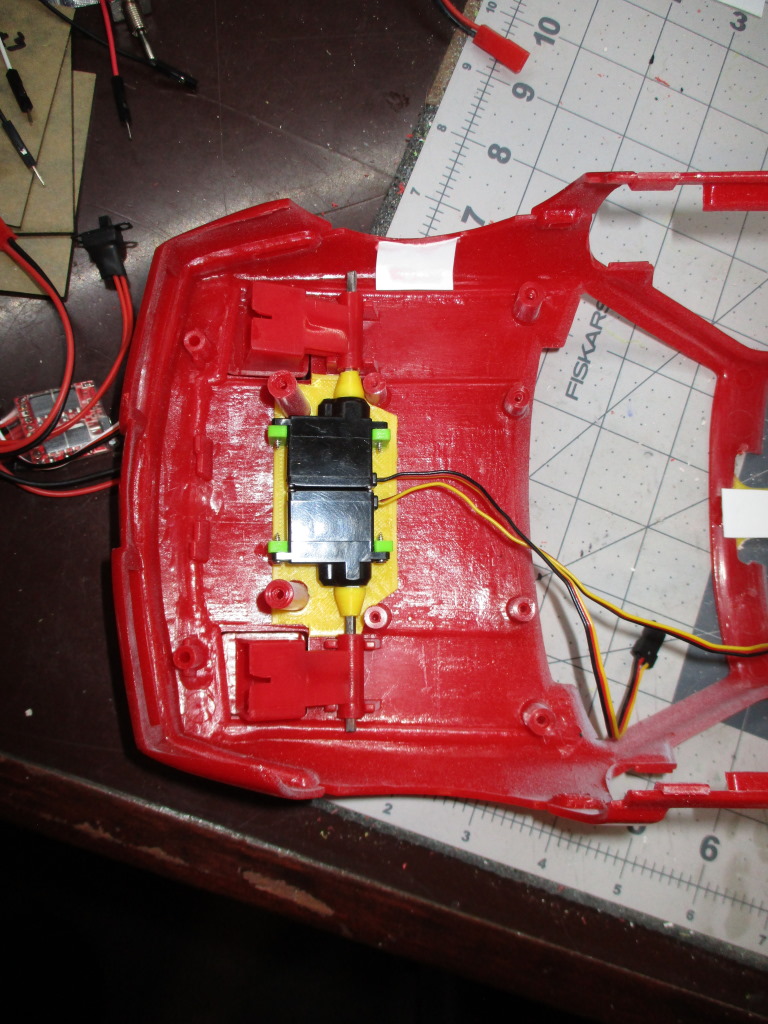

It's actually surprisingly accurate in dimension and detail and, besides the Rube Goldberg-esque electrics, fairly well-built. The steering mechanism was a convoluted worm-gear thing, and while yes, it has working pop-up headlights, they're actually MORE complicated than the Gen-1 setups =)) For this one, we just directly couple some appropriately sized servos to the pop mechanisms
(underside of hood, front to left of car. White patch in the driver's side front wheelwell is behind a crack in the plastic.) They're shmancy digital metal gear servos that are programmable, so you can set the start and stop points and reverse them so that they both spin the same way even though they're mirrored, and cleverest of all, you can slow them down so the lights just gliiiide up.

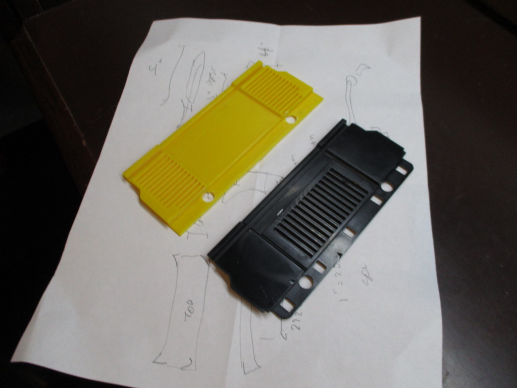

The notchback trunk has the vents forward of it (is that all notchies, or just early ones?), so gonna change out the black piece (original to the car) to a new one with the vents on the sides (here, yellow):
The yellow one is just a test piece as it was what I had in the printer, gonna do it black for the final version as it'll come out better than trying to paint it. The rectangular holes are for the luggage rack, which I'm not going to have, so aren't present in the printed version.[This message has been edited by dremu (edited 05-30-2021).]

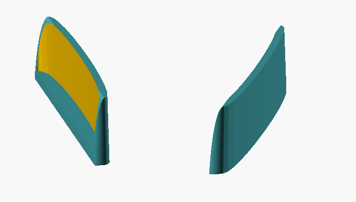

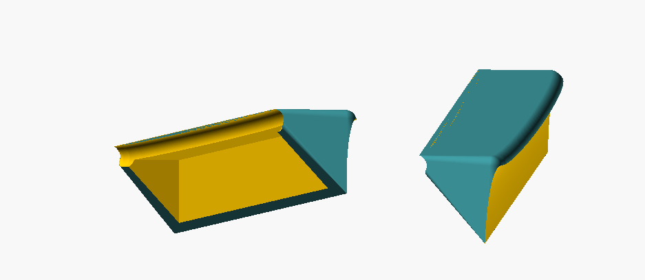

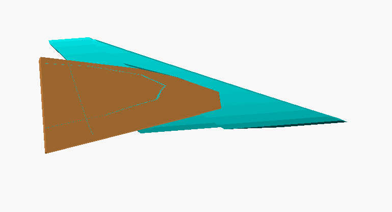

These guys then go inside and behind the existing rear wing. This is LH; one thing I love about printing is once you get a thing designed, you can get a mirror of it for the other side just by pressing a button.
Left image is the rear view, shows how it curves from the trunk lines in towards the roof. Right image is outer side of the piece. The left bit is what slides behind the existing notchback and glues in there and to the roof for strength. Part of the center will get cut out for the wing window (see below), but I'm trying to keep like 2-3mm top and bottom to attach the window.

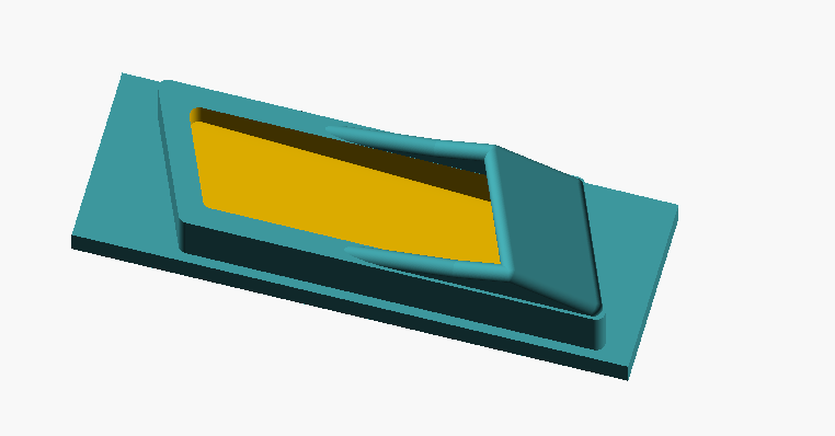

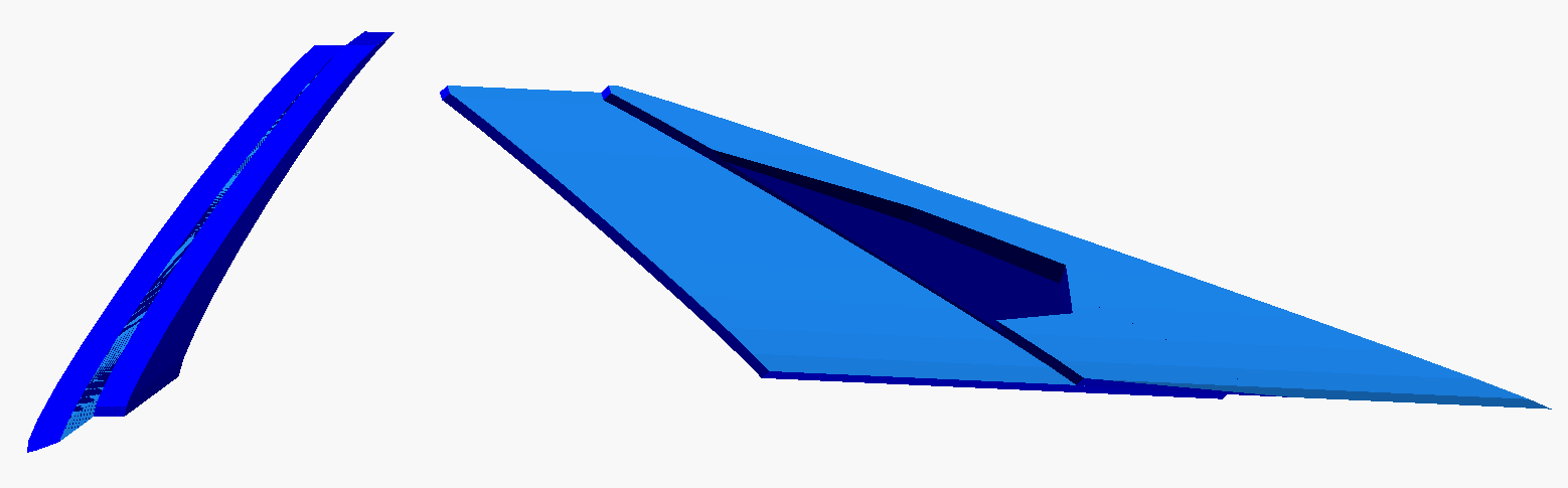

I am hopeful that the wing windows can be done in actual acrylic (vs printing), thinnest tinted I could find is ~2mm. These are templates for me to start from
Because, as mentioned, everything on this car is stupidly shaped. Gonna take a lot of manual work, Dremel sanding and filing, to get these Just So.[This message has been edited by dremu (edited 05-17-2021).]

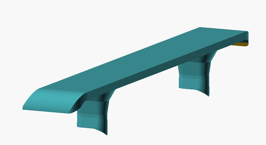

and the spoiler

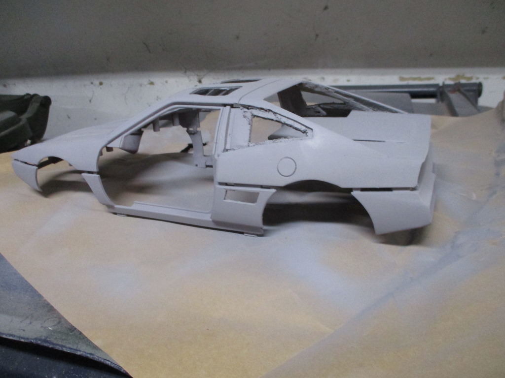

After repeated application of the Dremel and more filler than I'd care to admit, the shell now looks thus
The wing window cutouts still need a bit of filing and cleaning, see how that works once the tinted pieces are cut. But it's starting to resemble a fastback, yay.

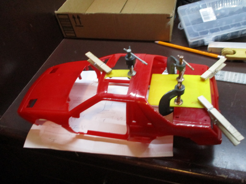

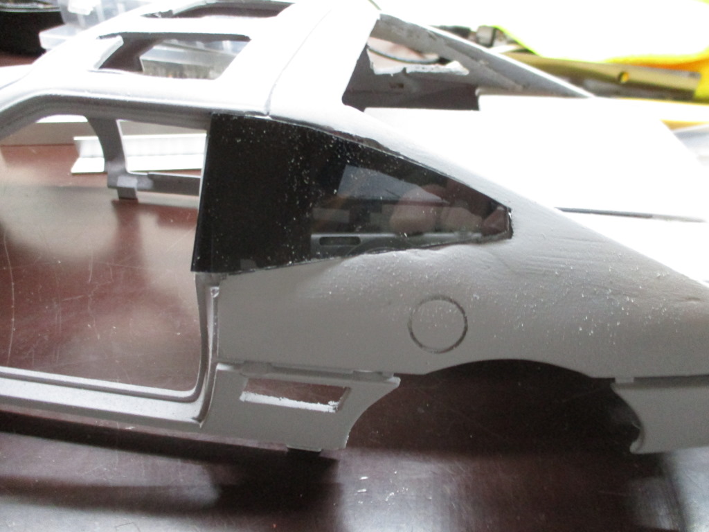

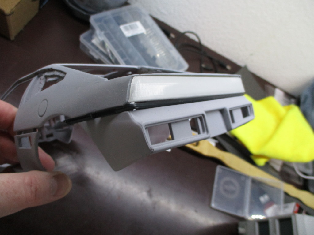

More packages arrived in the mail, including thin tinted plexi. Still need trimming and lordie the shell needs more sanding. Body work on little ones is just as much work as on the big ones! The tint on this is a bit darker than the existing windshield/rear, but it was all I could find. In any event it means I won't have to fuss so much over the black behind it, basically looks like the GT wing window as is:

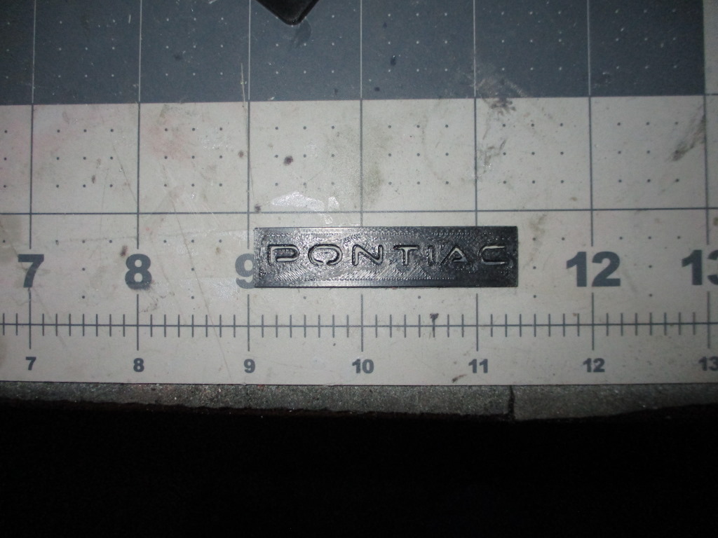

will work in the center. A quick test of it with one 5mm LED had only one letter showing through legibly. Ordered some larger diffused LED's, hoping they do better. It's not so much the brightness, but the dispersion pattern of the light.

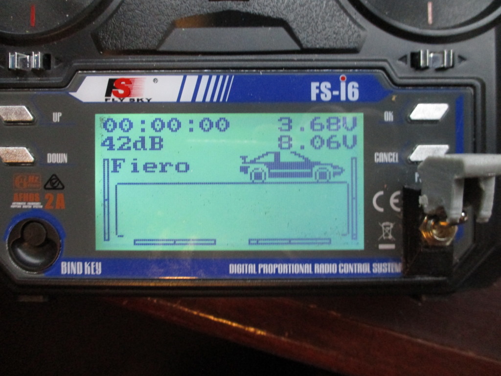

TX is now set up for the car; seems silly, but helps me remember which TX goes with which vehicle(s).

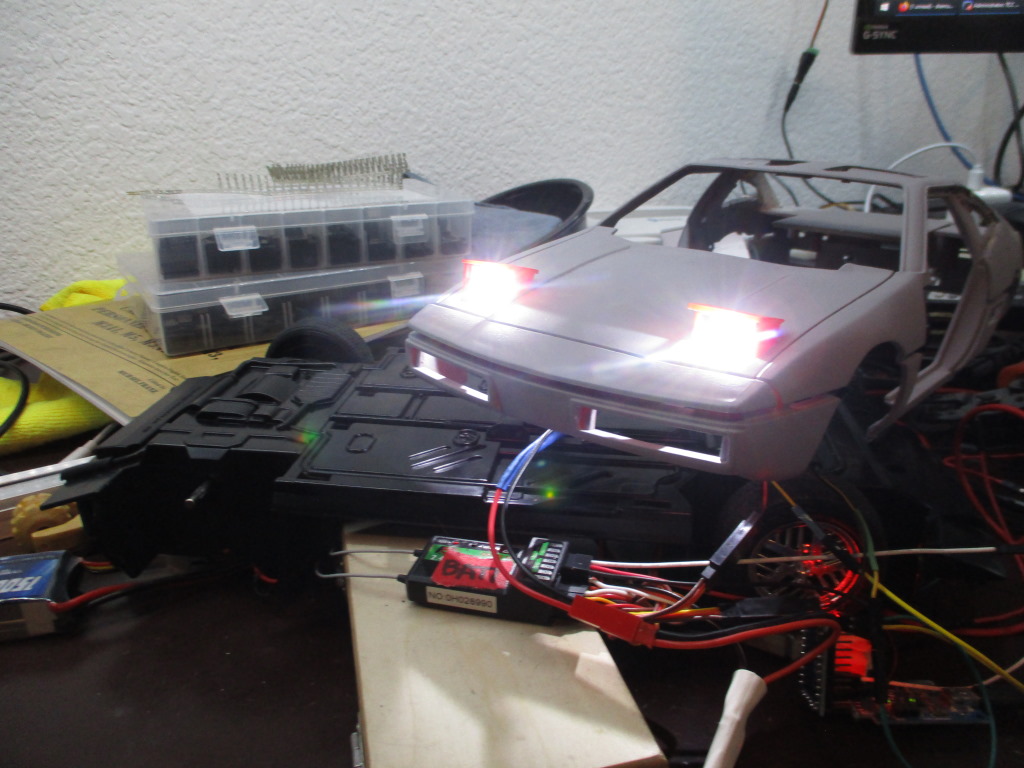

Finally, got the headlight pops working to my satisfaction. First, the illegal and blindingly bright LED's:
and then a demo of the mechanism (with lights disabled, as otherwise the camera got all confused and you couldn't see squat)
They don't quite lift simultaneously, but the big one's like that too =)) I gave up on using the servo's stupid digitally programmed end limits, now just driving them with an Arduino. This lets me set the up and down points with actual 1000...1500...2000 values, instead of arbitrary "37" numbers that don't mean anything, so they're at least aligned when up or down.
Also started laying out where to actually *put* the components inside the car, and there is surprisingly LITTLE room for the RX, battery, switch for the headlights, and the one Arduino for the headlight pops and the rest of the lights (gonna have brakes, backup lights, and turn signals, because LED's yay!) I see why the folks who do conversions from static models to RC tear their hair out doing so. My scratch builds generally don't have an interior, and/or are larger vehicles like trucks.

How'd you do the custom pics for the flysky?
