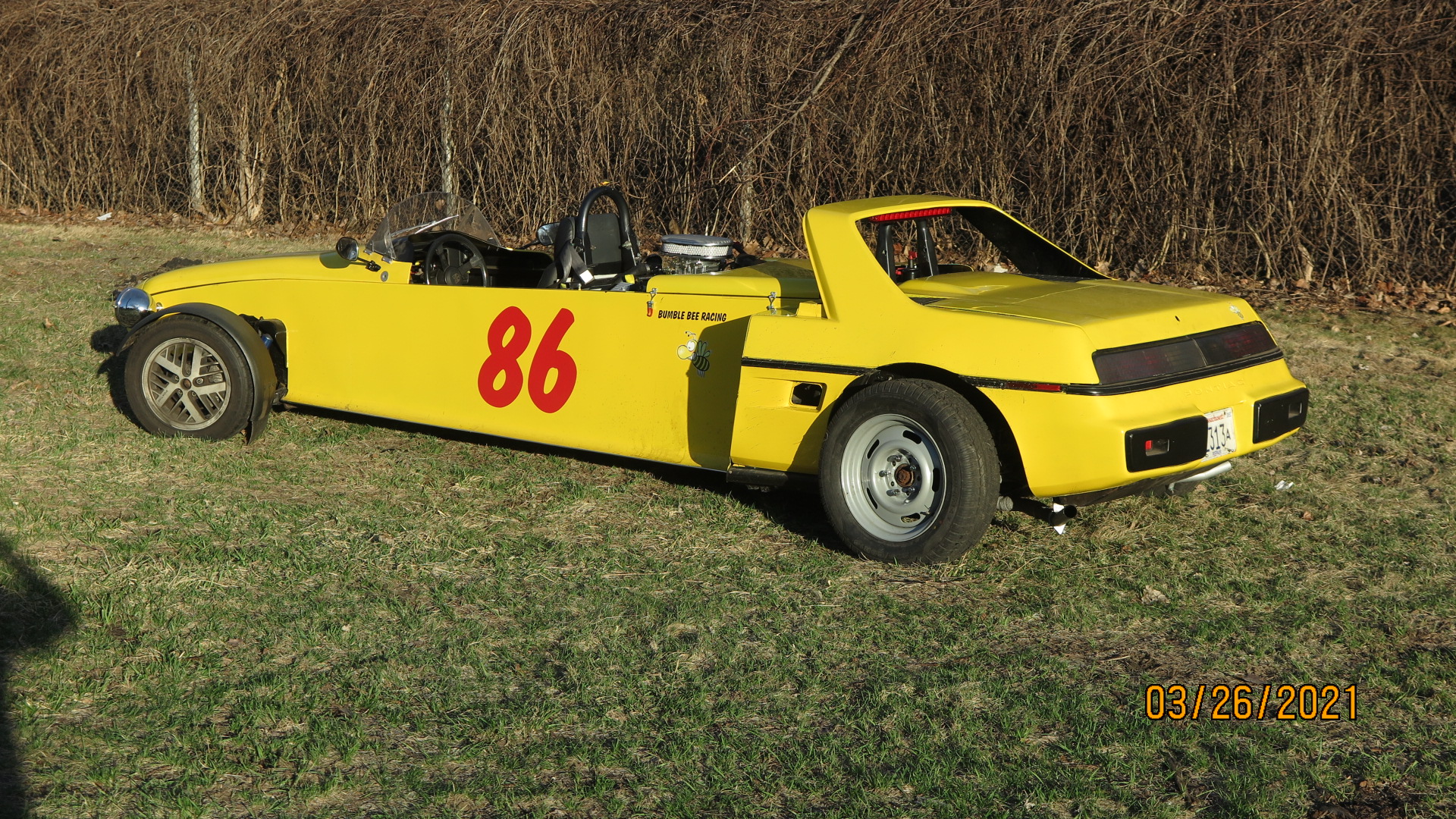

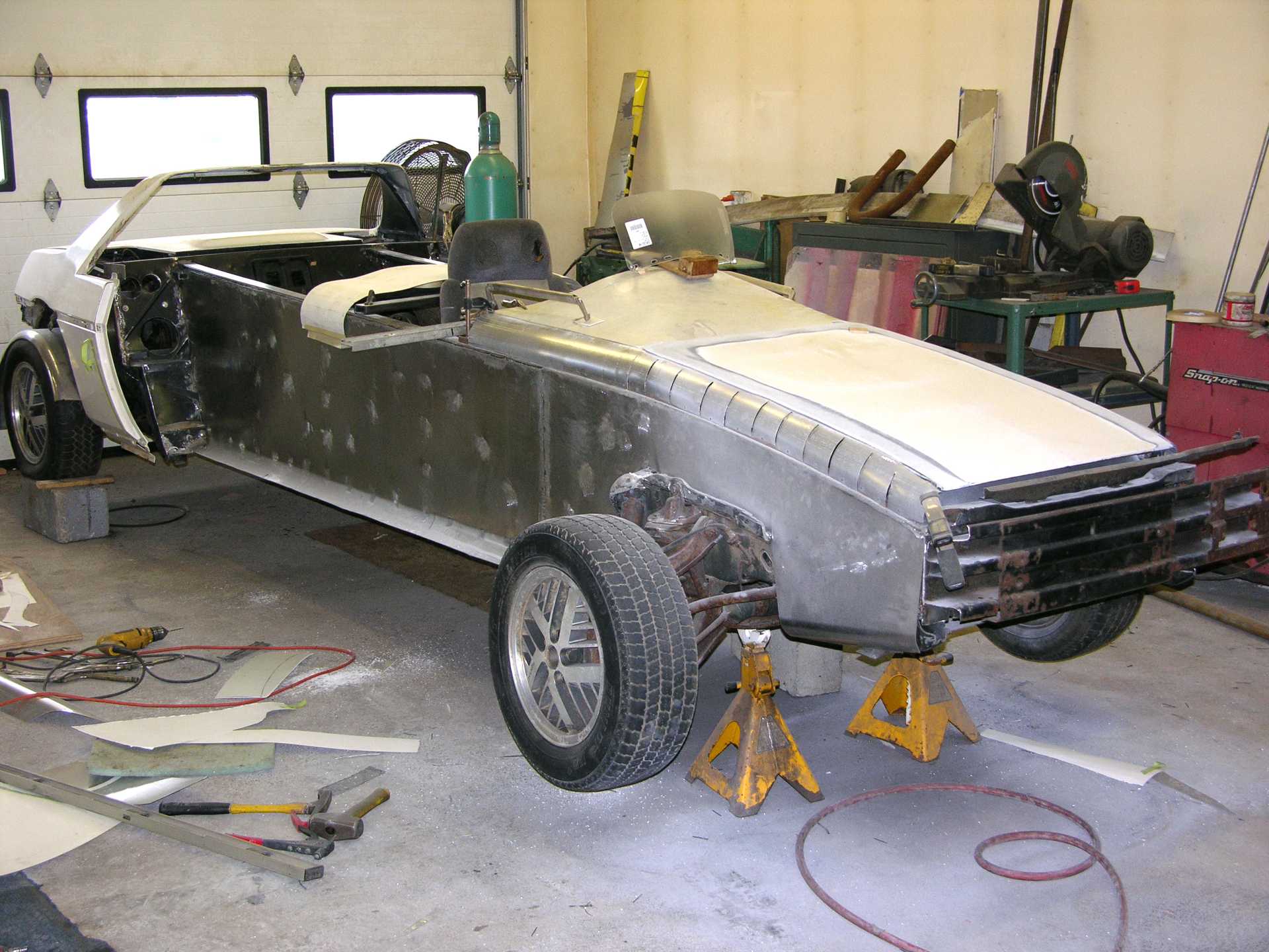

  [img]http://i mages.fieroforum.com/userimages/Roger%2520Walling/IMG_1356.JPG[/img] I took my 85 out for a ride with my new motor for the first time

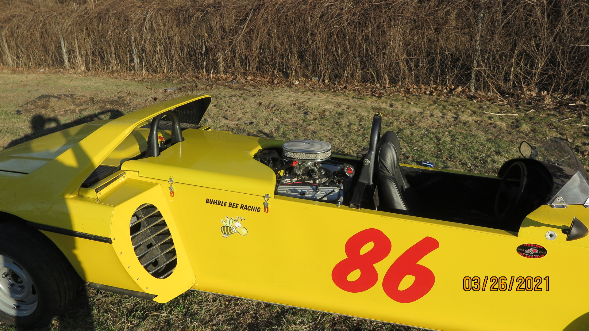

It rides very well, corners like it is on tracks. A little noisy with the carb so close to my head, but who cares? The only problem that I have when driving it is that people are always blowing their horns at me and taking pictures right alongside.

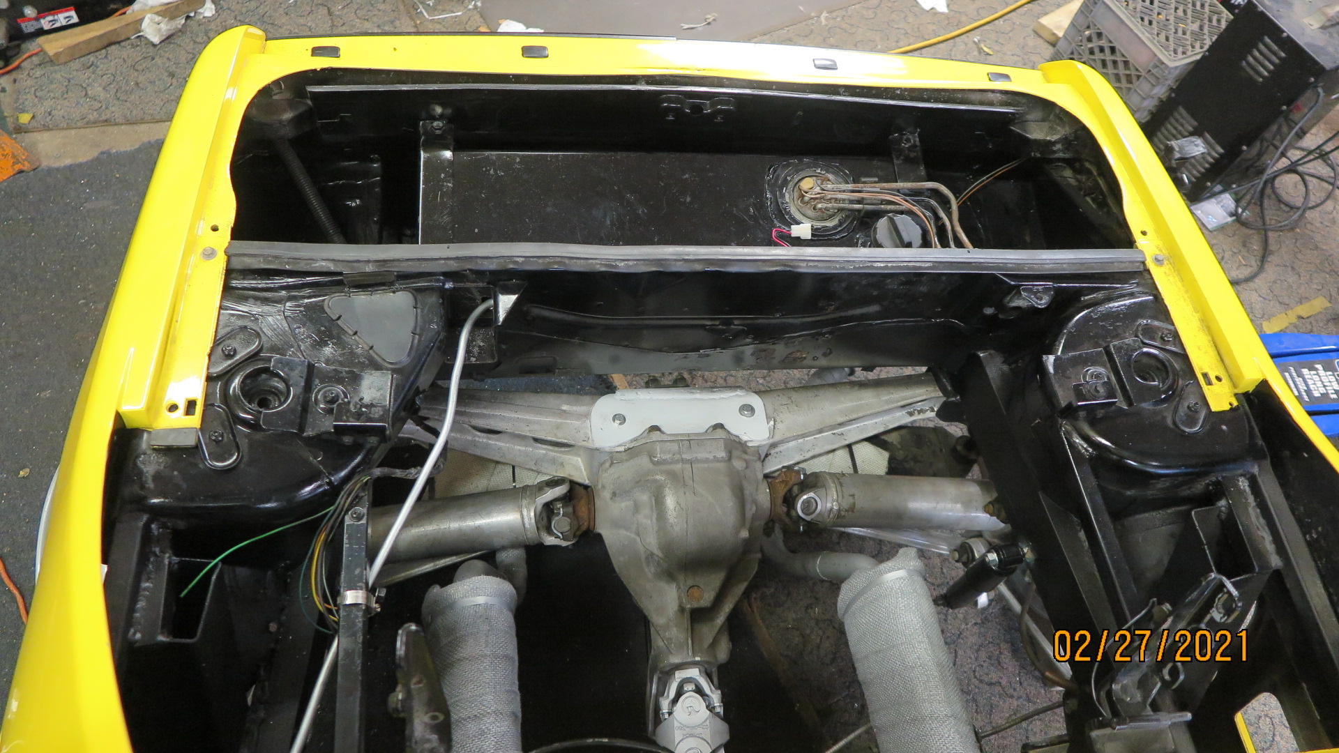

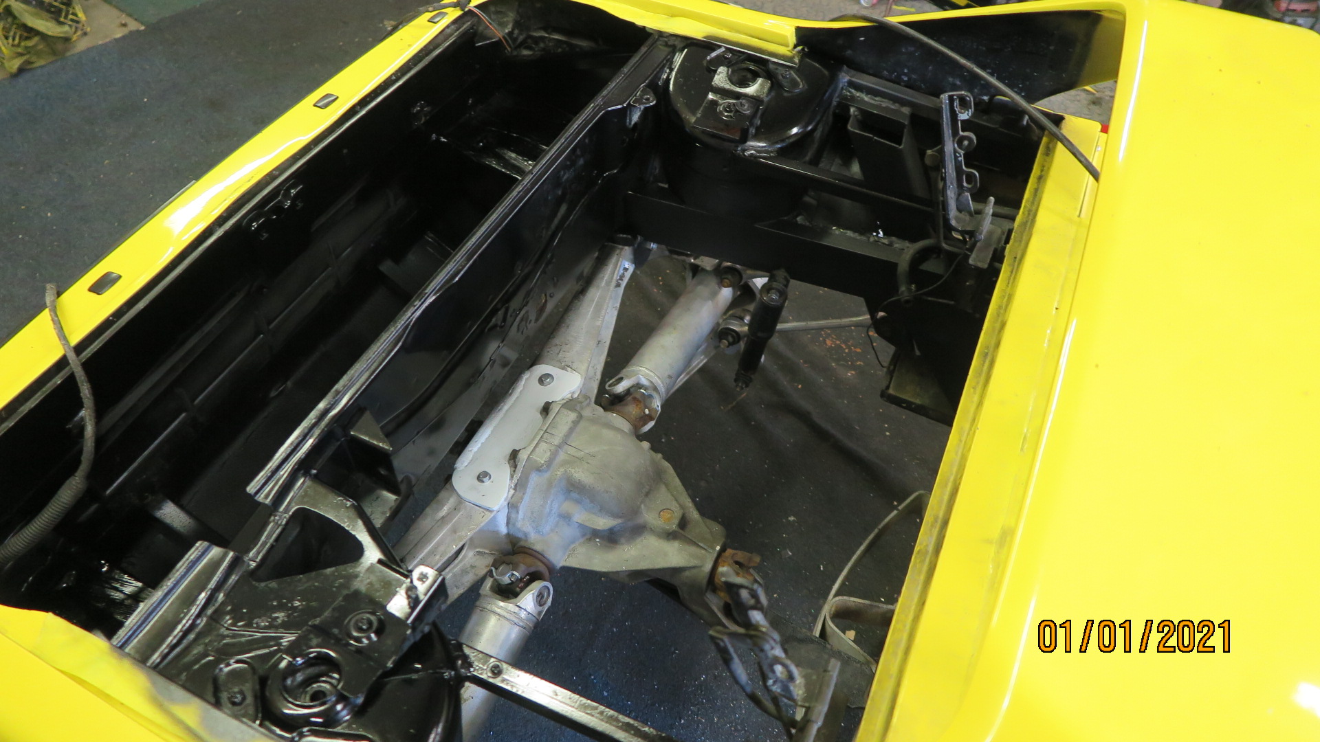

The body was lengthened with 1x2" tubing with 16 Ga. sheet steel sides welded making a space frame. The center of weight is about 1 foot in front of the rear tire. It has a 305 GM with a 700R4 and a 64 Corvette rear with a 62 center section. The driveline is a Double Cardan CV H yoke that couples the trans yoke to the pinion yoke. It cost a whopping $24, talk about a cheap driveshaft!

It's not that I don't like the attention, it is scary when someone hits the horn while you are taking a corner, or if you are driving at 65mph and someone moves right alongside you while steering and trying to take a picture at the same time.

The windshield is at eye higth and the wind blows right over my head.
