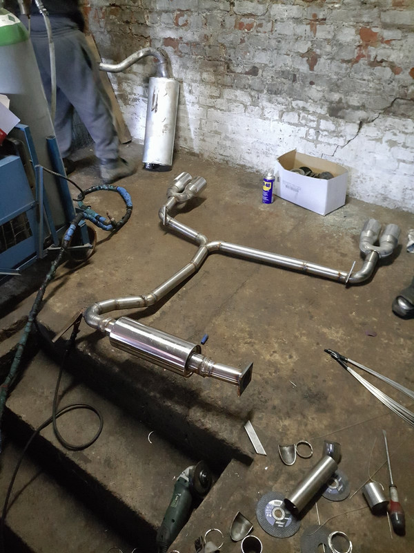

A Generic universal round muffler 20 inch long like borla for example inplace of the cat but see the picture, the exhaust must be customised because the stock has different pipe for the muffler and the tone is different than mine.
Other example in the states with the 2.8 v6 :
https://youtu.be/mFt1o1c_gQg
Custom, exhaust with cat 2.5 in the stares
See the comments with a sport cat and a small round muffler than mine custom muffler but the tone is very near
My fiero doesn't have cat[This message has been edited by zobari (edited 04-06-2021).]

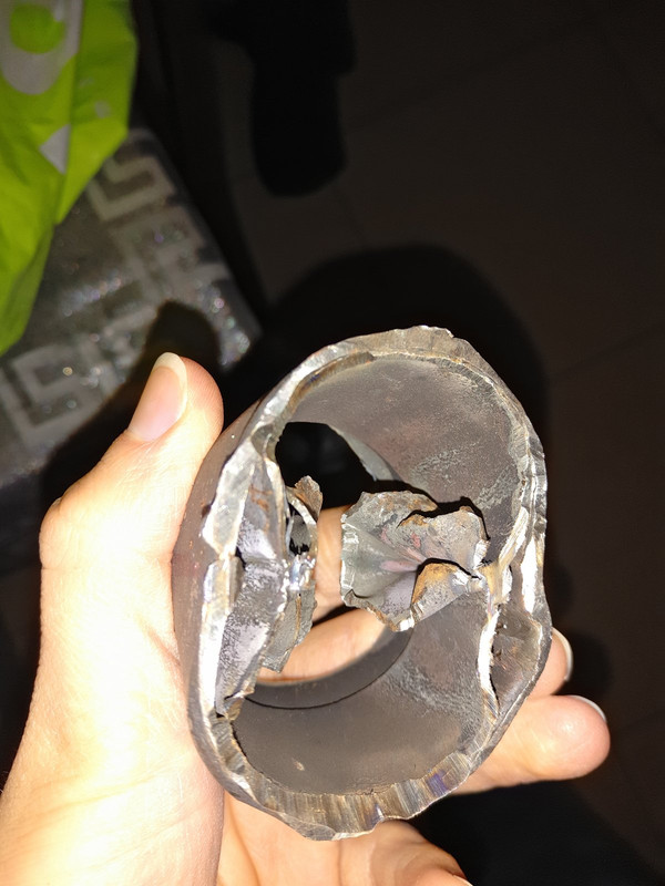

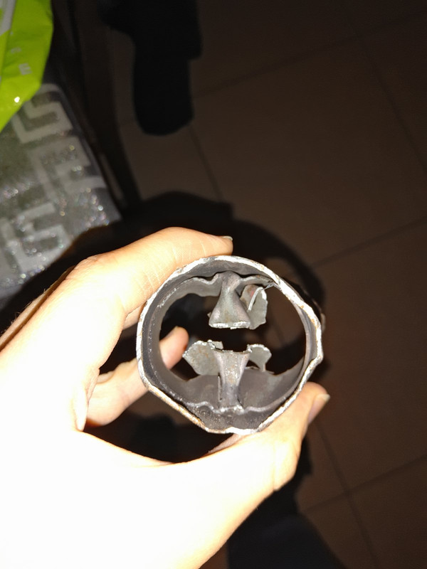

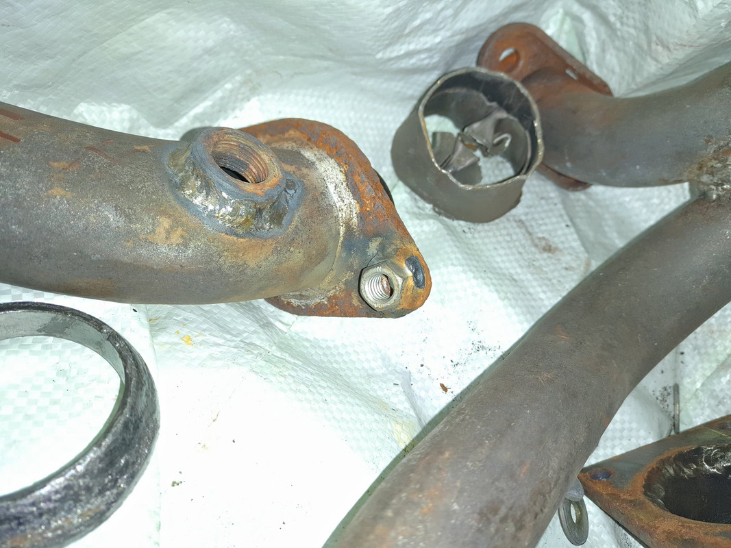

Zobari, did you notice a loss in torque when you removed the y-pipe restriction? I ask because one of the mods recommended to improve HP and gas mileage for Holden Jackaroos (Isuzu Trooper) on the 4x4 websites down-under is to remove the factory installed restrictor in the exhaust system where the left and right exhaust headers join. I remove the restrictions in my '97 3..2L Jackaroo and the mileage and throttle response was much better. The seat of the pants dyno, however, said that the low end torque had suffered some. According to other post on 4x4 boards this is normal. Just wondering what you experienced on your car.
