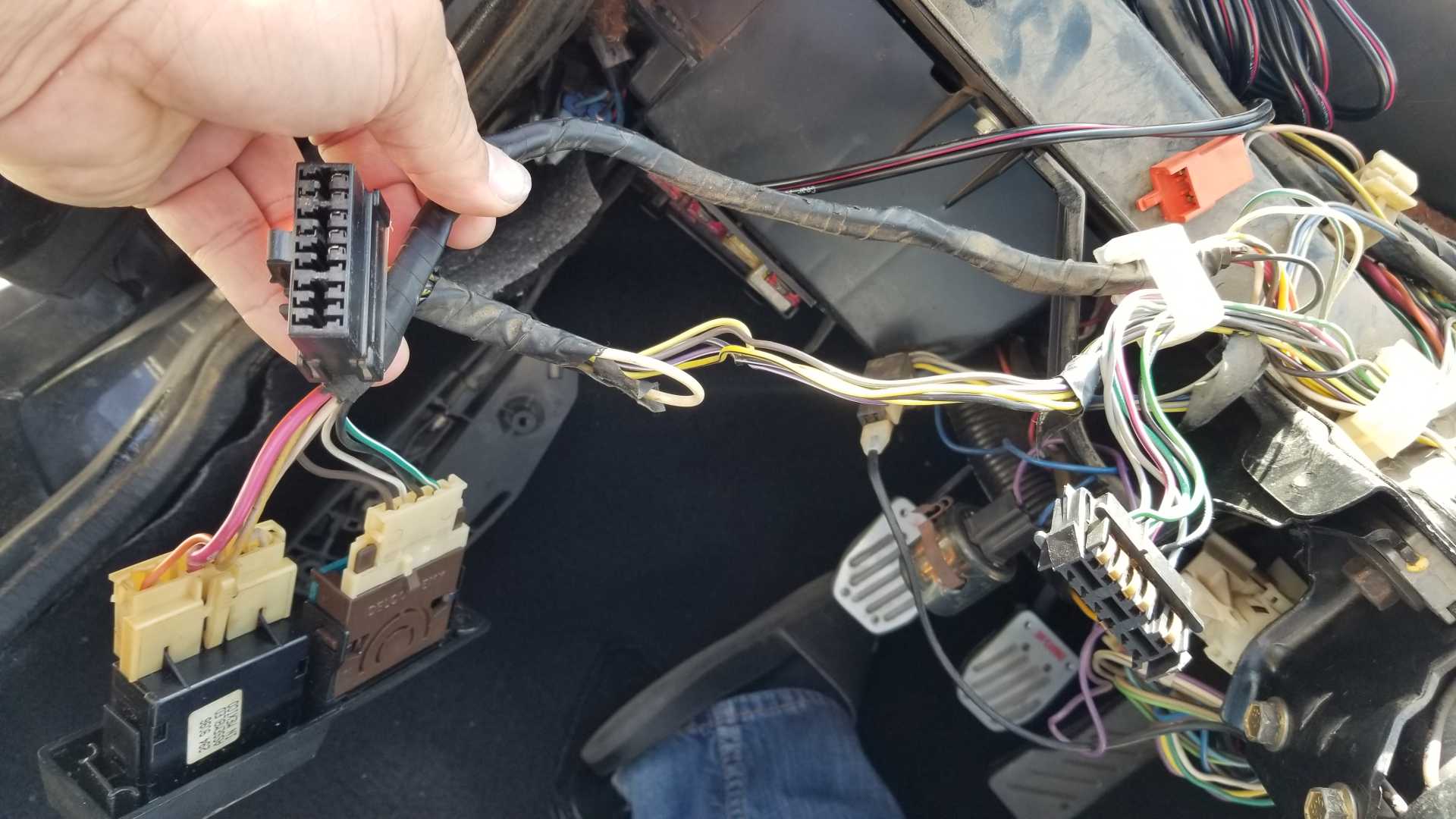

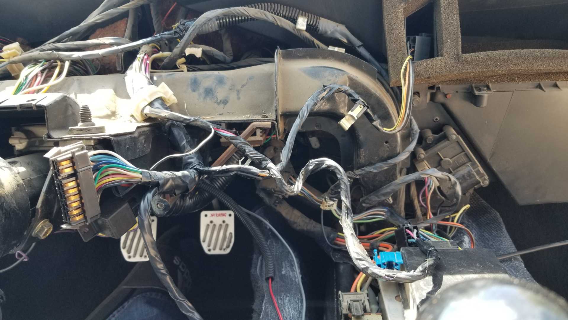

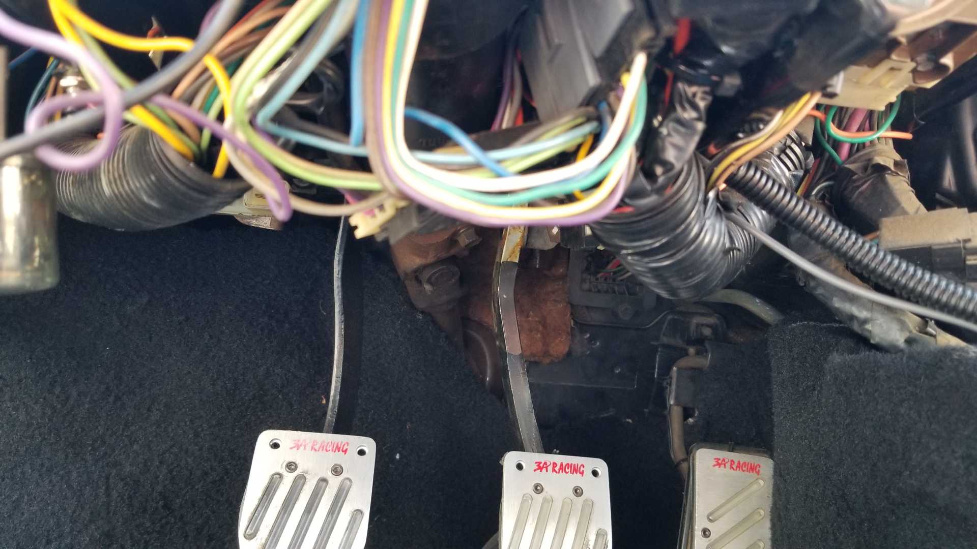

Not sure what relay your talking about but I have these hopefully you see what you need 85 GT

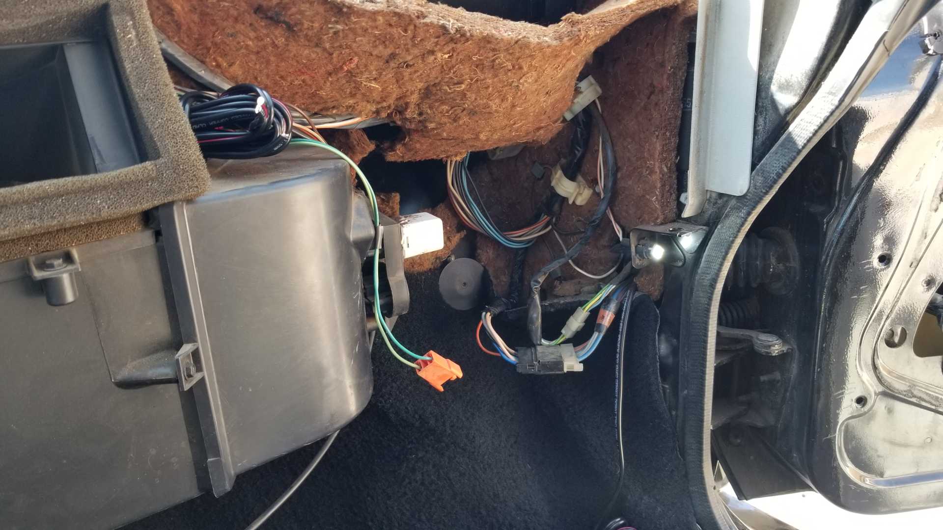

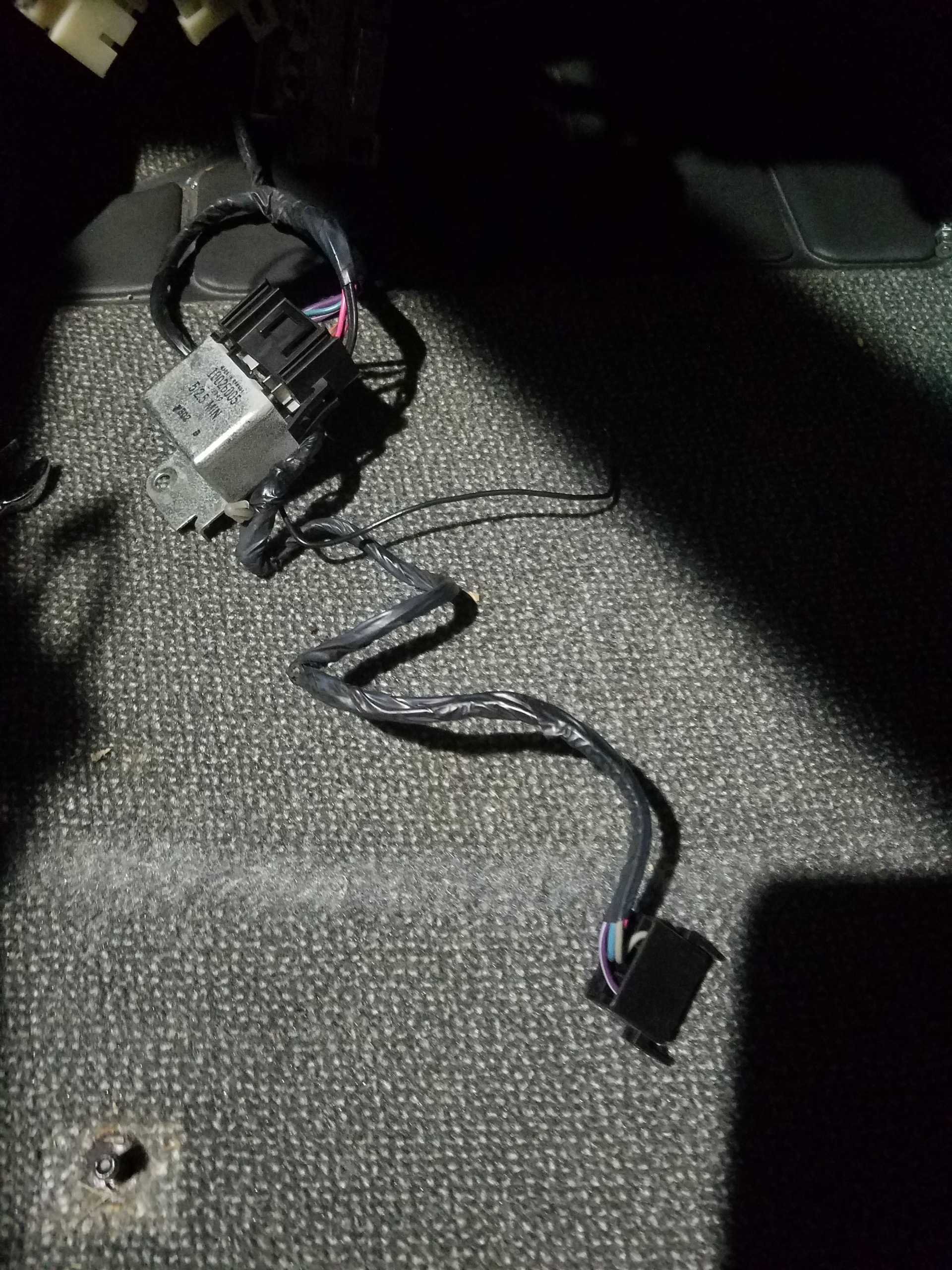

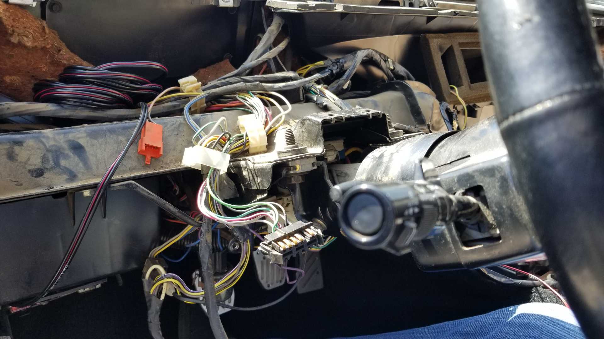

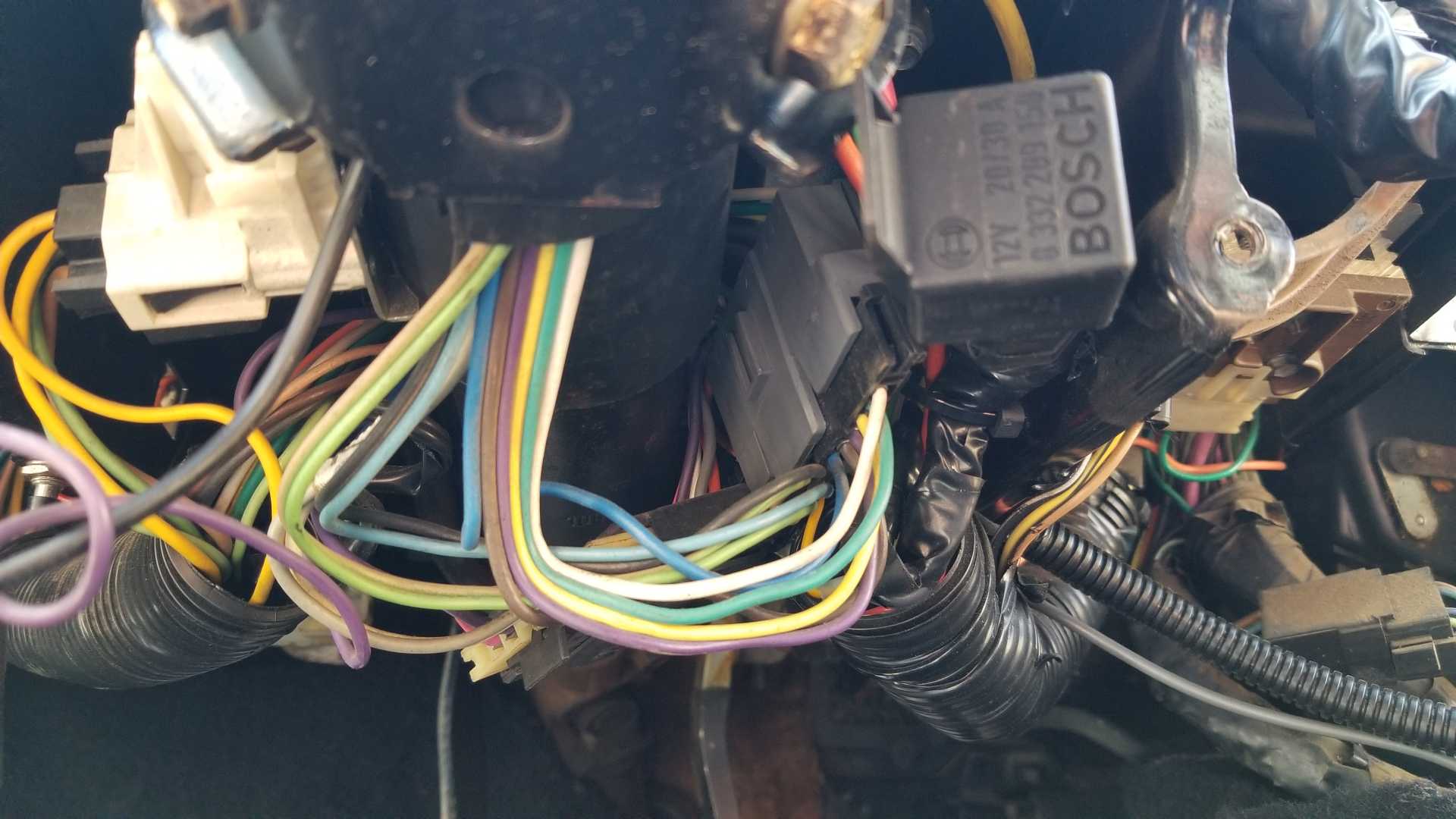

Does your car have defrost??. Here is the item I'm talking about that I dont know where it goes.. this big silver relay and ground strap
FIERO JOHN-WI
APR 04, 09:06 PM
FIERO JOHN-WI
APR 04, 09:07 PM
I think it mounts somewhere on the right side of the column

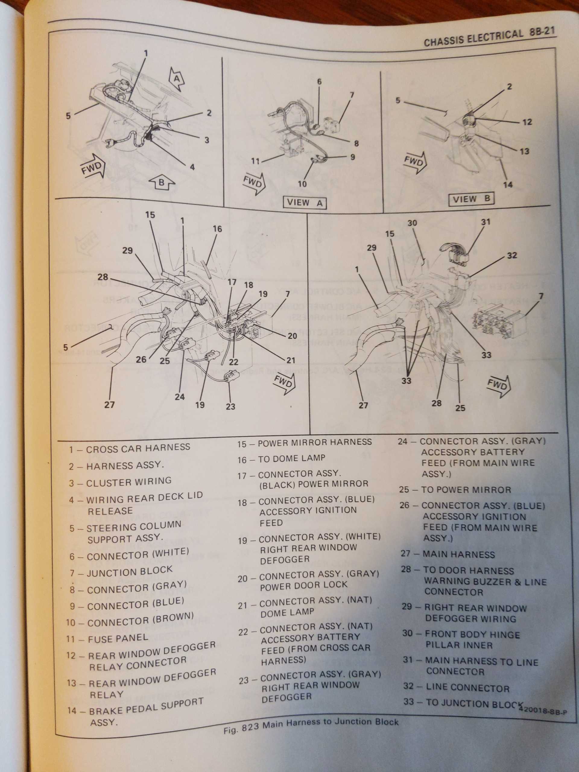

Perhaps this diagram from the 1986 Factory Service Manual will be of help.
View B in the upper right hand corner of the page shows item 13 (rear window defogger relay) mounting location.
FIERO JOHN-WI
APR 06, 08:58 PM
Thank you but I cant figure it out from the illustration

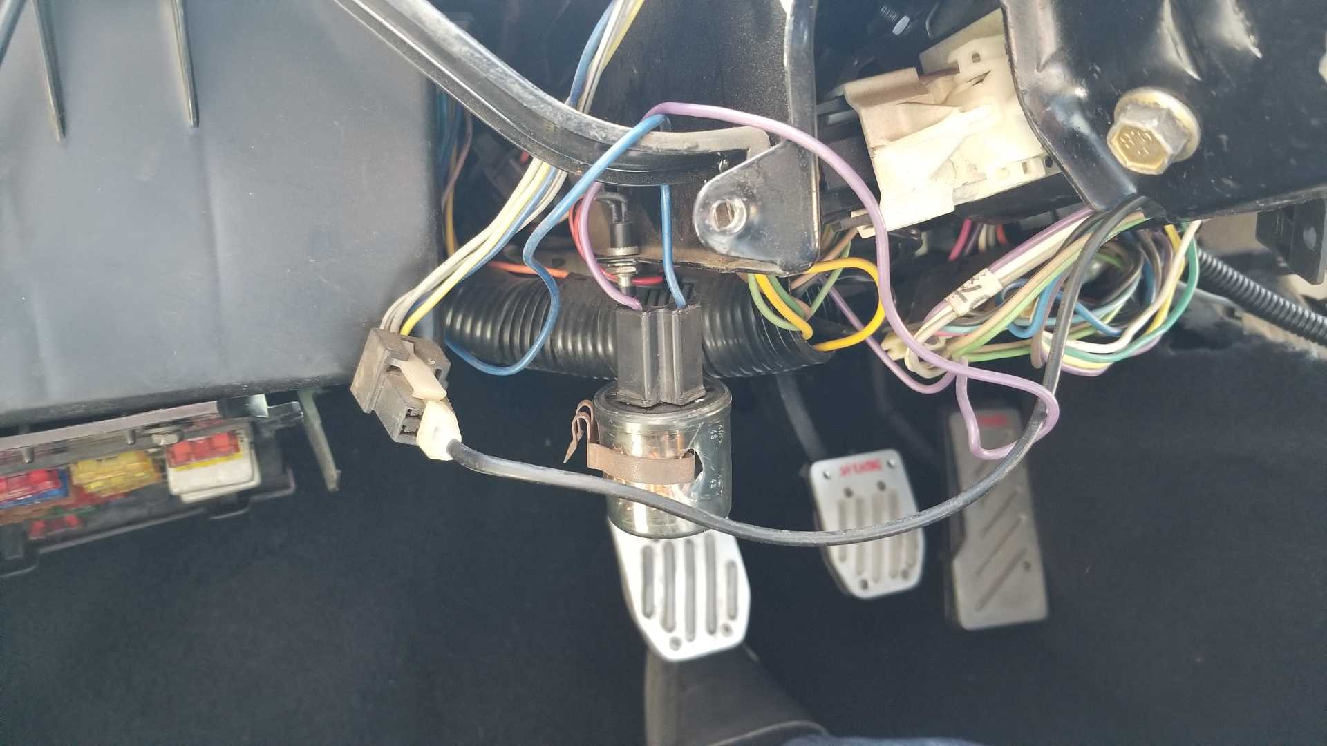

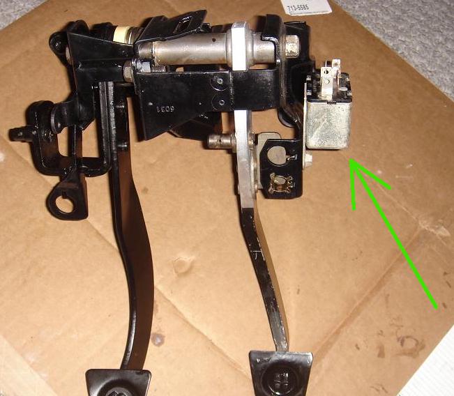

I believe it mounts to the brake pedal bracket:
[This message has been edited by IMSA GT (edited 04-06-2021).]
FIERO JOHN-WI
APR 08, 01:01 PM
Thank you will look tonight and now I just need to figure out where the ground strap mounts
