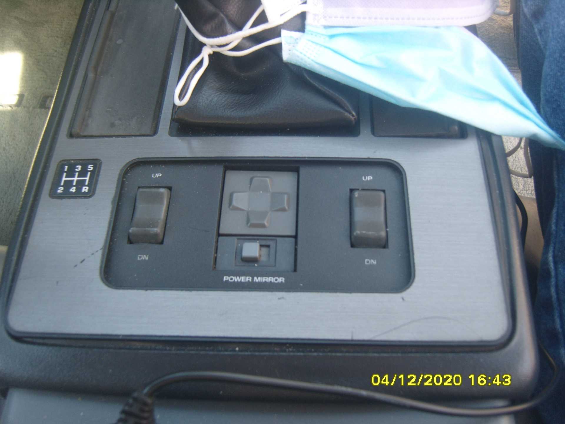

A slightly darker grey?...that sounds like a better idea than the OEM grey or a black. Any pics?
fierofool
MAR 17, 04:05 PM
I have the car secured at the moment in case the severe weather hits us tonight. I can get a couple of shots for you tomorrow if that's OK.
mono
MAR 17, 04:10 PM
Yep. That works. Stay safe!
fierofool
MAR 22, 09:28 AM
Man, I'm sorry. I forgot all about you.
Edit: Ignore the date. This was taken today. The camera hasn't been used in ages.[This message has been edited by fierofool (edited 03-22-2021).]
