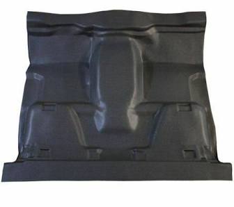

Does anyone have experience with molded vinyl flooring for their Fiero as an alternative to carpet? Sounds good on paper however I'd like to hear some real world feedback.

$210 on Ebay

From a work standpoint, that type of floor is great for muddy environments and for those in snow as long as you remove your floor mats. You can spray them down and simply wash the floor. The only bad part is that regular floor mats will slide all over the place. You'll have to find some way of making the floor mats "stick".

I think sounds in the cabin might echo off it some. Had a few cheap base model farm pickups with vinyl floor coverings.

I have this type of flooring in my Ford Ranger, but I still wouldn't suggest hosing down the floor.
I did just that, and I found water trapped underneath the flooring.
For a more rugged floor, I'd rather smooth out the floorpan and put bedliner on it. This way water couldn't be trapped. But this is a high-effort solution (mostly the part about shaving the floorpan).

What type of wet work you planning to do with your Fiero that carpet won't allow?
With the entire floor being below the door sills, the wash out feature will just result in a puddle and trapped water. Works OK in trucks because the door sills are basically flush with the floor, so the water can run out and over the sills.

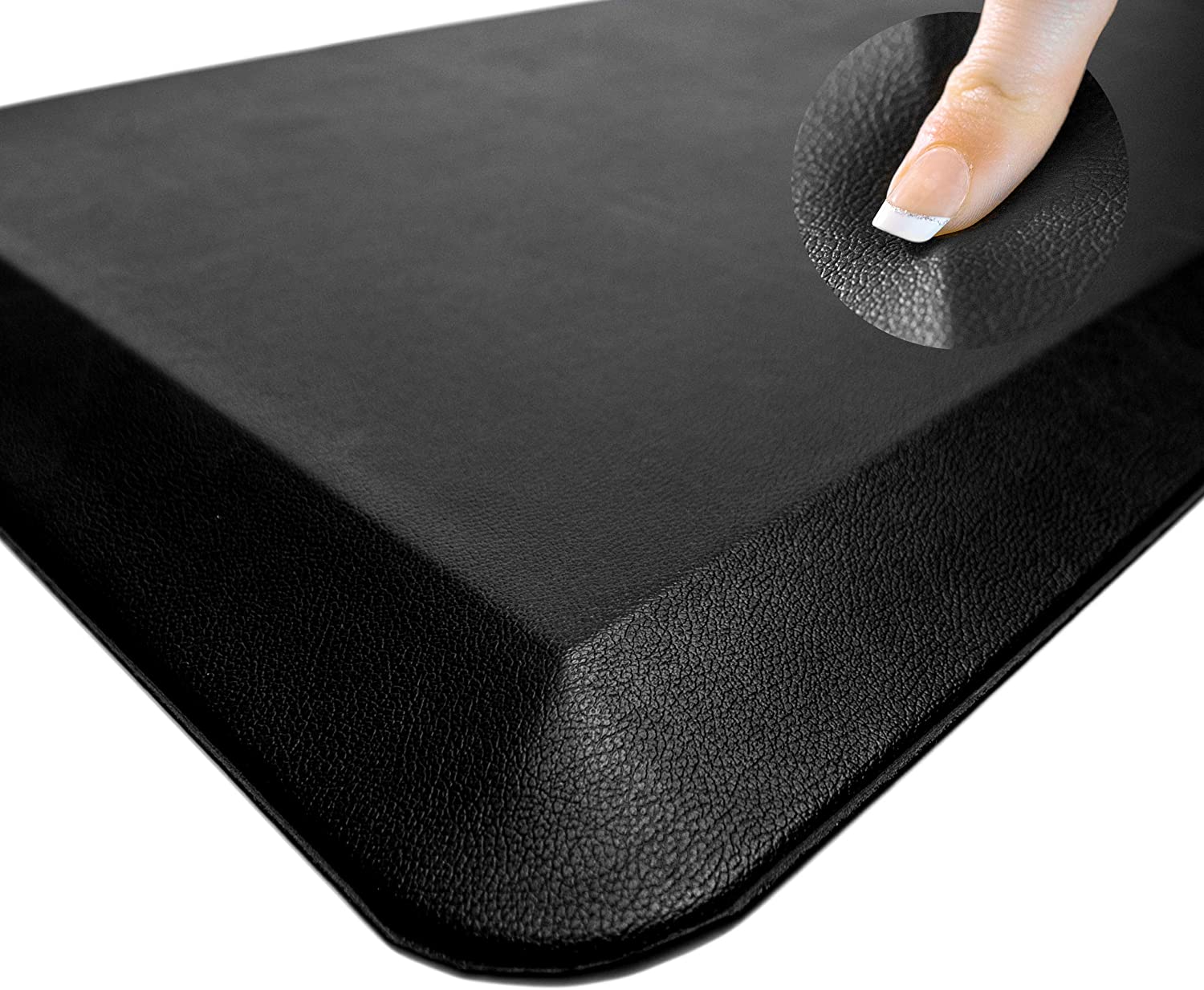

Here's the plot. The existing carpet is old, smelly and I don't care for the color. Therefore it's slotted to be replaced. If it's being replaced why not replace it with something superior to a carpet, if there's such a thing. That's when I ran across several molded vinyl floors. Vinyl, why not? Won't hold dirt, dust, lint and other undesirable stuff like a carpet would. Easy to clean and would probably outlast a traditional carpet. These were theoretical theories of course. I was hoping of something like those kitchen floor mats. The ones made from some type of rubber (or vinyl) with an anti-fatigue, semi-rigid gel/foam underneath. From my limited research it doesn't seem like vinyl floors are desirable in cars. However I figured I'd ask anyway.

Flooring like this is mostly for work trucks or base model cars in the long past. Why did they use it? Because it was cheap.
Fleets of trucks did use it to hose out but I would not recommend that for the Fiero as the electronics are more open and abundant. You could much damage. Also the pan will rot much like the trucks.
In work trucks they often had limited lives.
The other issue is should you ever need to sell the car the at would turn about 99% of most buyers off. There is little appeal outside Jeep owners or guys off roading trucks.
Unless you have massive issue with mud for some reason I would recommend skipping this idea. But it is your car and you can do as you please.
