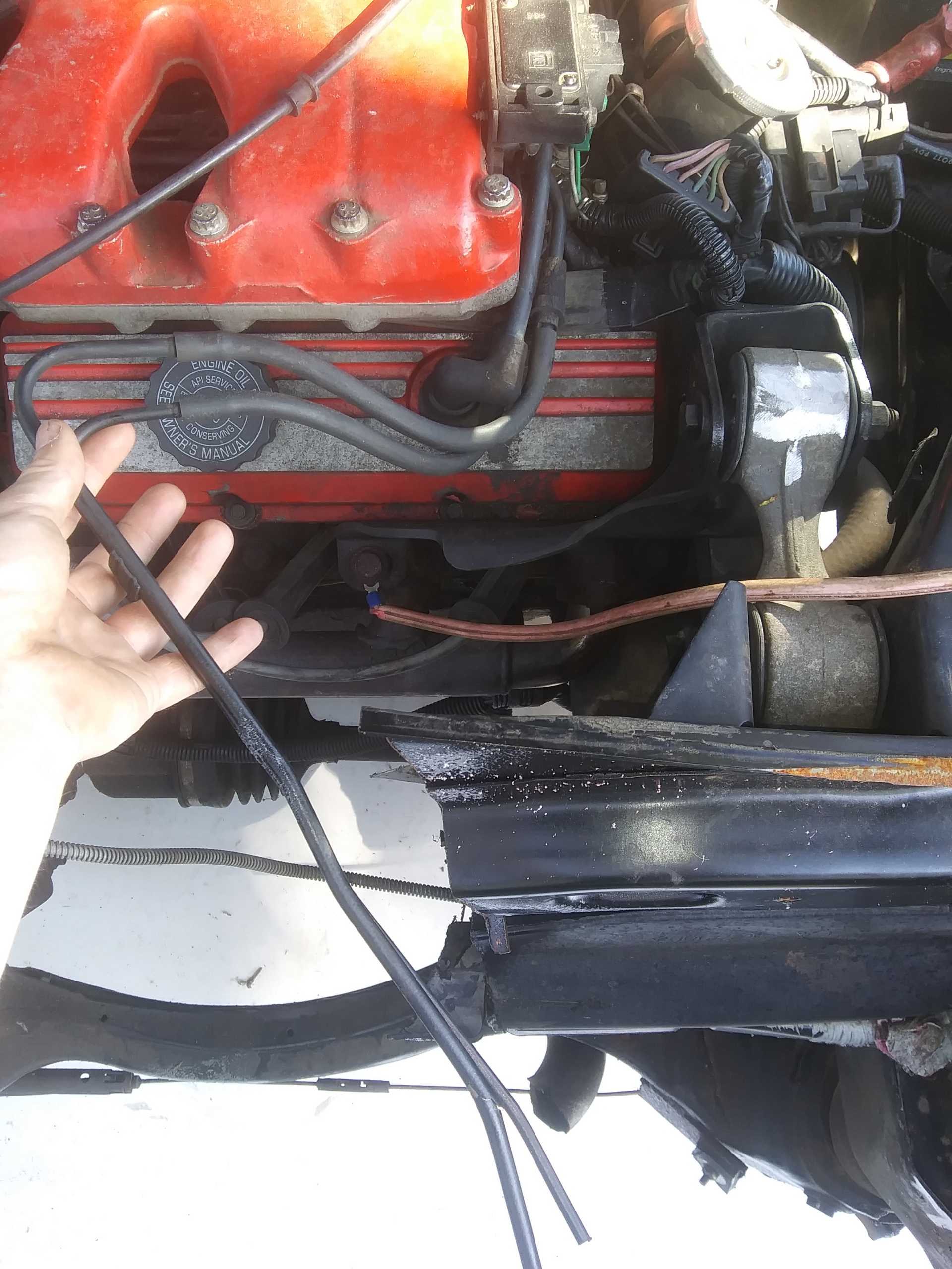

Can someone please tell me what these are? They've been cut and they look important.

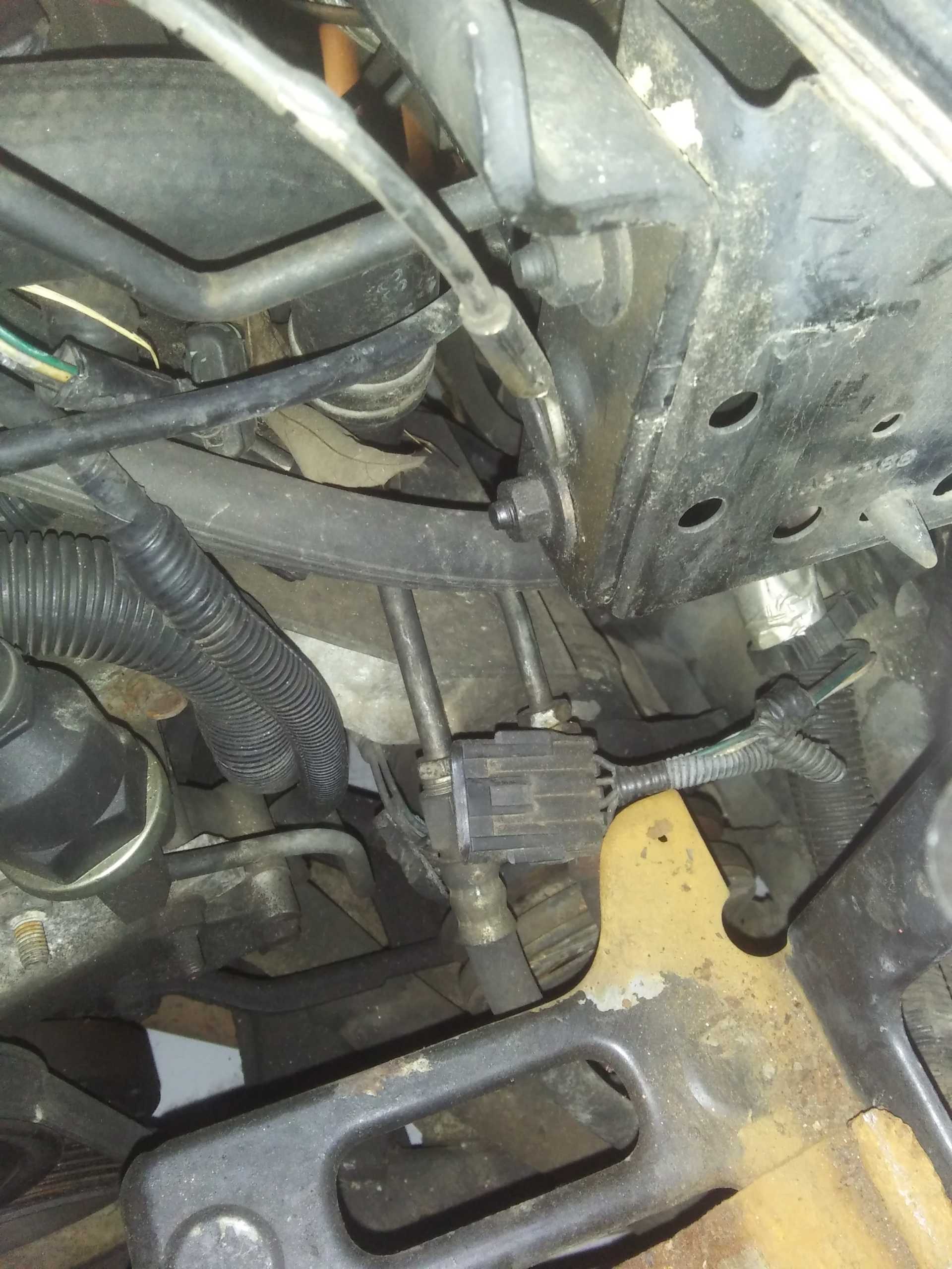

Also, what is this 4-inline connector by the stock battery mount supposed to go to? I don't see a place for it to plug in.

Important egr vacuum lines and deck lid harness plug. [This message has been edited by skywurz (edited 02-27-2021).]

plug to deck lid and was "tied" to inside of hinge frame. Deck lid has/had 3 or 4 wires. 3 to switch on latch, 1 to Power Lid Solenoid if car have that option.------------------ Dr. Ian Malcolm: Yeah, but your scientists were so preoccupied with whether or not they could, they didn't stop to think if they should. (Jurassic Park)

Okay uh I don't think those are the EGR lines because there are already lines running from the EGR to the solenoid and vacuum sensor... These seem to have a lot more length than needed to reach those parts as well.
I mean they might be part of that system but where are they supposed to run into?[This message has been edited by DangerZone (edited 02-28-2021).]

I missed that your trunk wall was missing. Maybe they are the charcoal/cruise control vacuum lines? They would have tun along the wall that's missing. However i swear i see them hooked to the egr solenoid. I have seen another trunk delete before. Make sure you get that reinforced.

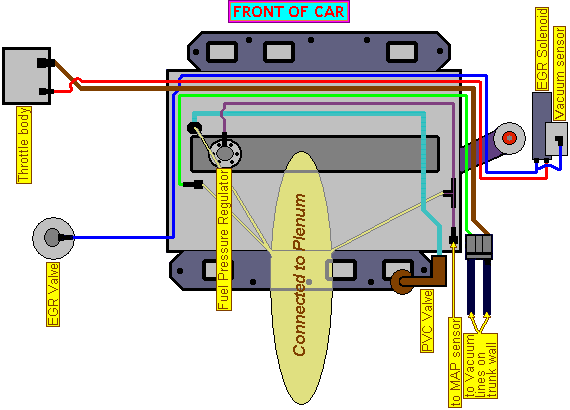

When they cut out that section of rear firewall, they cut right through those hoses since that's where they route. They mount to the rear firewall and head towards the driver side of the car. They probaby went to the evap canister. Here is a colored diagram of all the lines from BuddyCraig:
