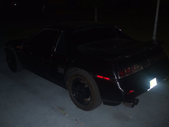

Hello all,
My name is Alex and I live in Milwaukee, WI. I have owned two Fieros; a 1984 Pontiac Fiero SE 2.5L and a 1988 Pontiac Fiero Formula 2.8L. These two cars were my first cars when I was 15 years old. I am now 27 years old and I am finding myself remembering the good times I had with these cars. I sold the 1984 Fiero but my father has kept the 1988 Fiero in running condition down in Florida. I am having the 1988 Fiero shipped up to Wisconsin in May 2021 and I will begin planning a full restoration/build for it. I am planning on throwing about $15k-$20k into this restore/build. I would really appreciate guidance from those who have already gone through a full restore/full build. I am wanting to turn this Fiero into one of the most capable driving machines in Wisconsin. Please see pictures below. I will continue to update this thread as I have new information. Any/all guidance is welcome. Thank you guys.
