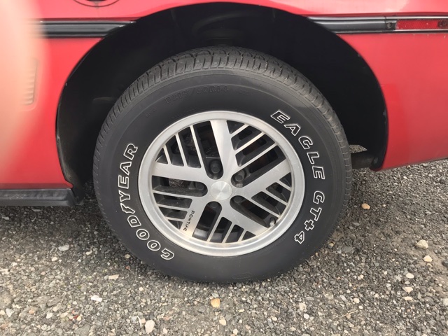

Know of a good place to pick up a set of tires that would fit an ‘84?

14 inches...
These have dry rot...

Did you finally buy another Fiero or just doing research?
Those tires appear to be from the late 80's/early 90's. 14" tire selection at the moment is garbage, closest thing to decent (unless you drive in wet or snow) are the BF Goodrich Radial T/A's which are available in the original 215/60R14 size
