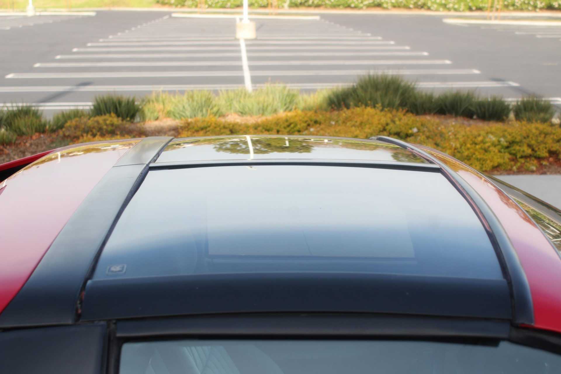

SInce ALL fiero T tops leak; does anyone make a small, easy on cover for the roof top only for fieros? sources? thanks MIke
dremu
JAN 17, 02:34 PM
Not sure what you mean. You're wanting something to go in place of the glass insert? The leak(s) would likely come from the body side weather stripping, as there's much more of that than on the glass insert. I don't know that something instead of the glass would fare any better.
Proper window adjustment will help, as will adjusting the rods on the glass insert.
-- A
